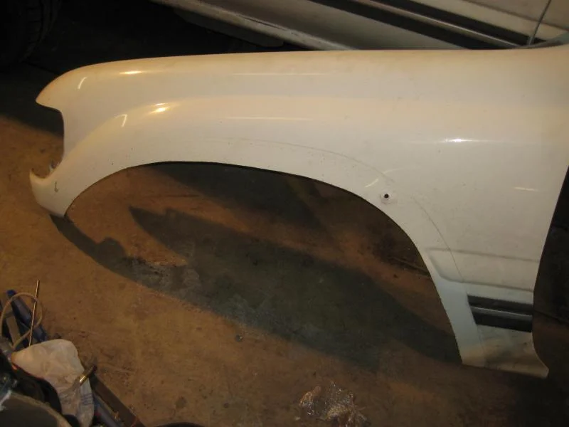

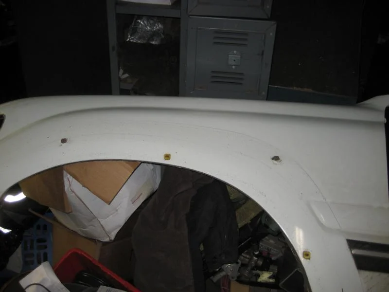

First we took the fender off that we were gonna draw the cutting pattern on. We had already taken the fender flares off, which you will need to do.

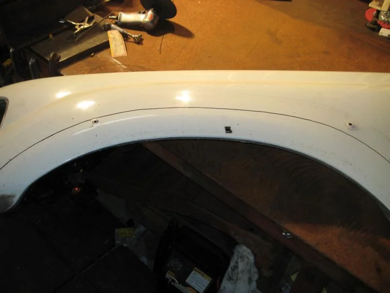

Next, I decided the line that I wanted to cut. I used a pencil and did it by free hand. It turned out pretty well. I just took my thumb and led it along the edge of the fender well and made a 3 inch line all the way around. I realized that this was not going to give me enough space where I needed it most....
....so I extended the line at the top so it reached 4 inches. This meant it doesn't have the same curve as stock but as the truck goes higher, the front axle is pushed farther back and this will give it the space where is it needed.

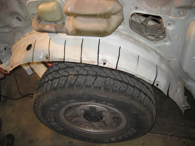

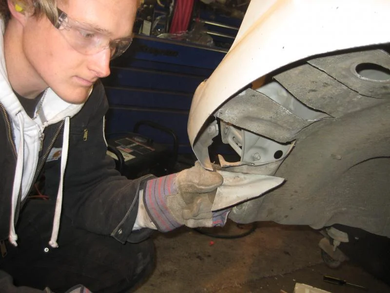

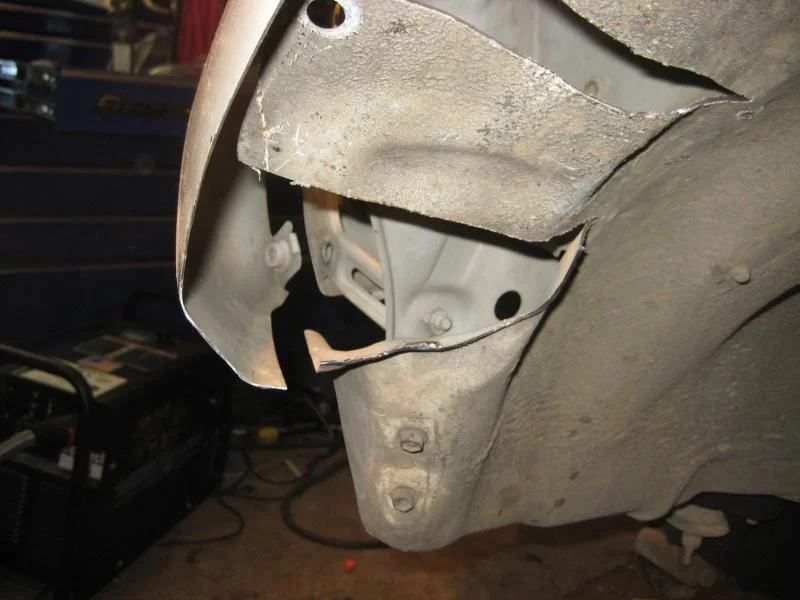

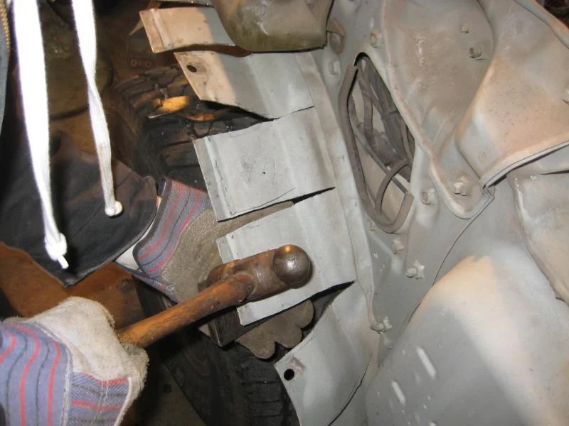

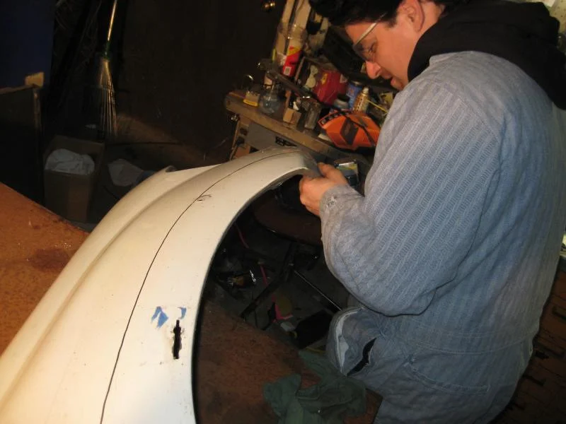

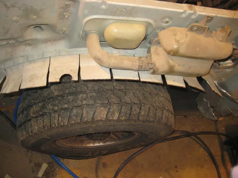

The first photo is showing Dave using a nibbler to cut the lines I have drawn. The next one shows the lines I had originally cut on my inner fender well. My thoughts were to bend the tabs from the fender well up and put pieces in between them and weld it up.

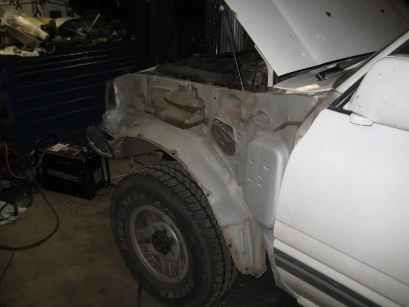

I cut the amount I need to off of each tab to make it fit the new fender. This took a bit of time because I to put the fender on and take it off each time to ensure a tight fit.

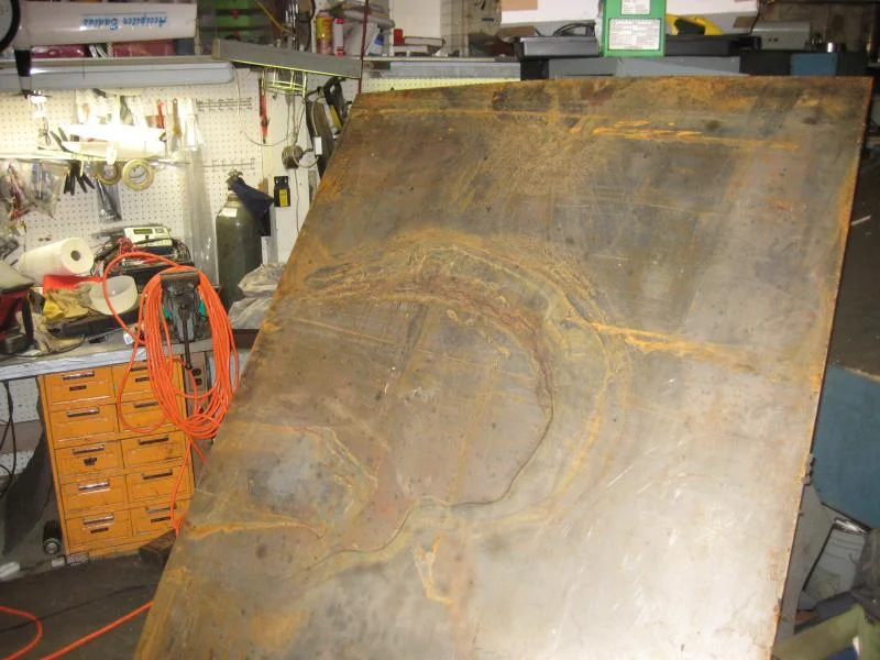

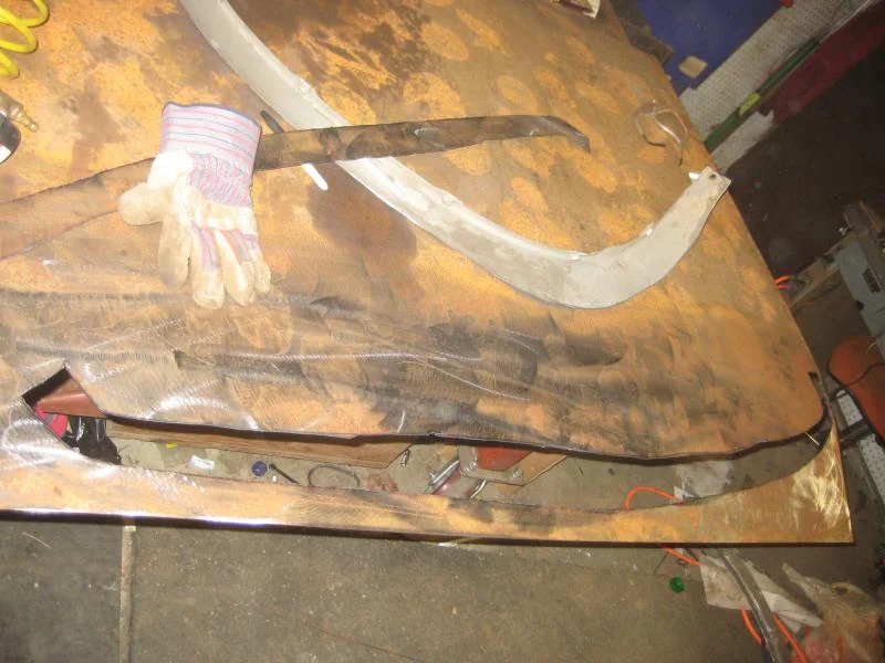

Then I decided I wanted to cut out a section of steel to make a new inner well all together. So I got out my 6X4 foot section of 1/16 mild steel sheet....doesn't everyone have one of those lying around?

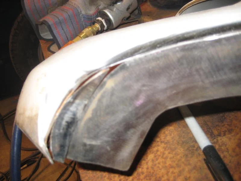

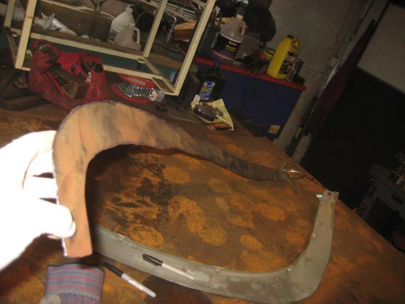

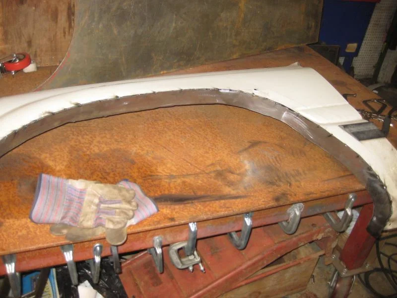

But before I made the inner wells, I needed to reinforce the edge of the fender so I cut out a 3 inch strip to fit it. I used the excess piece I cut off the fender to get the pattern from, put duct tape along the edge and drew the line. I then placed the pattern on the steel sheet and plasma cut the piece. Then TIG tacked it on.
Now be careful when cutting your inner fender well tabs because I sliced the washer fluid bladder and dumped fluid everywhere. :doh: Finished TIG welding the rest of the fender edge and then made the inner fender well. I don't have any photos of the piece I cut out but all you need to do is use the same line from the fender cut out and then spread it out about 6 inches in width. Cut it out and tack weld is to the edge you've cut out on the fender well. We MIG welded the rest, but it could be TIG welded with some more effort.

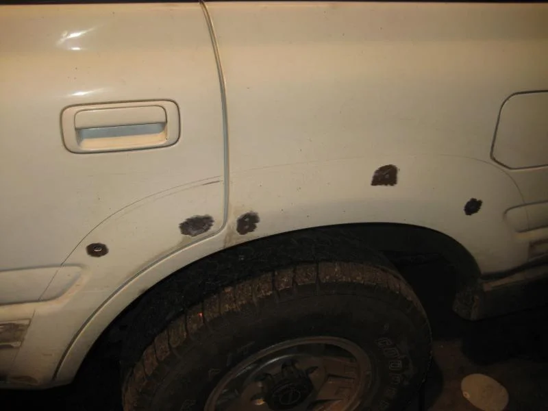

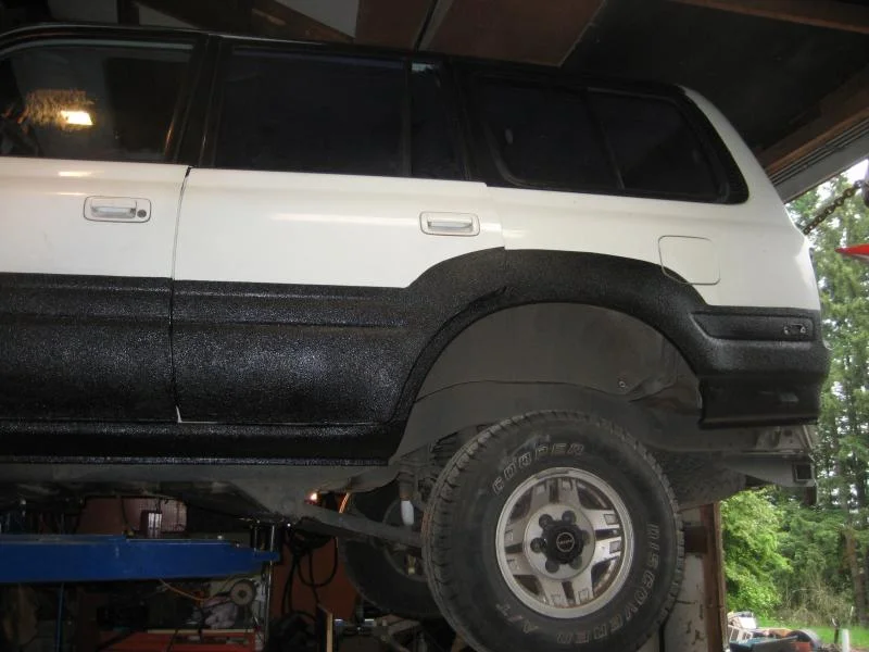

I also took the opportunity to TIG up holes around the cruiser I would be rhinolining.

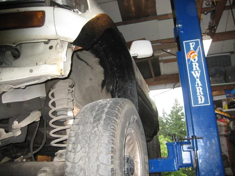

These are the lines I choose for my rhinolining. I kept it pretty high on the sides because I wheel with a lot of brush and they scratch up paint pretty well.
