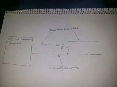

This is the way to be able to engage the rear locker in both HI/LO:
https://forum.ih8mud.com/100-series-cruisers/49181-rear-locker-mod.html
https://forum.ih8mud.com/100-series-cruisers/75494-98-99-rear-diff-lock-high-range.html
