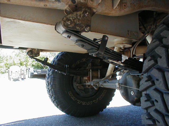

I may have contributed to the confusion as well. In my case the springs are too long and "push" the shackle away from the axle to the point the "anti-inversion" cross pin hits the spring. At that point the spring has a hard time contining to move through its range as it needs to get longer as it flattens out.
Here's a shot imediately after I installed the Alcans using my original "short" shackles. After a few miles they were actually riding on the anti-inversion pin. You'll notice at this point they have significant arch left but nowhere to move.
BTW, I thought this is what Grease was referring too as well.
Check out the height - with the original shackle as shown above. See why I'm not too thrilled about using using longer shackles? Sorry I don't have a pick of the longer shackles but you get the idea.
"Inverting" may be the wrong word but what was happening was the stock shackles (no anti-inversion) were not sitting vertically after the lift. Due to the increased length in the lift springs, everytime the spring compressed (over a bump or around a corner) the shackle would travel farther back (rear springs=back, front springs=forward) It would cause the shackles to move beyond a certain point and the shackles would automatically go up toward the frame. the shackles would remain in this position against the frame banging if I hit a bump. Sorry no pics. It was like having hydraulics if you will. You could hear and feel the shackles hit the frame and then you notice the rear, the front, or one side sit 4" lower. Instant low rider but no switches.

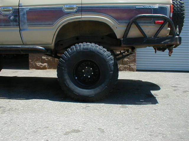

Back on topic, you can see my new Alcan's flexing with my expensive MAF (4plus) shackles... I wonder it my old springs would have kept that tire on the ground?
