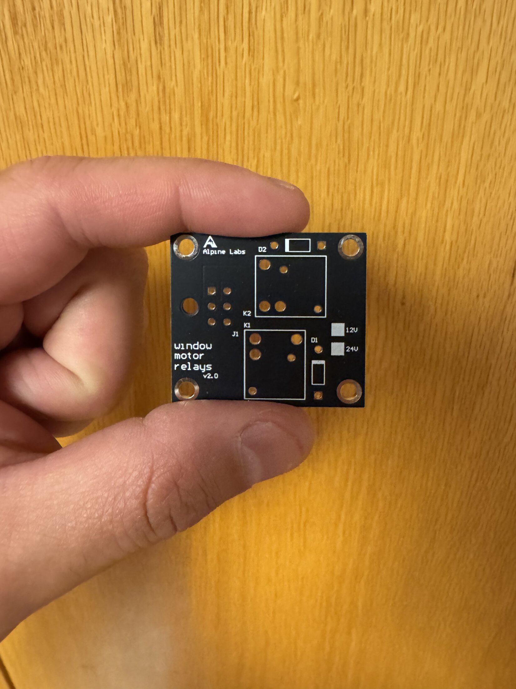

Fast window mod - motor relays on a PCB!

PCBs arrived today. Waiting on some parts. The total board size is about the same area as a single one of the relays that's flopping around loose in my passenger door.
This is not the final design that I will provide to other folks - I am going to double up on the amount of copper (doing a redundant trace on top & bottom for the current carrying traces) even though there's plenty of copper already. But this will allow me to test basic functionality.
The final design will be the same size.

Osh Park?

2oz copper layers? ENEPIG? Looks nice
