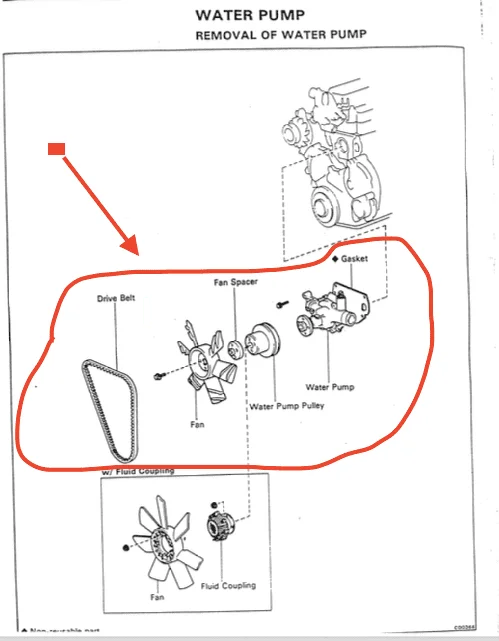

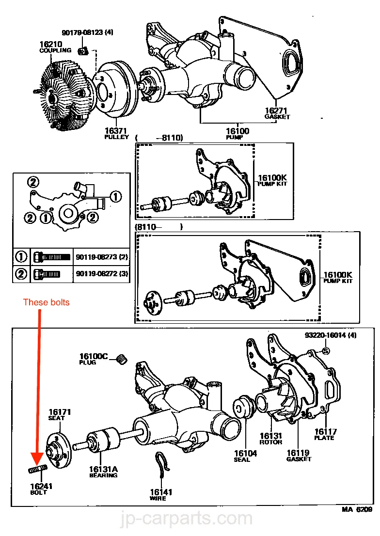

Can I add a fan clutch to my BJ42 (84) which has the standard non clutch type fan. I have the new fan (clutch type). Do I need a new water pump for clutch or just the four bolts shown in FSM.
Is it best to replace the water pump in any case while I am at it?

Thank you, I will probably just fit a new pump with a clutch as the existing is looking a bit worse for wear in any case. Thanks again

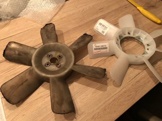

Hi Tomio, thank you for response. My 42 with the 3B came from Australia and it looks like factory job with spacer etc. The FSM, below, shows you can have it with or without fan clutch ? It may have had a clutch at one stage, don't know. The reason I want to add a clutch is that I am having great difficulty sourcing a replacement fan (4 bolt version) for the non clutch version. I have a new clutch fan type and was just going to add clutch and new water pump. The existing pump has been in there from new, I believe, so its probably time to change it in any case?

yes , the fsm show two 2 style of fan ... (i love ih8mud i never stop to learn !!!)
since your pump is old if you can change it and add a fan-clucth
change the t-stat too
i think the fan clutch style is better for our climate and for deep river crossing too
