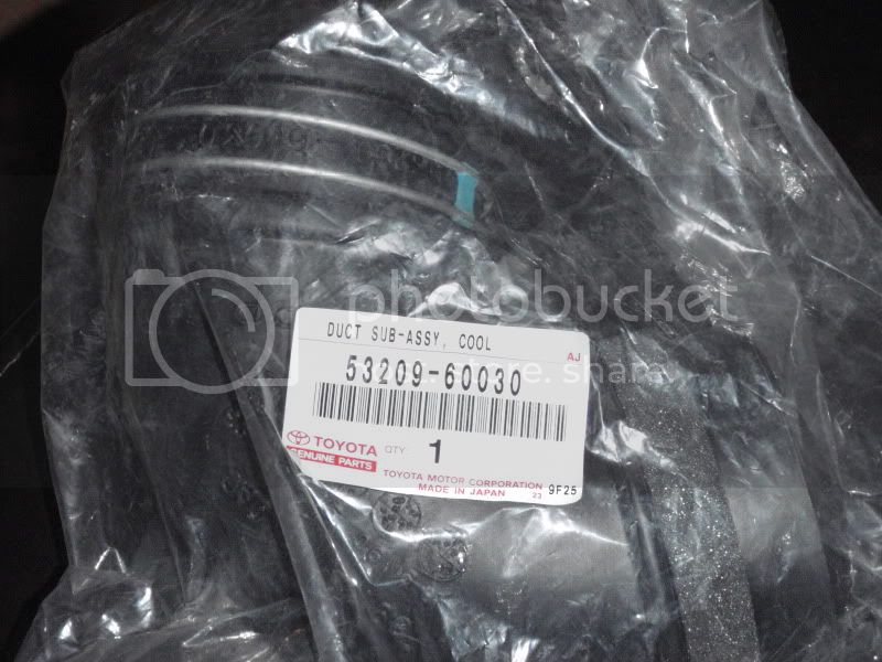

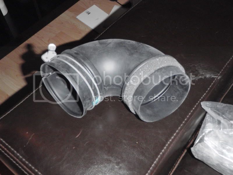

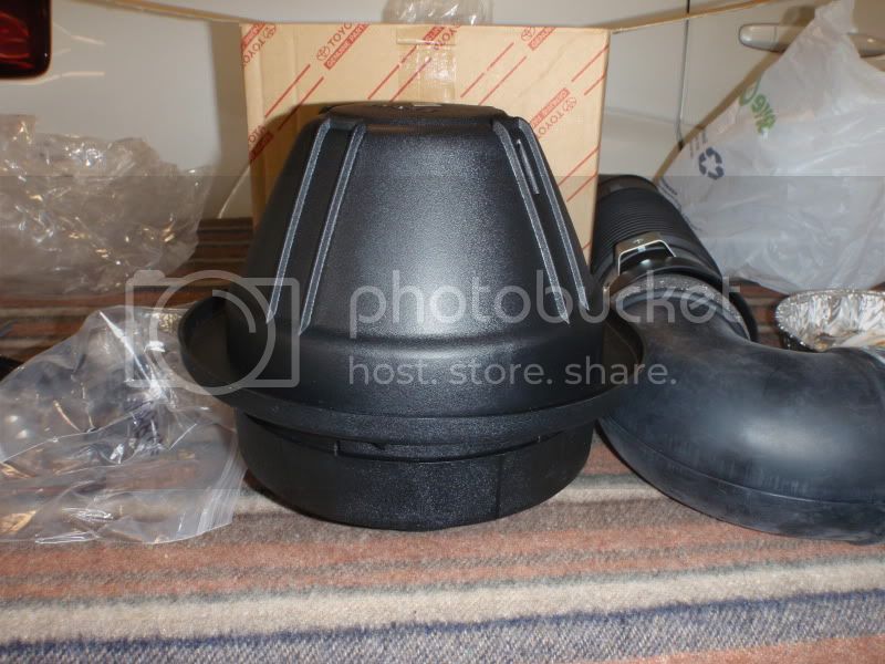

So here are the parts themselves

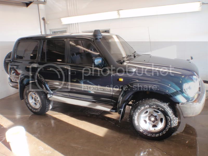

Here is our 80 before we start ..

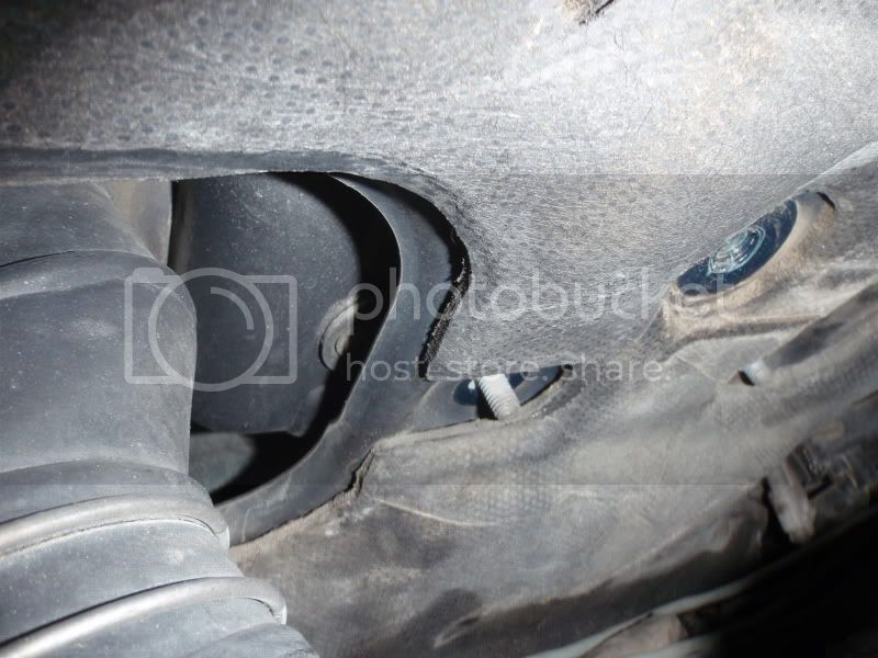

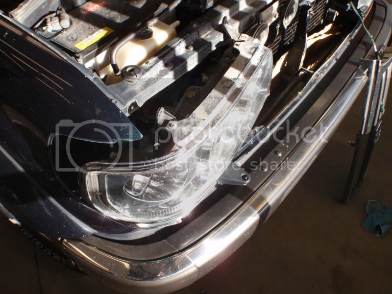

To get out the factory intake out of the fender, remove the headlight. then you can access is very easily. there are 3 nets that hold it all in there. Unbolt the cruise control unit and push it out of the way. there are 2 under that. the other is near the battery. it is located behind a small box called a 'power outlet' ..i just pushed the bracket down and accessed that way. all are 10mm.
Once you have that out, install the part with the cutout, and then the elbow that connects to the airbox. I removed the 3 bolts that hold the airbox down so that you can move it around a bit. this helps with the install of the elbow.
Now the bracket for the top of the neck and the precleaner. after the neck is attached to the truck, We marked where the holder was going to go. then simply riveted it in there. bolt up the rest of the truck that you took apart and your done!!:bounce:

yes.. it is from the leading edge of the cowl.. use the pic above of where it is in relation to the hood line. You can get a good idea from that of where the template will sit. I dont have the template anmore but from what I remember .. the cowl line should match up perfect. always check twice and cut once!!
