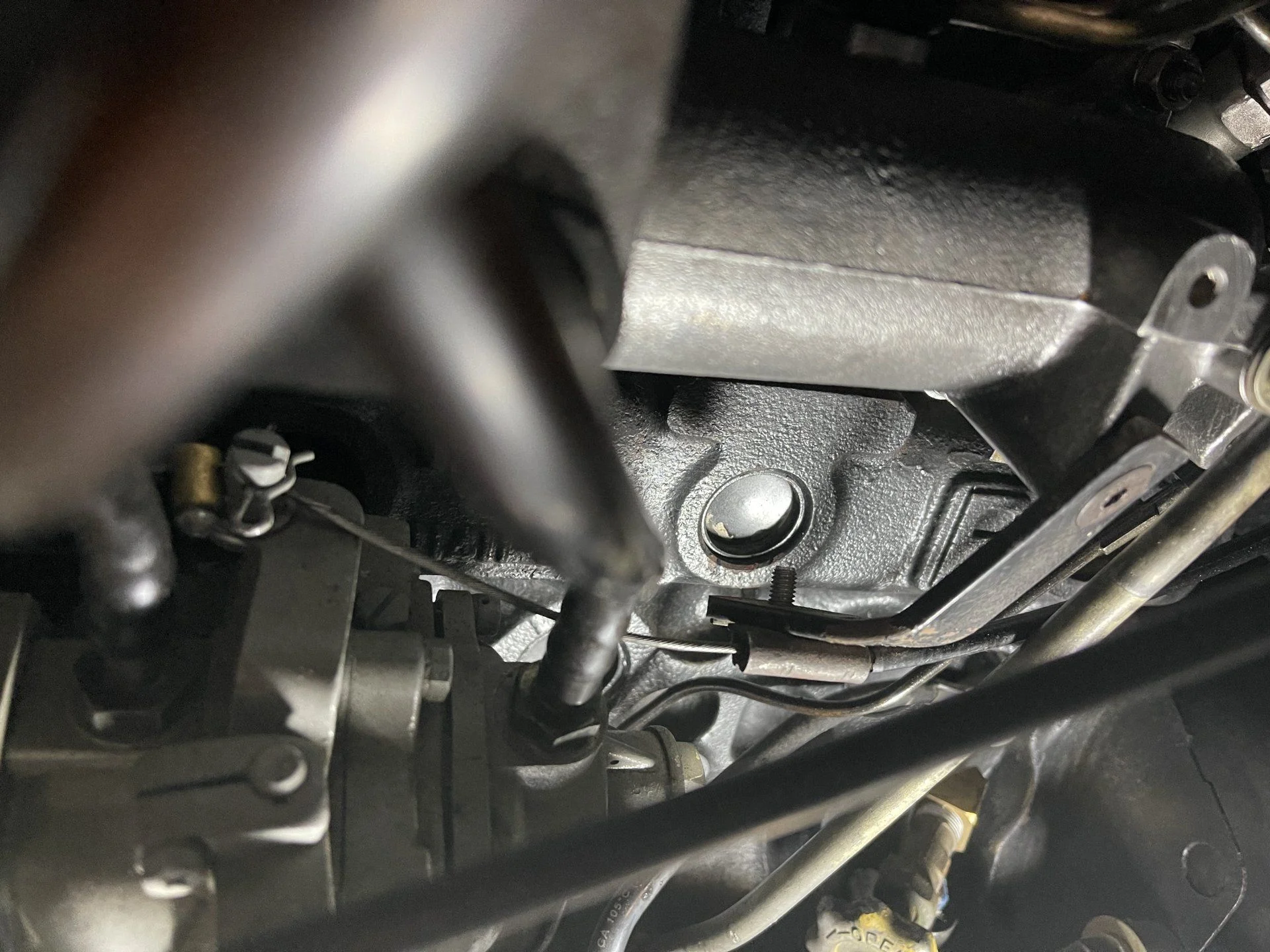

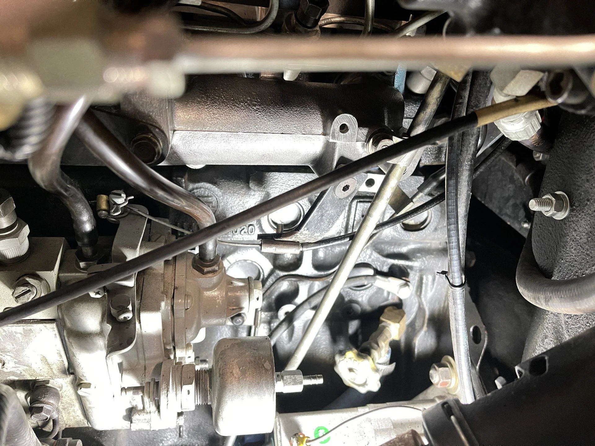

I have a few images here, maybe of use.. 2H... but BJ40 is same-same tech.
Many thanks. This has given me a few ideas about how to tackle my set up. I believe I need to order a PTO stop cable as the one I attempted to hook up had too much flew in the run of the cable. A beefier cable will allow me to have the correct cable tension to throw the throttle stop to the off position.
