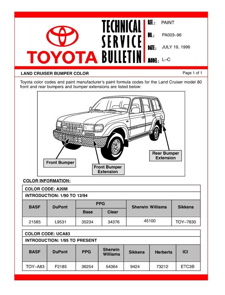

does anyone know where I can find some touch-up paint or anything close to the factory gray bumper paint
Which year?
