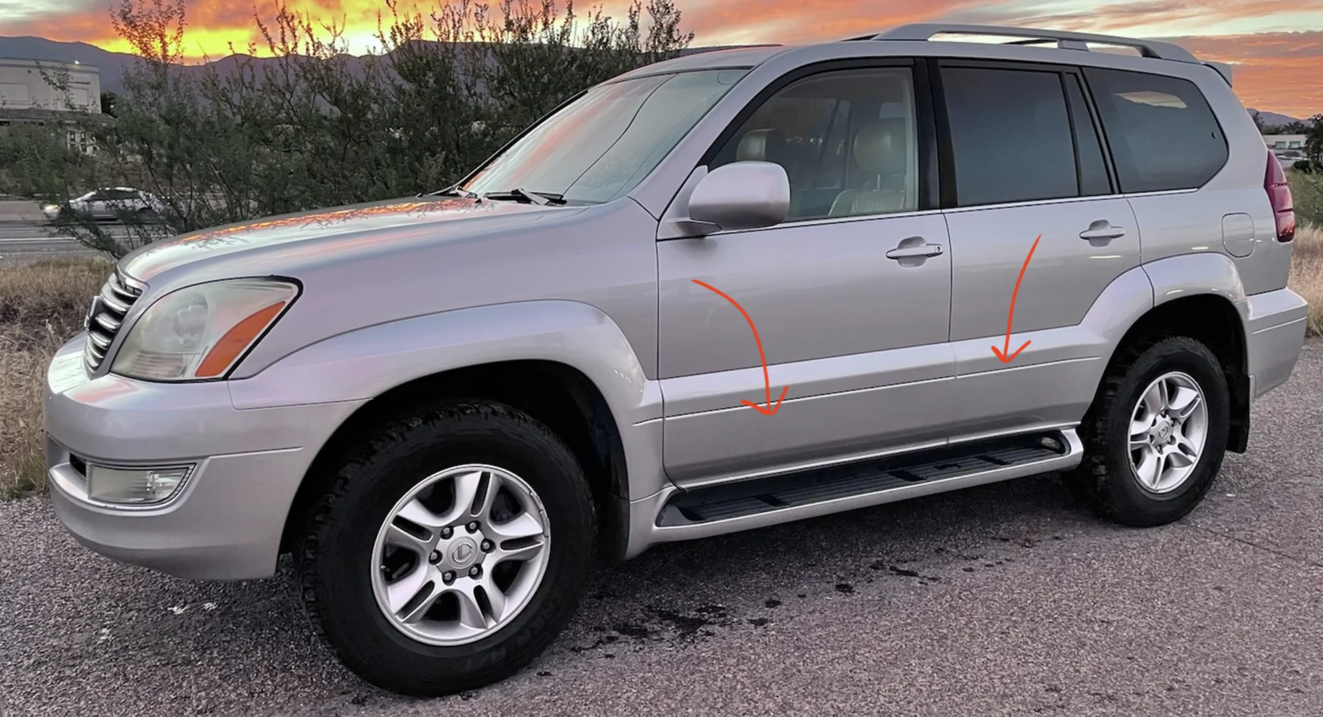

I've searched and searched without making any headway. One of the exterior door trim panels on my GX470 is loose. I think there is a combination of double sided tape and clips that hold the panel onto the door. Before I rip off the panel to replace the old tape, I would like to have some extra clips on hand.
Do you know the part number for those clips?

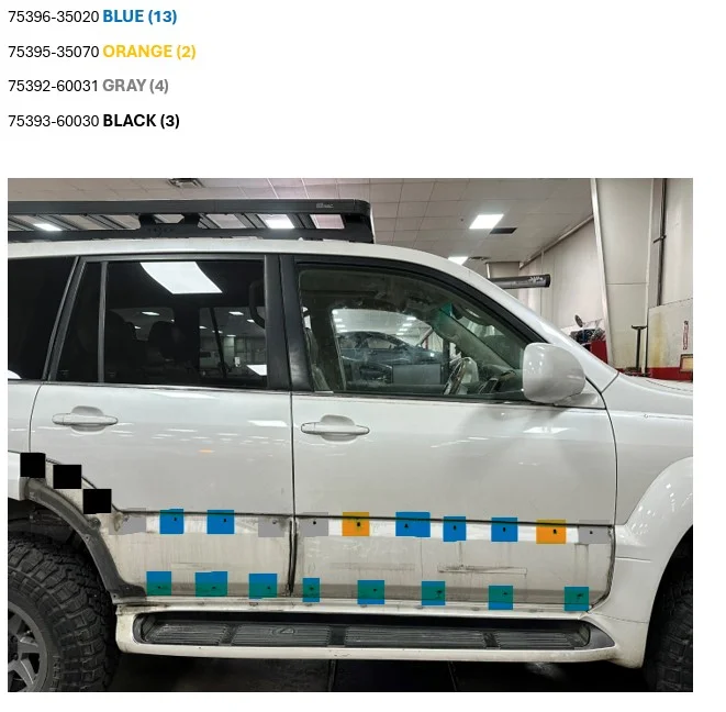

I had to do the same thing. Be mindful that my research found that the quantity and item numbers are not the same from a 4Runner of the same year. I was recommended to use some double-sided tape as well as the clips to resecure the body cladding on. I didn't take notes so I cannot tell if my quantity if exact or if I was left with a spare or too ( i think i had spares).
75396-35020 - 8 qty
75392-60031 - 2 qty
75395-35070 - 2 qty.
These were the items for the driver door, so I cannot confirm they work for the rear passenger door as well. I recommend calling a Lexus dealer to get the items in detail. If you have one you prefer and have a repore with, they sometimes can even send you the diagrams to show which clips go where.

That is extremely helpful—thank you! I'm working with a front passenger door so I would expect the clips to be the same. I'll update this thread once I've done the work.

I ordered something similar, but it was these (based on the part numbers @elprup87 listed): AUTOKAY New 100x Orange & Blue Clips for 4Runner Tacoma Trim Moulding 75395-35070 75396-35020 Amazon product ASIN B07M8BMD1Y

Yes. Remove interior panel and you can access the back of the clips. Use some pliers to squeeze them and push them through. The attachment with part #'s worked great to locate the right clips... and I believe I found all of them on Amazon.
