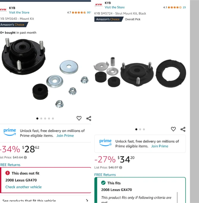

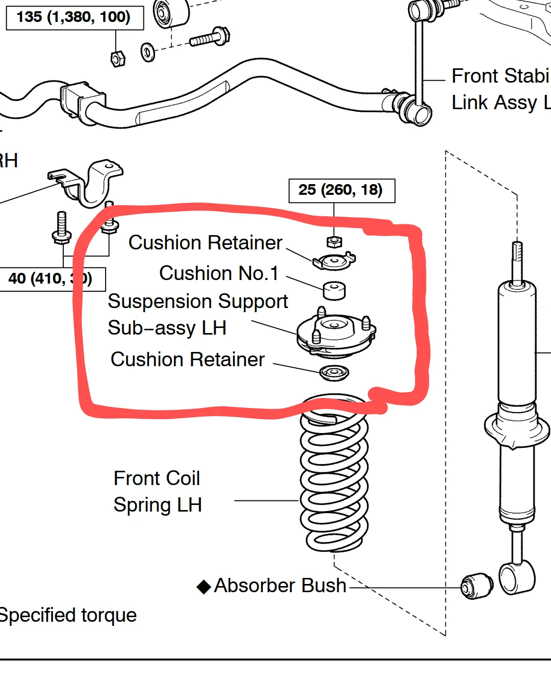

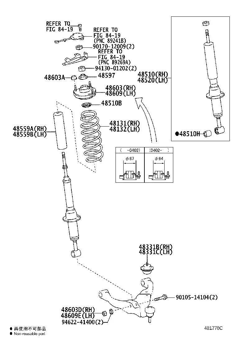

TLDR edit, KYB makes a high quality kit "SM5724" that has all this hardware i circled in red.
Looking to replace $hock$ and want to make sure i get all the right stuff together. Going to call lexus and give VIN to get spring #s tor my specific setup but does anyone have the part numbers for all this hardware?
I see many use/talk about the KYB SM5640 for a strut mount kit. Maybe for 4Runner, but compatible. Anyone use the SM5640?
They are different shapes and have different hardware. Maybe it can be used for a modified setup. But KYB is saying they dont fit a stock setup on amazon.

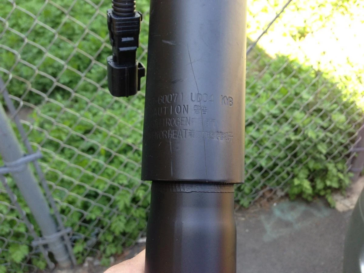

Tokico are OEM line and service replacement part for these trucks….which is owned by Hitachi conglomerate.
I know my 80 Shocks are Made by Tokico but the GX may be Made by KYB and they have the Electric Dampeners.
My 05 GX is getting the Bilsteins and KYB Bearings Soon.
Bilstein Shock Conversion
I got schooled today. The gx470 uses what lexus calls its (AVS) shocks. They are in fact magna ride, not 4 way adjust. Kinda neat.

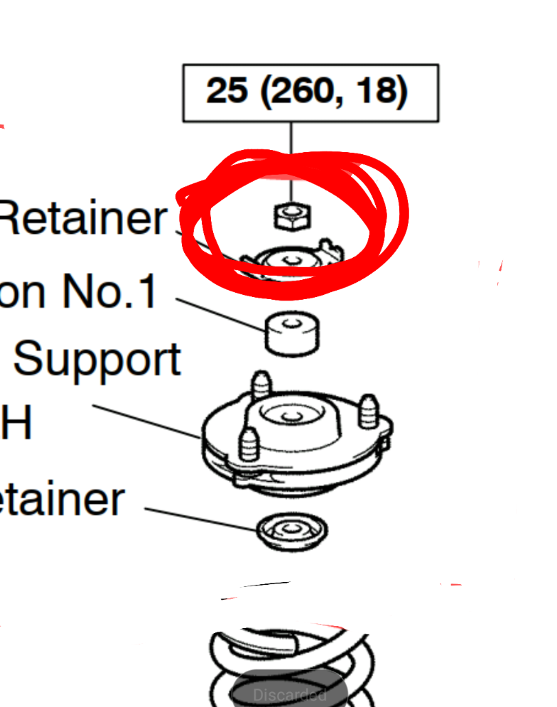

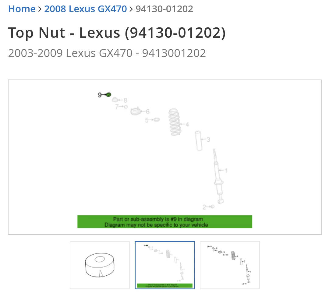

Bumping this. The KYB kit and the lexus front shock did not come with the nut that clamps the whole thing together. In a effort to order the right part does anyone wknow what the part numbers are for deez nuts?
The link has all the diagrams, you need to actually look at it and learn how to use a basic Lexus parts site. They all have the same diagrams and it is easy once you get used to it.
Or you can keep asking here and whining when people nicely do (the incredibly simple) searching for you.
Bumping this. The KYB kit and the lexus front shock did not come with the nut that clamps the whole thing together. In a effort to order the right part does anyone wknow what the part numbers are for deez nuts?View attachment 3771824

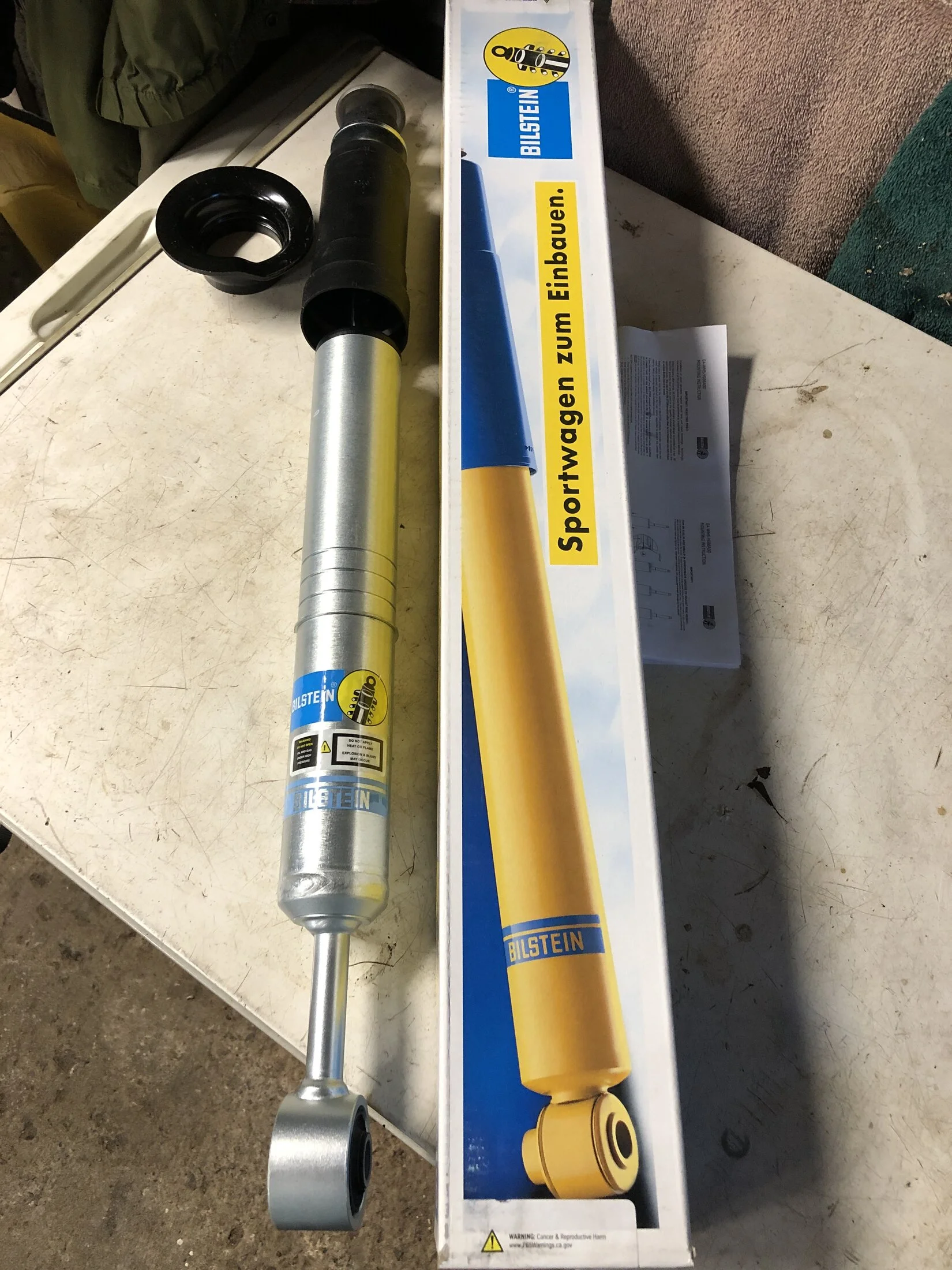

The Bilstein Shocks include the Nut.
If you want to Keep the electrical System then you would likely want to keep the Rears as well along with the Airbags.
I did away with it all in the name of Simplicity and Pulled the Fuse so No Light on Dash.
Loving the Bilsteins, Springs, and Air LIft Bags ($115 Amazon). Towing will not Cause Squat and Adjustable by Varying Air Pressure.

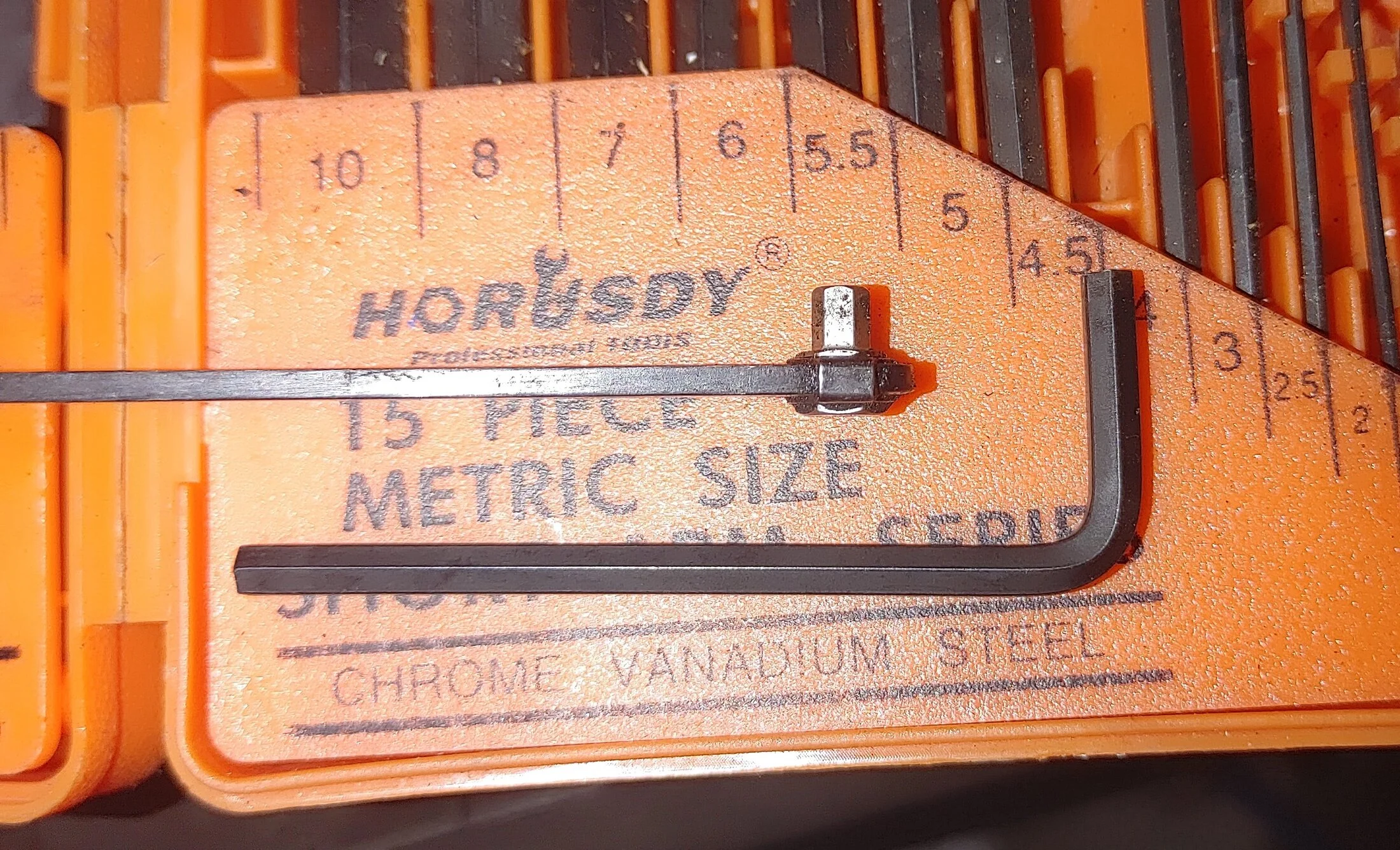

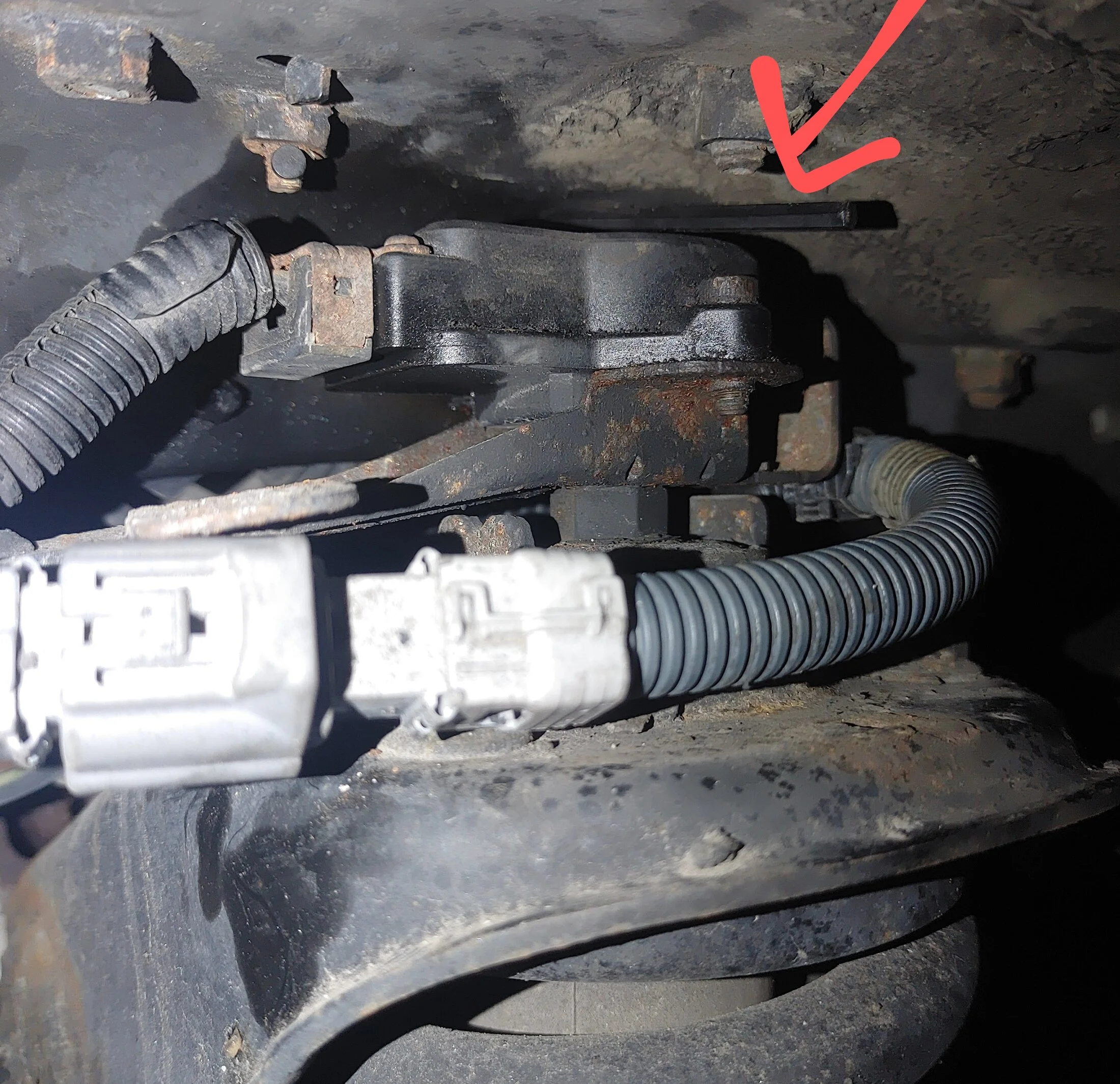

Rainy today but went out to see if i could get those 4mm allen hex screws that hold the actuators in place. Thought I was bringing a secret weapon, these ultra skinny allen wrenches.
Turns out they were actually TOO shallow and I couldnt get the bit to reach the bolt. Ended up using a dictionary definition "standard" 4mm allen wrench and it fit and worked like a charm with the perfect amount of clearance.
All 4 botls are un-stuck and turning easily. Excited to be replacing the front shocks in the next few days.
