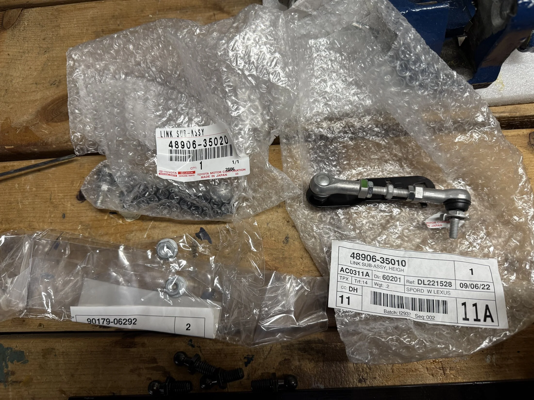

iid like to reppace the ride height sensor links while im under the car does nay9ne know a good place to get these?
I have a brand new pair from Bell Lexus sitting in my basement. Looks like they’re about $120 from Bell Lexus.
Part numbers 4890635010 and 4890635020 if you want to google other prices. Happy to sell them to you cheap, I have original packaging etc, bought them before I decided to lift the gx and never returned them.

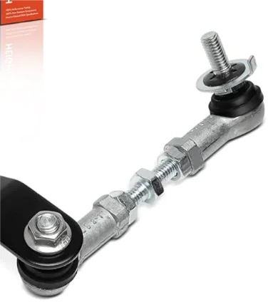

Joint Ends are made by THK and Motion Industries Carries them. If I recall about $15 each
Careful One is Left Hand Thread other is Right Hand Thread - I was not Careful
Then you Need the Adjuster but you can likely Reuse your Existing.
I redid the ones on my RX and another Lexus Model (IS) was Nearly Identical so bought used one on Ebay and Pieced it together.
