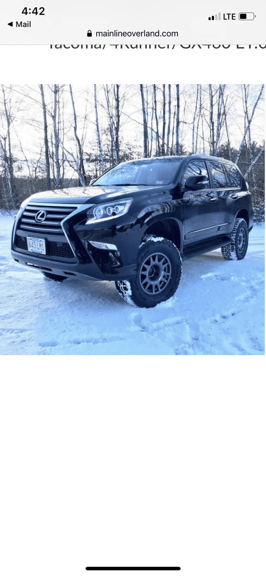

I like this look

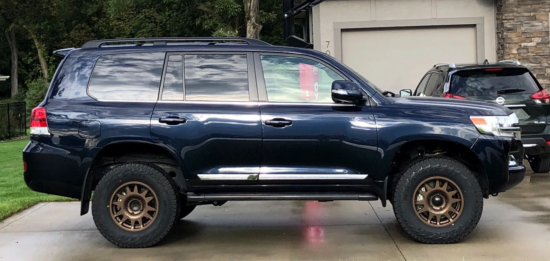

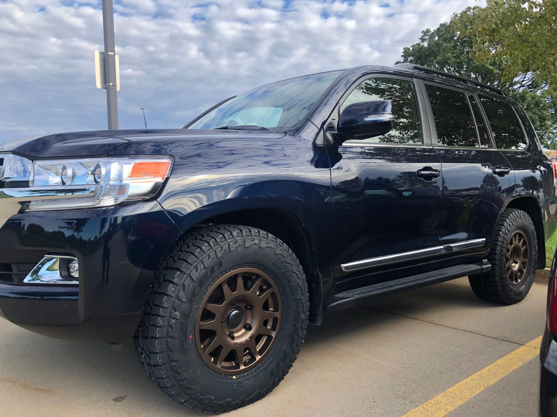

I run the 40 offset 17". I had to remove my front-of-tire mud flap and get a teensy bit of rub in full lock in reverse with the plastic liner at the front of the driver's side wheel well. It's dissipated as the tire has worn a bit and not enough to bother me or cause an issue. I also have the Tough Dog suspension set up which give me nearly 2" of lift.
What size tire are you running ?

286/70/17 Same setup as philo but w. factory ACH. I would not want it further outboard for articulation.
