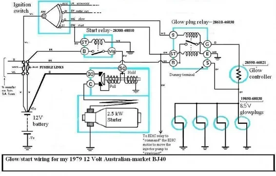

But for manual glow rigs, the plugs are engaged at a higher voltage than normal when starting - they get full battery voltage when cranking, while normally they get it dropped by a couple volts through the glow controller.
....they get full battery voltage when cranking, while normally they get it dropped by a couple volts through the glow controller.
If my memory serves me correctly - we 90%-established this to be the case with some 24V BJ4# cruisers (of around 1979 to 1982 vintage) Drew ..... but no owner of such a vehicle tested their glow relay to provide conclusive proof.
So this is what we BELIEVED their wiring to be (which conforms to your description):
But I know we established for sure that your cruiser and mine (which are both 12V and within the same manufacturing period as listed above) have a "dummy S terminal" on our glow relays that is connected to absolutely nothing inside.
Here is the confirmed glow/start wiring for my BJ40:
And I think yours is identical except for some different part numbers (glow controller & glow relay).
Note that the voltage to our plugs is still "stepped down" by our glow controllers when our keys are in "start".
:cheers:
Ohhh right, I remember now.
In any case, there are a lot of 3B's out there that do not reduce glow intensity while starting, and might even increase it.
