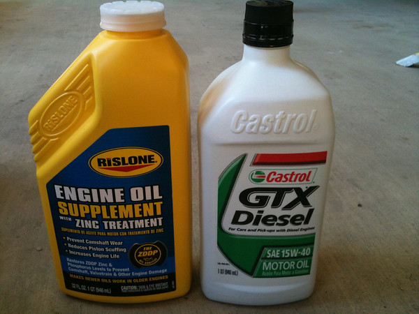

Well, here is what I did. I got some of the Castrol GTX Diesel after doing some research. Thanks for the recommendation on this one Spike Strip. Having seen all the folks who use Rotella T, I really leaned towards it but having read that these types of oils had reduced their levels of ZDDP because trucks are starting to run catalytic converters I shied away from it.
Now I see the information from Woodscustom and I'd wish I'd known that earlier.
I did buy some Rislone Engine Oil supplement. Someone suggested it in another thread and it seems to be something to consider.
So, one quart of Rislone and a little over 7 quarts of Castrol GTX Diesel.

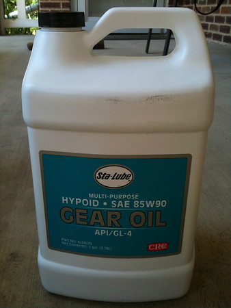

Then I got some Sta-Lube gear oil. I went to NAPA and had never seen the brand. Did a quick google on the iphone and the second hit was from a very well respected BMW motorcycle guru who suggested this in older BMW tranny's. It is the GL-4 rating so it will no go after bronze, etc. It was actually fairly expensive at $31.50 for a gallon.
