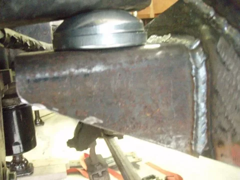

Check out these pics from motor mounts.
This are about 6 months and about 10k miles, mainly on washboard roads and hwys.
Transdapt motor mounts
What they looked liked when new...
After 6 months of washboard roads...
These are the motor mounts I got from Downey (back when they were in business) they were about 3 years old when I pulled them out..
The engine was pretty much sitting on top of the rubber mounts as these were not a bolt through mount..but more like isolators....
Tranny rubber mount.
Which makes yah want to build something stronger...
