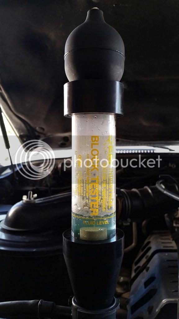

Napa has a cool little kit that ive used - its a blue fluid with a sintered bronze filter and a radiator adaptor, you attach it to your radiator and start your vehicle, if the fluid turns green or yellow (i dont remember), it means there is a presence of exhaust gases in your cooling system which means you have a blown head gasket. Might be worth checking out.
Autozone has the block tester in their tools loaning program.
Block tester is a good indicator. It can confirm a blown hg. But a negative test doesn't always rule it out. The test reads exhaust gases in the coolant which doesn't always happen with a hg failure.
From your description, my best guess is that you overheated it and warped the head. There's no way to confirm over the web. If that is the case, the block test will likely confirm it.
I wouldn't bother changing the oil until you've tested it. If the head has to come off , it'll have to be changed again.
OK so the oil looks fine, I filled the radiator back up and started it up and performed the test. This is what I got.
Looks kinda yellow to me :-/
