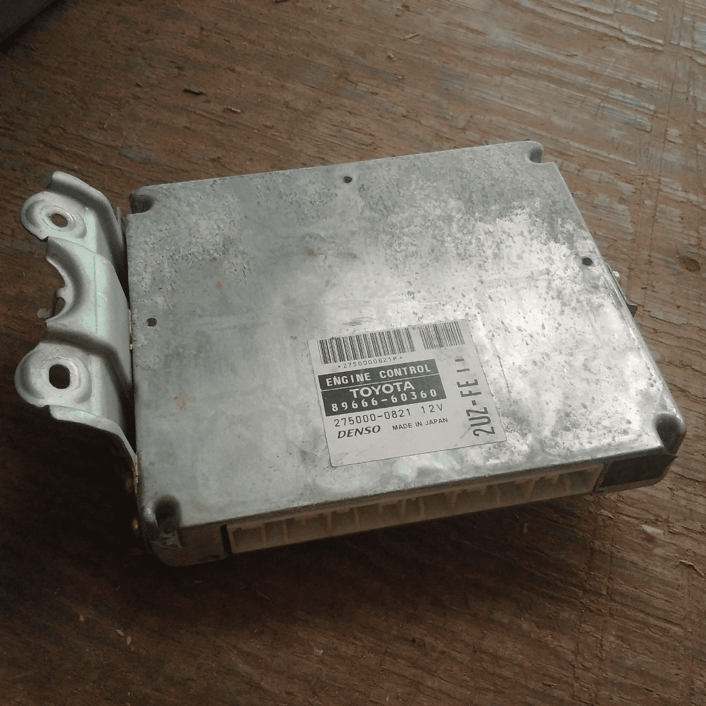

I am trying to get a few engine ECUs for different year Land Cruisers and LX 470s to virginize and keep on hand.
I am trying to have at least one computer box for years 1998-2002.
I have been watching ebay and have bought a couple for the 98.
I am seeing a few different part numbers for years 1999-2000 and 2001-2002.
What I am asking for is the year, make and part number of your ECU.
If you feel like looking I would really appreciate it.
My goal is to be able to offer replacement virginized ECUs at a reasonable price. Not trying to make any money, just make it a little less expensive for people to replace fried computers, or for those that only have a valet key.

When I was looking for my 2002 Land Cruiser, I found these compatible ECU ECM part numbers:
COMPUTER, ENGINE CONTROL
19000-50423
89661-60610
89666-60170
89666-60260
89666-60261
89666-60360
89666-6036084
89666-60710
89666-60711
89666-6071184

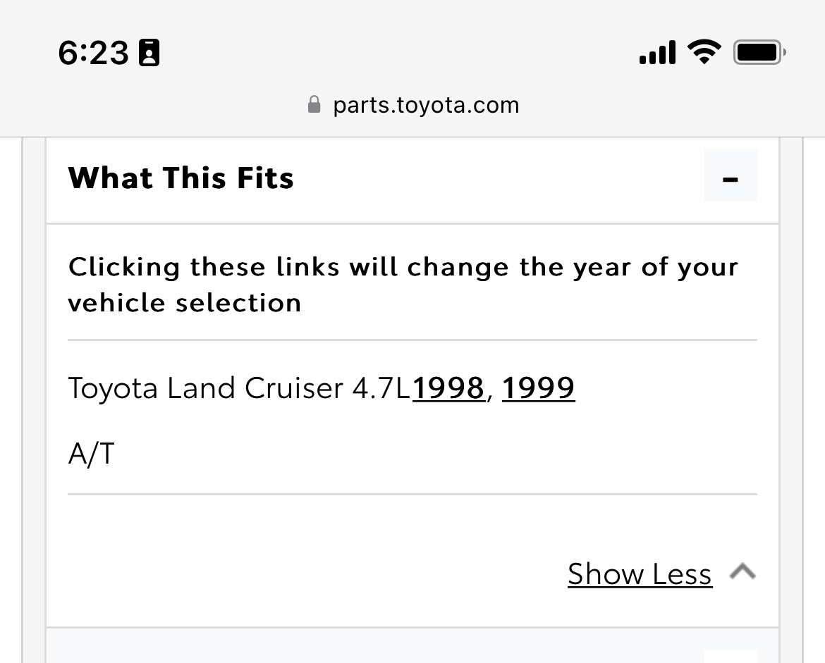

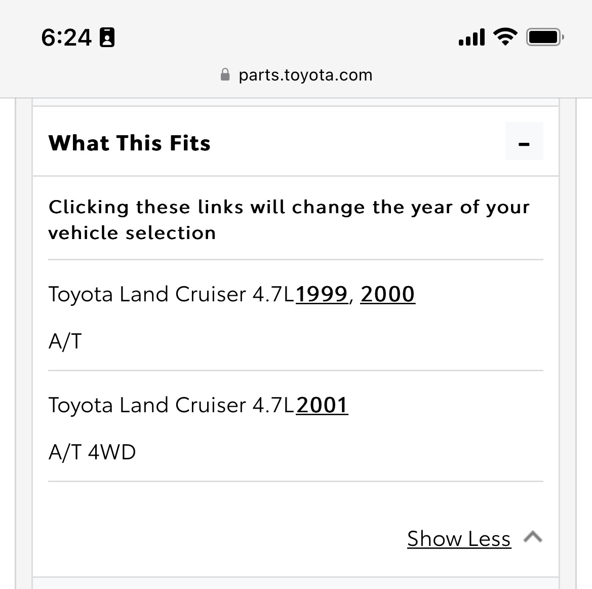

Early in our ownership of this vehicle, we picked up a spare ECU, from a 99 LX470 that was being parted out, to deal with the single valet key issue (w/o taking the vehicle out of service). When we swapped the ECU out, I was a bit puzzled at the ECU P/N difference, original = 89661-60610, "virginized" salvage = 89666-60170, but everything plugged up and seemed to work just fine.
On our July drive to Silverton Colorado, once we hit the mountains, we quickly figured out that the "OD off" was not working as expected. The switch and dash light worked as expected, but the transmission did not.
Wondering if it could be the ECU P/N difference, or if the salvage ECU might be a little less than perfect, I shipped the original ECU to @Mauser to get it "virginized". Once the original 89661-60610 ECU was re-installed the O/D is back to working as expected.
(Our 99 LX has a 10/98 date of manufacture)
@jLB you have to click "What this Fits", then it will tell you that 60170 was not compatible with year 1998:
89661-60610 (fits 1998-1999 production date)
89666-60170 (fits 1999-2001 production date)
The vehicle in question is a 1999 model year (10/98 production). Notice that 1999 appears in both of your “what it fits”. The purchase was made from a salvage vehicle as a “1999 LX470 ECU”, without a part number. Fortunately I do also have a 2000 LC, that uses the same (later production) part number ECU.

(I take it that you skipped past the attachments that I included above)
View attachment 3227079View attachment 3227081
