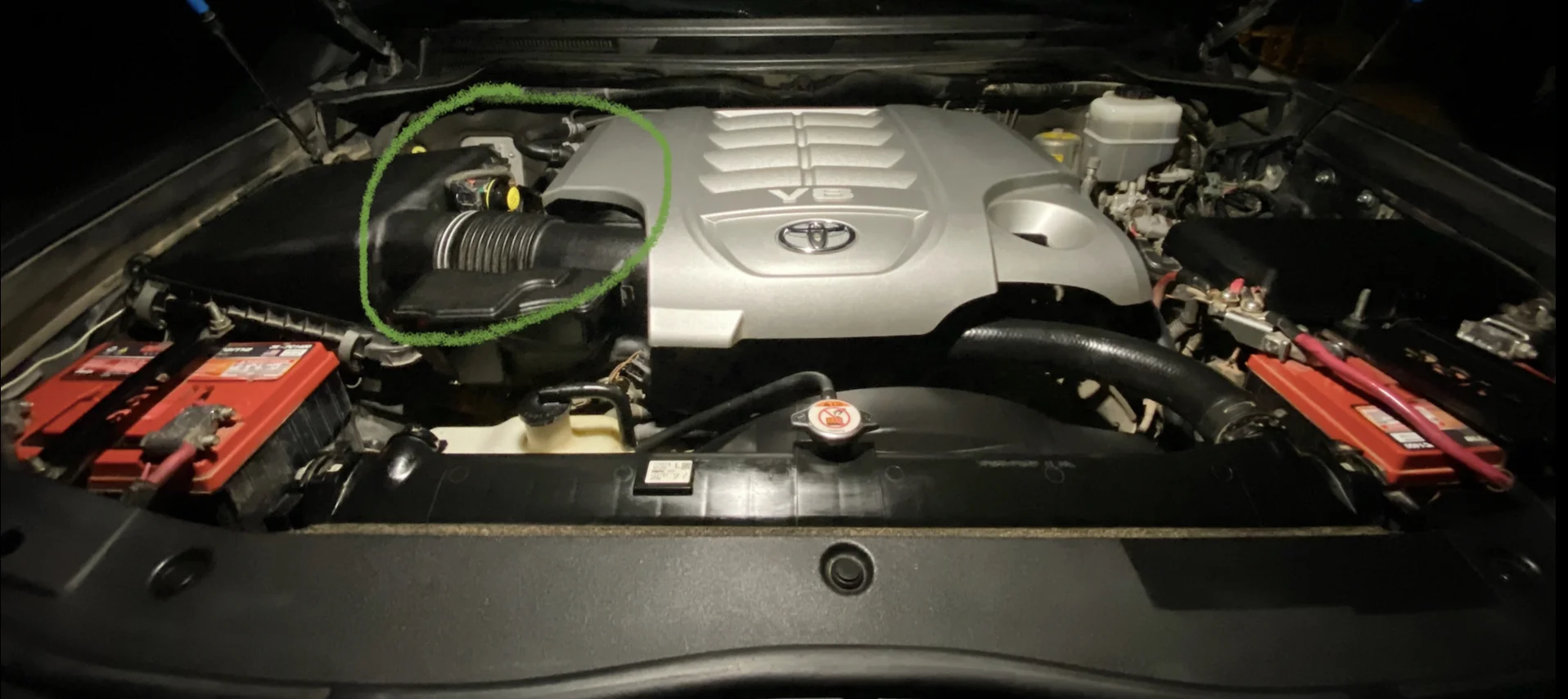

Really all about air flow, which isn’t always easy to determine by the appearance of the filter. That’s why I find this unit helpful… My install:
It measures vacuum level behind the filter. When the vacuum exceeds acceptable levels as shown (and held as a reading on the device) its time to replace your filter.
Very simple to install.
On Amazon:
K&N 85-2445 Filter Minder; Push in https://www.amazon.com/dp/B000E5XQDY/?tag=ihco-20

I did not know about this product. Got one from amazon and installed it last night.
Here is a write up to make it even easier to install and be aware of the constraints the LX engine cover imposes on the location.

Just a bit more info after several years of use—
The device simply measures maximum vacuum created by the engine post-filter & marks the highest vacuum level created against its calibrated spring. The marker is easily reset whenever you like, but obviously should be reset with each filter change. Just have to glance at the marker occasionally (important to select the right one and spring calibration) and then there’s no need to open the airbox so often…which isn’t all that reliable a way ti check anyway (see below)
What’s cool about it is…it solves the problem of trying to judge the filter’s condition from simple mileage, or visual inspection. Filters can look ok but be clogged…and can look bad, but not really be clogged. This really does remove the guesswork.
Also, it lets you experiment with unusually-severe conditions or revs…like after extremely dirty/sticky conditions. -Either unusually heavy engine revs/vacuum…or after an extreme road trip.
One thing is certain in my case—that post snorkel, I’m going through fewer filters…and this little add-on helps to know it.
I like the idea because I can change the filter on its actual conditions. If I go through very dusty conditions for sure the filter gets more clogged than clear air.
But because I live in PNW we get regular rain (not in the past month though) that cleans up the air. There is no need to change the filter at the factory intervals based on my experience with my other cars.
Now I'll just look at the indicator at every oil change when I have to open the hood anyway.
