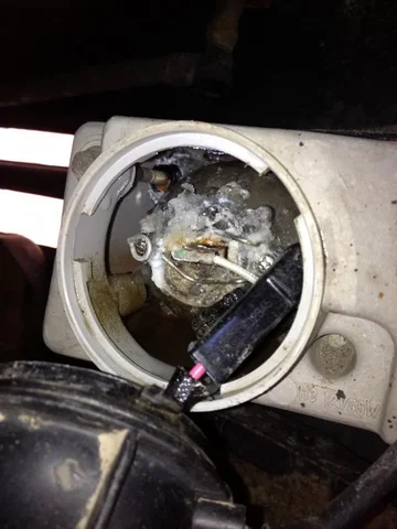

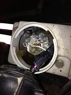

I have been having some strange electrical issues, particularly with the door locks, which occasionally lock and unlock themselves while driving. I'm also unable to lock the passenger doors from the drivers door. The key works fine to lock and unlock all doors though. I also recently discovered (my first time trying to use it) that the seat memory doesn't work. Anyway, yesterday I got the fast turn signal, which normally indicates a burnt out bulb. Later in the day it was working fine, and then today it was back to not working. I took it to be a sign of continuing electrical problems, however, when I decided to pull the bulb out to check if it was dead, water poured out. After drying the bulb and cleaning the terminals, it is back to working. I decided to pull the fog light too, after discovering it was dead, and discovered a mess of water, salt, and corrosion.

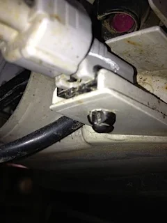

Anyway, I guess I have to pull out the whole housing, and try to figure out where the leak is. I see two bolts, so it looks pretty simple, however, I can not figure out how to disconnect the wiring. There is some sort of strange screw, which I thought was a cap, but it does not seem to come off.

The cap/screw on the lamp could be the adjuster screws.

I attempted to attach images of the screw-thingy and the corrosion/salt in the fog light to my original post, however it did not work. I'm new to forums, so I think I did it wrong, and will attempt to do so again here.
Screw?
Salt/corrosion in fog light

Fog light looks like a mess. Post a larger picture.
Not sure what your question is about the screw?

As requested, I have included a larger photo of the fog light mess.
