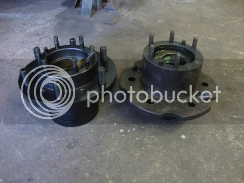

If you don't want to go spacer route again. Bring couple of these from Canada. I think finding them would not hard there. Here is a borrowed pic.
You need 2 of these shown on the right. 60 series wheel bearing hubs. You will need spindles as well, but they can be sourced locally. Used ones are 120.000 tug at parts shops. Spindles are same with early hilux and 4runners.
Also you need the 30 spline burfields and aisin hubs. Cheap chinese locking hubs are junk.
