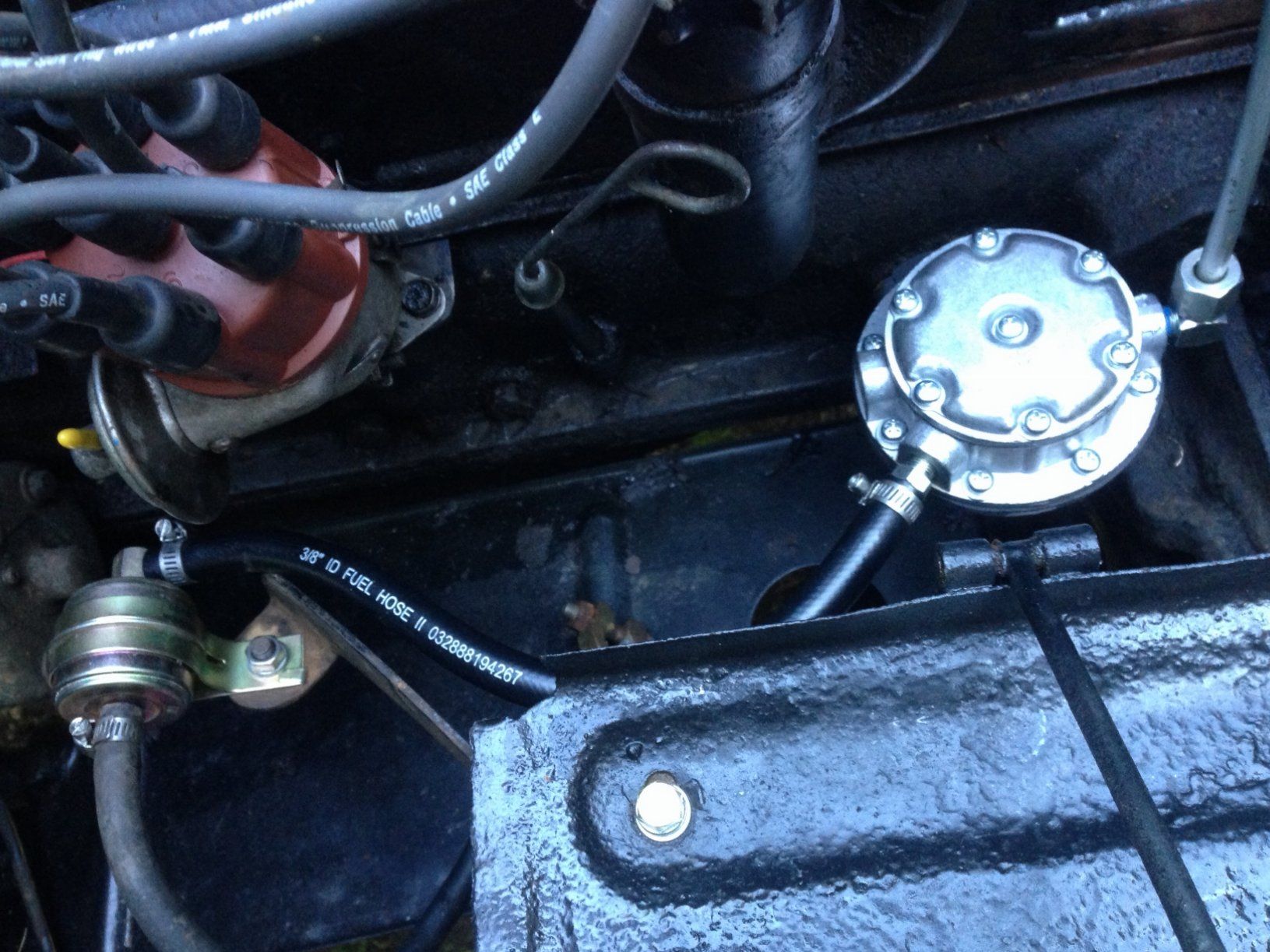

Thanks guys. I opted for mechanical and ordered OEM replacement. Are both the hard and rubber fuel line 5/16"?
Here is what I did
I made a new fuel line tonight to work with the trollhole carb (input tapped 90 degrees over.) Ordered 25' of 5/16" line. I'm glad I did because it took four tries to get it right!
Tube cutter I borrowed from a friend works awesome
I got a $12 Tekton Amazon Prime bender. It's cast aluminum and impressed me for the price. Tricky to get used to though and awkward to hold both ends but also keep the tube oriented how you want it while you clamp it in. A friend to hold things in place would help. View attachment 1394047
The finished fuel line. I started from the 90 over the t stat and worked out from there. Working from one end saw too much stack up. This way it was only two bends to the end from the 90, then trimmed the excess so it bottomed out in each hole and installed the Toyota crush fittings.
2 x Union Nut (90402-13041)
2 x Fuel Line Olive (96395-71400)
From the fuel filter to the fuel pump I used 3/8 ID soft hose and hose clamps
img_0429-jpg.1475296
