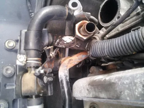

It's finally off. Two hours and my yearly alottment of automotive directed cuss words later.
While you were down in that area, did you change the PHH too (the short coolant hose in the bottom left of your picture, above the starter) ?
Thats the hose that usually starts to leak when you least expect it. And seeing yours has the original cotterpin clamp, I'm guessing its never been changed and has a slight bulge to it. How many miles do you have?
Yeah I figured I might just do the phh while I was in there. The truck is still on stands right now since I was needing a break before making the block off plates. I guess I must have an odd ball in that the truck has 206k with the original hose.
I was more concerned about the wire harness that I wasn't paying to much attention to the hose.

Not wanting to take the plenum off and wrestle with those bolts at the back of the head, I used one of these tapered pipe plugs. Installed in minutes. My pipe broke way down at the bottum. Threads cut into the inside of the pipe.
The initial project was to redo the vacuum lines and vsv's under the plenum. I had already disabled the egr when I got the truck but the pipe became a while I was in there project.
