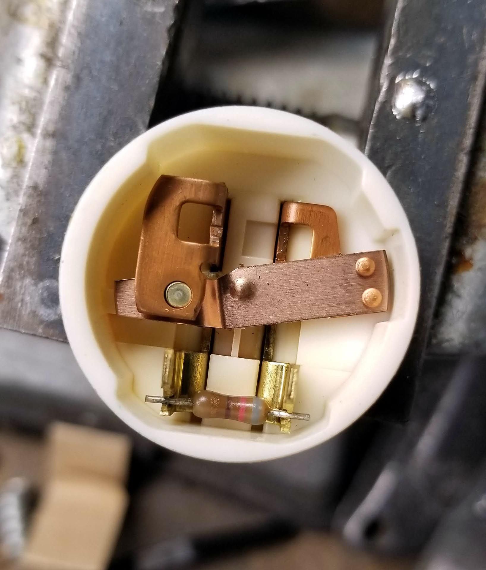

I did find something interesting. My spare EFI relay is a really old one from my 91 and the pinout drawing on the side of the relay case is wrong. Same Toyota part number as the current one, pins are identical, just the drawing is wrong. It shows the coil across pins 1 and 2 and the load across pins 3 and 4.
More interesting tidbits.
I had an old EFI relay lying about the shop, so I took it apart. There is a 820 ohm resistor across the coil terminals, so there is some current limiting on the logic side.
That said, the resistance across pins 1 and 3 with the relay intact will be in the 65 ohm range because the resistor is in parallel with the coil. If the coil is open, it will read around 820 ohms or so.
If the coil is shorted, it will read less than 65 ohms.
We now return you to your regularly scheduled program already in progress.
