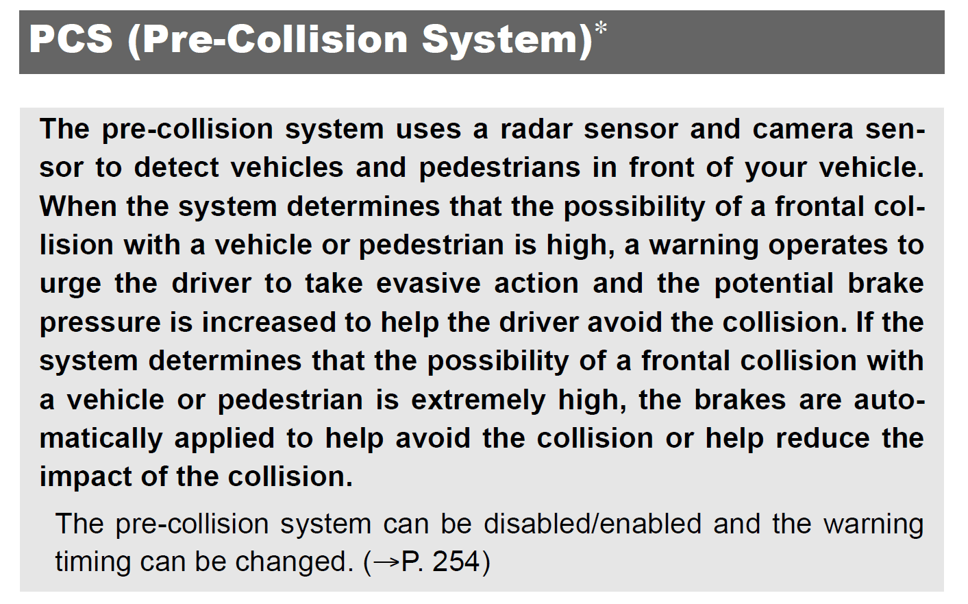

Kind of confuses me why you would want to put a custom emblem in front of the Toyota one, other than perhaps sticking on Rudolph's Red Nose for a couple of days... in any case:
- Radar can go through certain materials, others not... Google search may enlighten you. Otherwise I guess trial and error
- I am sure you are aware the Dynamic Cruise Control and Pre Collision Systems use the radar, both quite helpful I would say
The manual is obvious clear about what the radar does, keeping it clear and not putting anything in front of it.
All in all I would not mess with that part of the car. If you do, good luck with it.
