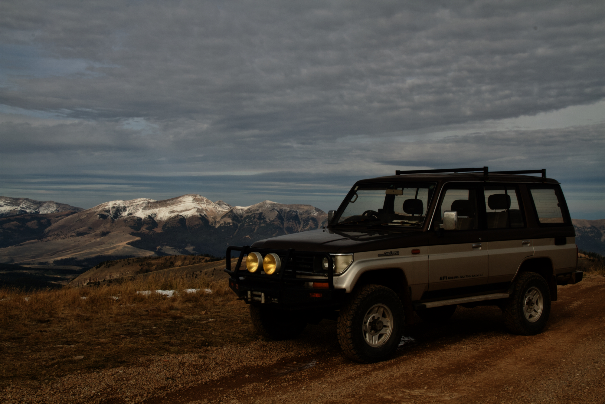

Here's the new bus, I hope to post regular updates of our journey.

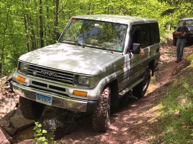

I have the 2" Dobinson on my LJ77 with 255/85/16 MT's
I added A/C and have not had any issues with overheating. Drove it down to Windrock and back doing 70 mph.
