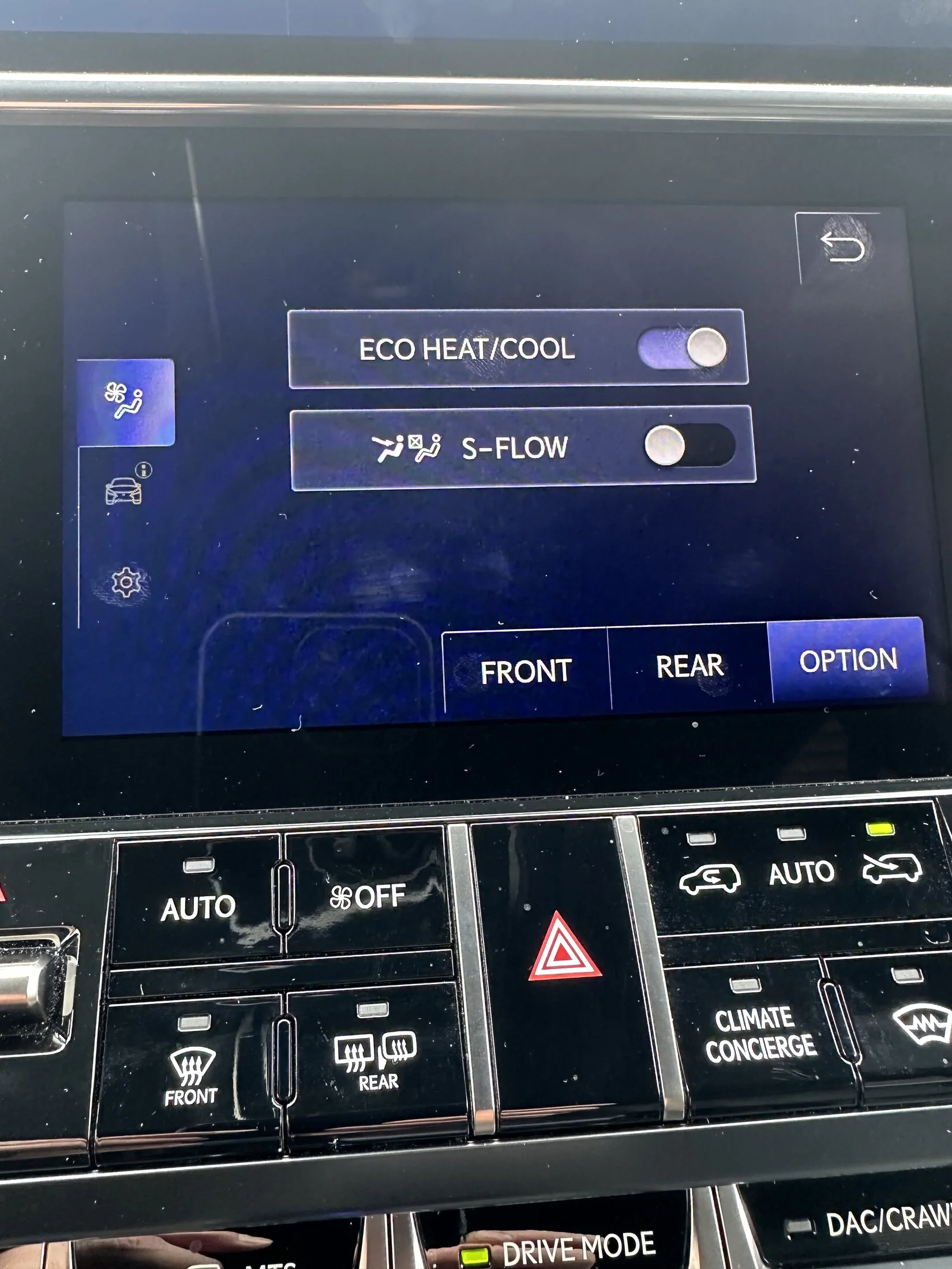

Had my ECU refreshed as per the service bulletin. Now, every time I get in my car and start it, the Eco heat cool option is activated on my climate control and I have to manually turn it off. Anyone else notice this?

Some quick observations…
If I start the truck on Comfort or Eco drive mode select it reverts the HVAC to ECO HEAT/COOL.
If I start the truck on normal drive mode select The Eco/heat cool option is turned off but as soon as I turn the drive mode select to either comfort or Eco mode select the Hvac Eco cool option turns back on. I wonder if with the new ECU update it goes by the mode select now because it has to do with fan speed and gas savings????
I had mine updated yesterday. The eco heat/cool only turns on when you select eco drive mode. It starts up in normal mode - no issues for me. Operates just like when I took it in.
Even if you start your LX in comfort mode it does not revert to eco heat cool? Just confirming.
Correct - only in ECO mode will it revert to the eco climate.
