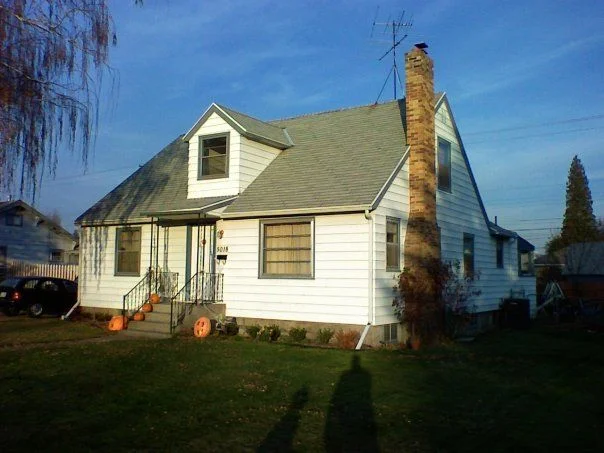

We have soffit, gable and ridge vents. I know our house is poorly insulated also, the snow melts and then refreezes in the gutters. I found a 5w/foot cable at Ace Hardware. It would take about 100' of cable so 500W or about 365 kw/h at $0.068 / kwh is about $30 a month.
You can see the gable vents at the peak, the ridge vents are on the other side.
I wish I could vent it better if that is the problem. I don't know how to though. Our house is a 1.5 story:
the problems are... 1.older cape cod style house with living area in what would be the attic in a colonial or ranch style. 2. gable vents at the top, but no vents at the bottom. 3. given the age of the house, most definitely poorly insulated, but he'd have to rip the walls/ceiling out to insulate better. 3. it has a basement, so just removing the gutters would probably result in water in his basement. you can change your gutters to ones that hang BELOW your eves instead of being nailed to the facia boards. this way, even if they ice up, the ice wont back up into your roofing, but it will still divert water during the thaw and rain in warmer weather.
