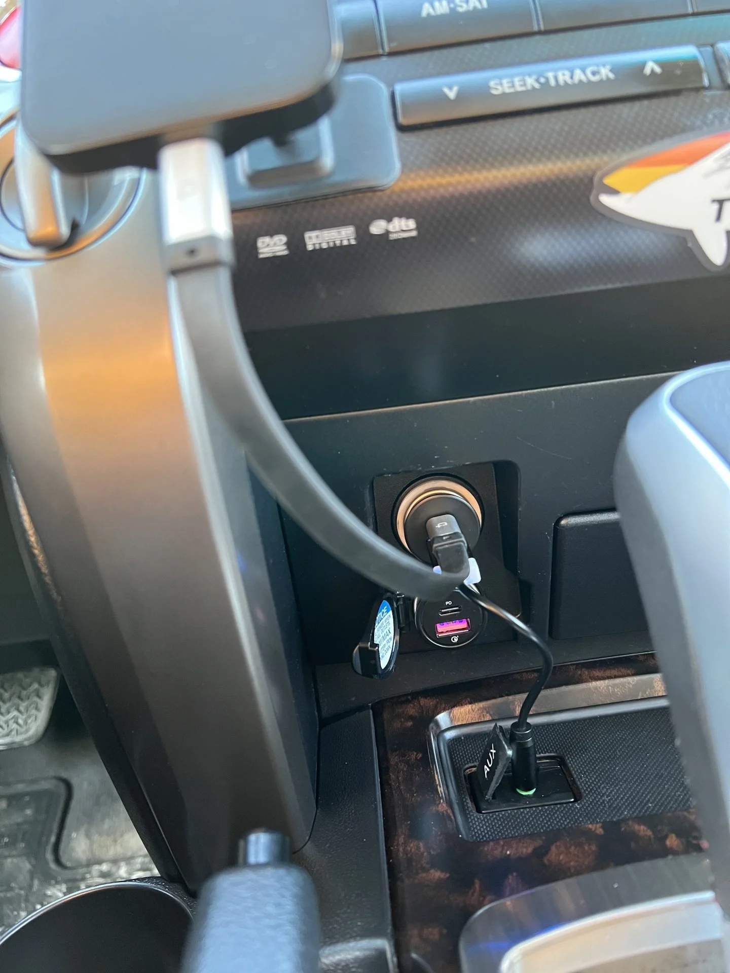

First - install bluetooth connection and phone mount.

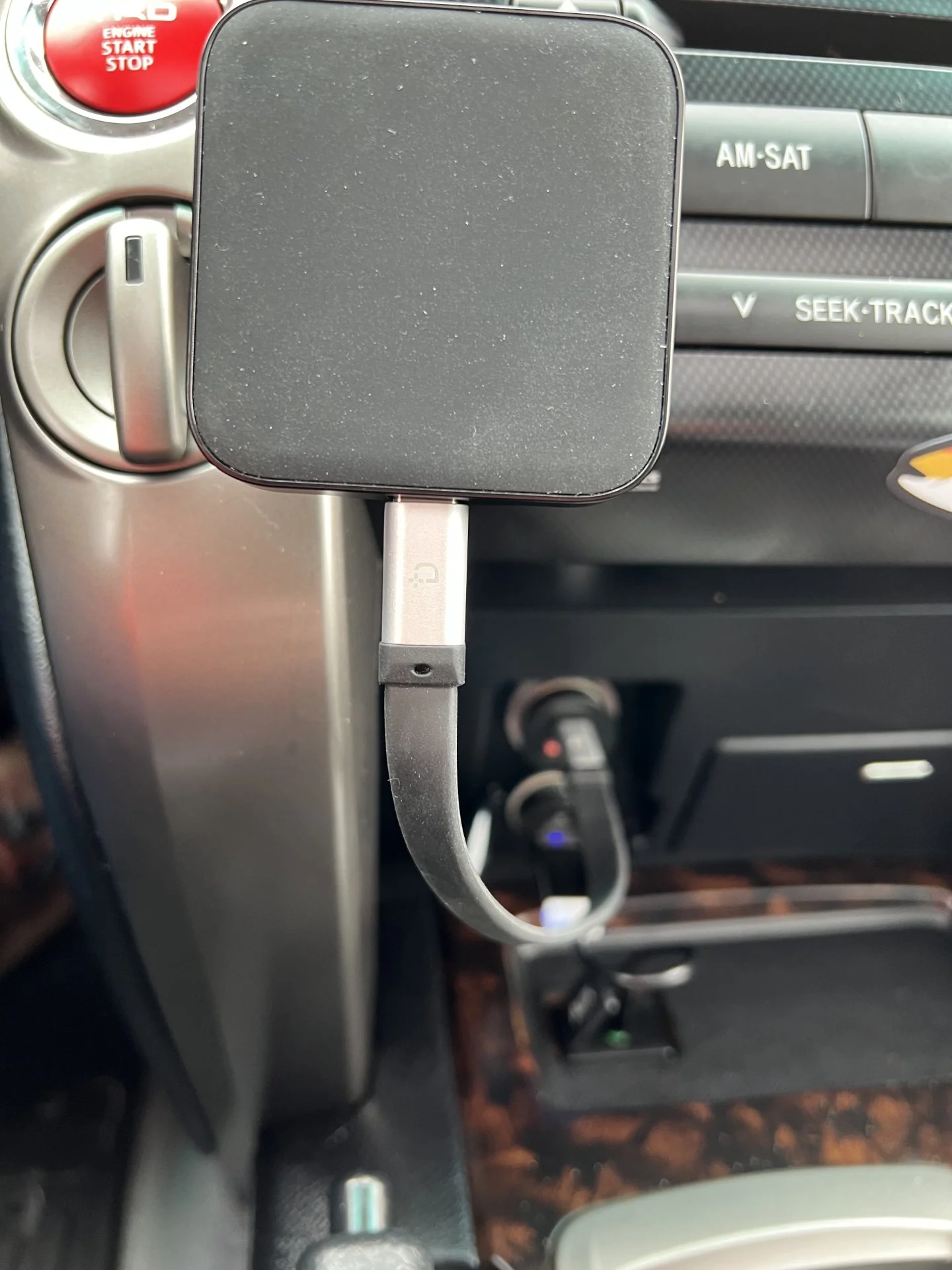

Next: Mount the Peak Design Car Charger. I'm using the wireless charging version here and plugging into the USB-C port with a short USB-C to USB-C cable.
This install works on my 2008 LC200 as there is an aux port near the cigarette lighters on the center console. The TUNAI Firefly LDAC plugs into the USB charger and then directly into the aux-in. This works seamlessly, the LDAC powers on as soon as the ignition is on and the phone will connect automatically instantly. You can pair more than one device to the LDAC - I have my phone as well as the iPad Mini paired.

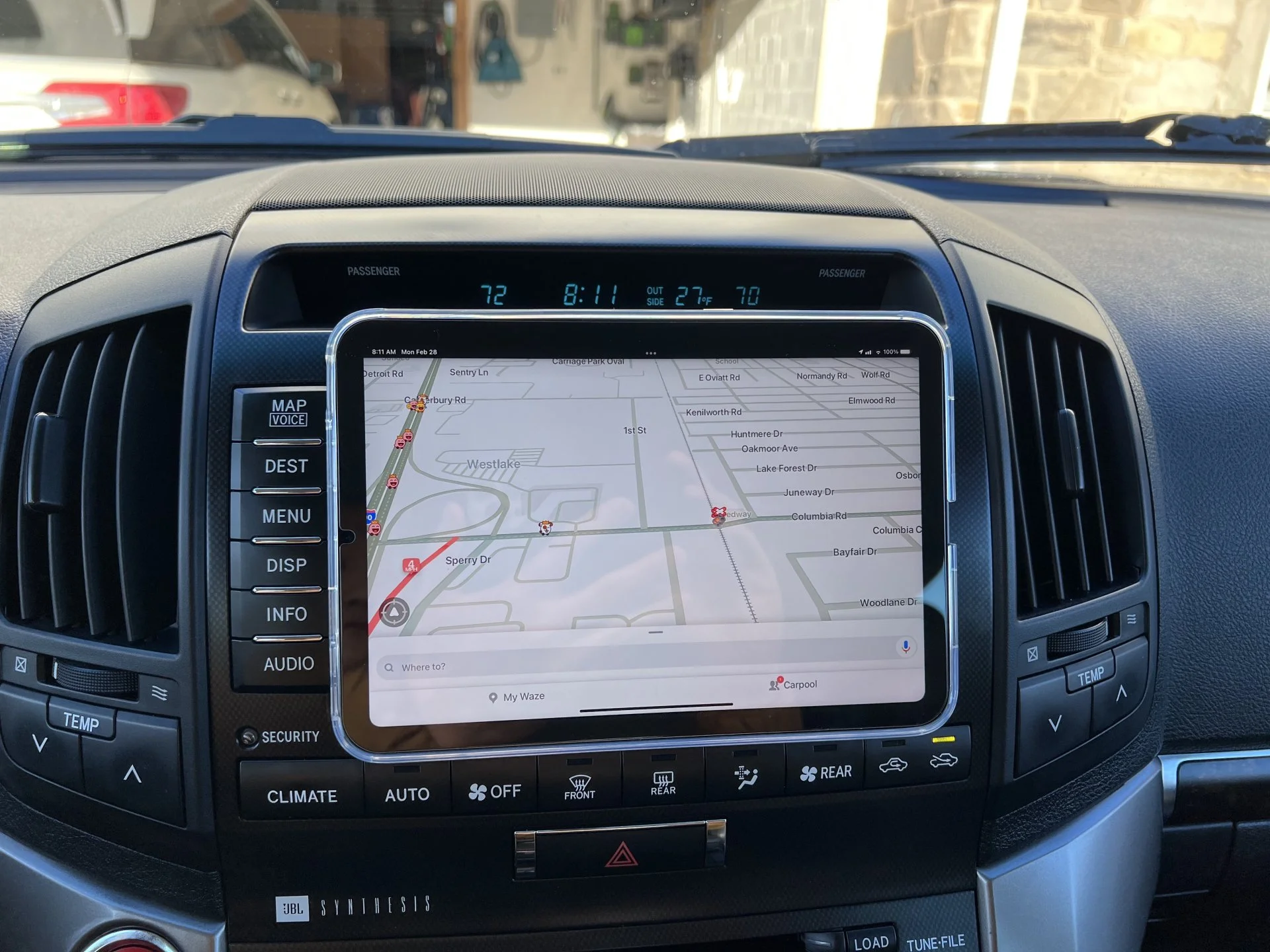

I was looking for a "CarPlay" setup but didn't see much available for the 2008 Land Cruiser. I'm mostly interested in Waze and Spotify although mounting an iPad allows use of many different apps.

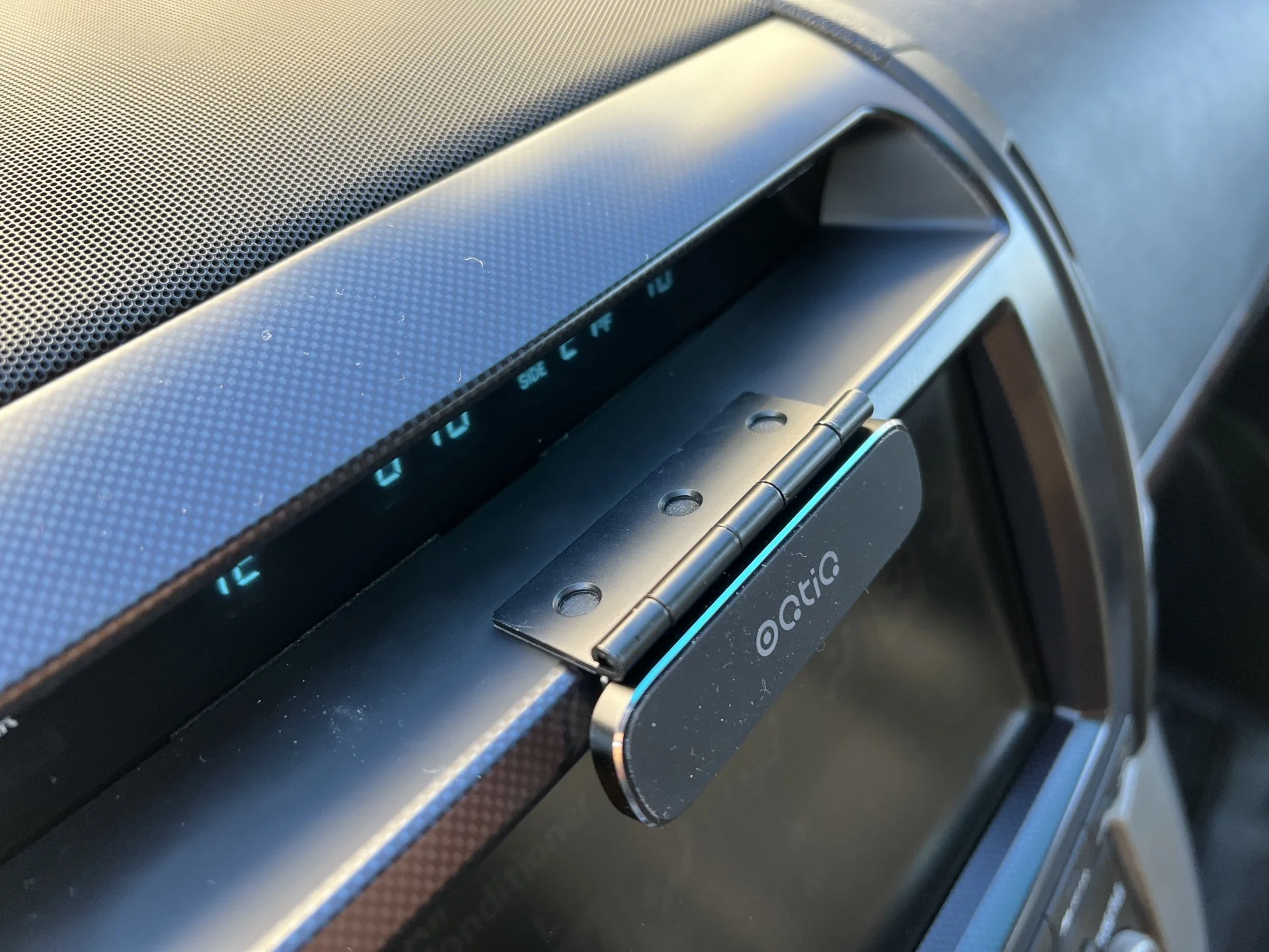

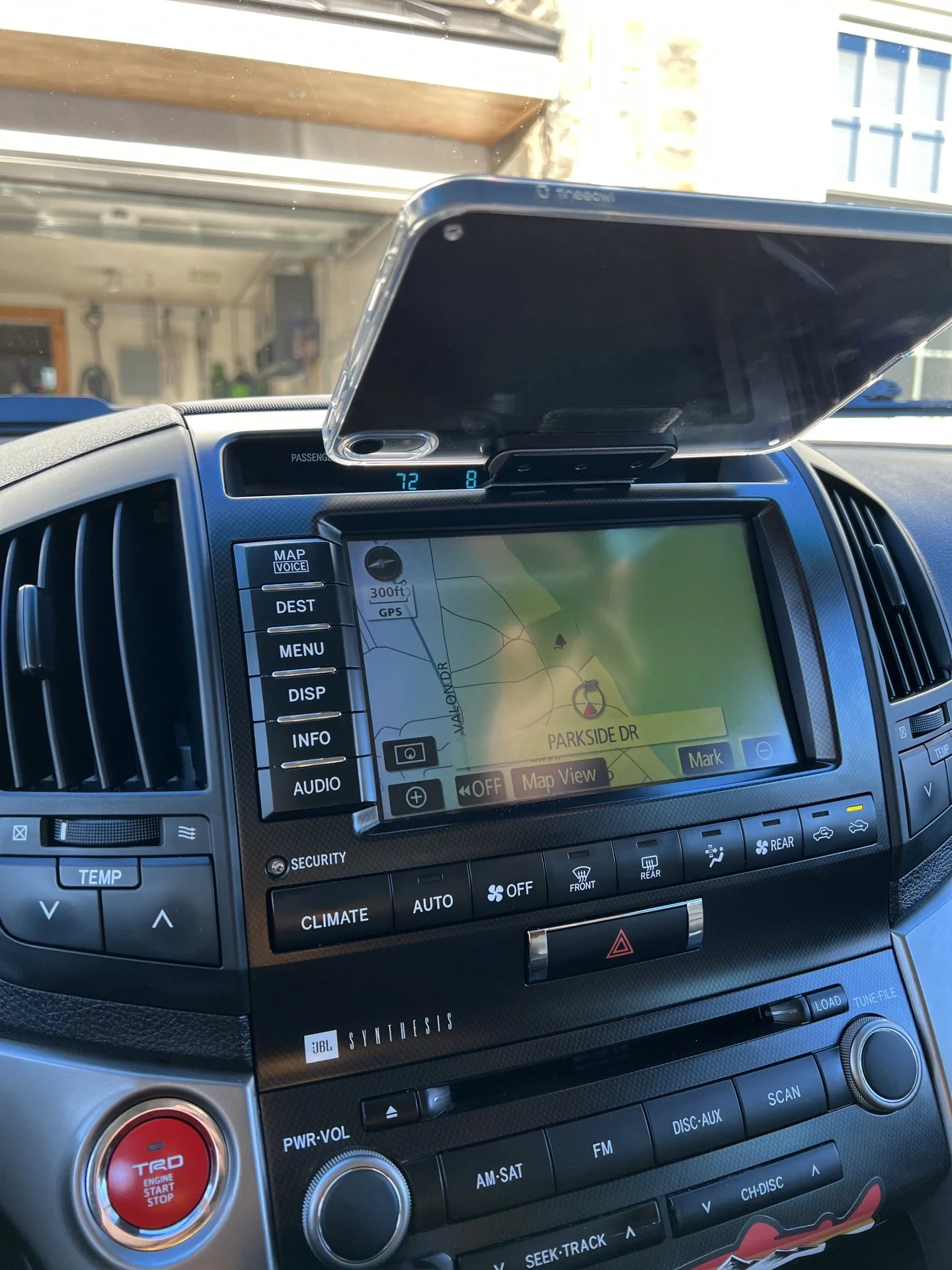

Apply the 3M mounting tape to the metal hinge and mount to the center of the shelf area above the factory NAV screen. Apply the OQTIC magnet mount to the front of the hinge. The magnet mount should be able to piviot as shown in pictures.
The iPad Mini 6 is almost the perfect size to cover the factory navigation screen. You can pivot the iPad upwards and out of the way in order to see the backup camera or adjust the climate control. Not horrible but not ideal.
I like the clean solution.
Q: is the Peak Design for charging and holding the phone or charging the iPad? How do you charge the iPad?
The peak design mount holds the phone and charges it (since I have the charging version). The ipad mini 6 has great battery life so I don't charge it often. When on a road trip or if my kids are streaming off of the ipad i'll hook it to a cable from the charger that you see below the peak design mount.

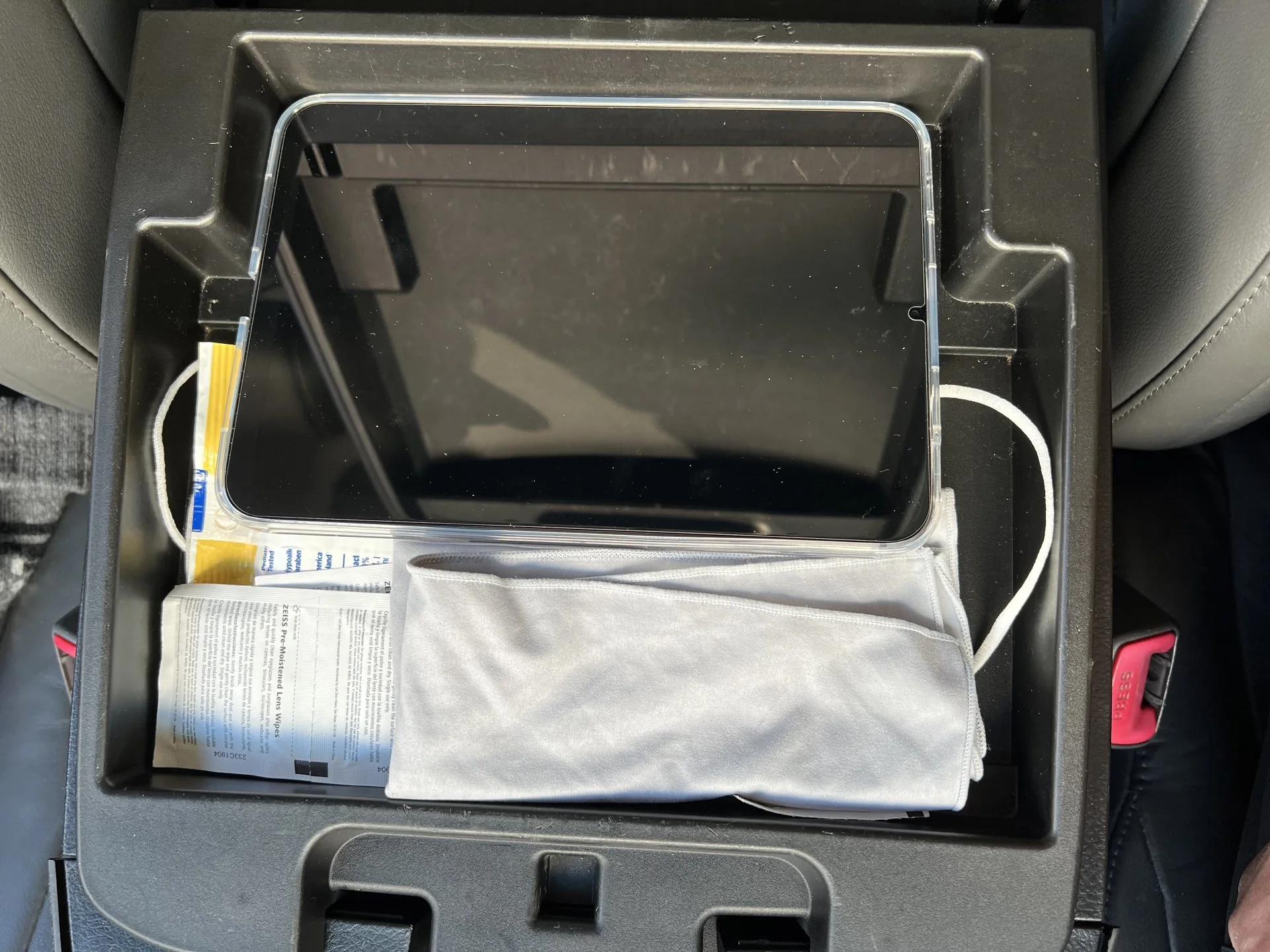

Setup in this fashion I can use either or both. For example I usually only use my phone for daily driving and leave the iPad in the center console. On longer trips when I need navigation I fire up the iPad.
