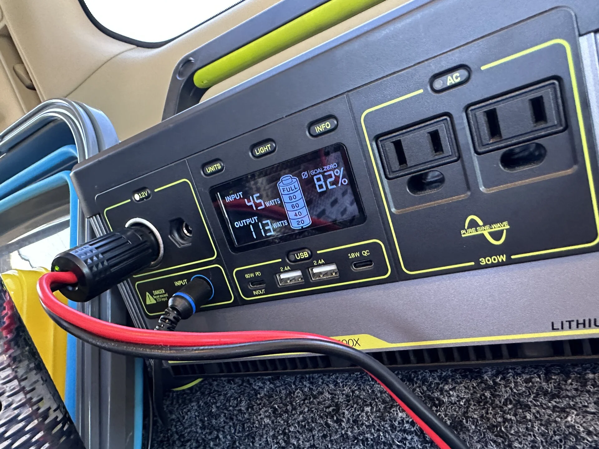

Hi all,
I have been scratching my head at this trying to solve it.
My "solar" setup is currently a 100 watt solar panel, Goal Zero Lithium 500X powering a National Luna Legacy Fridge/Freezer.
Currently connected to the fridge via 12V cigarette lighter (goal zero) to DC input.
However when using the fridge/freezer combo (after both the goal zero (fully charged) and fridge (pre chilled days prior) in my vehicle it does not last a whole 24 hours. Parked/driving with clear skies and sun out
The output for my fridge (when the compressor kicks on, which is often is 113 watts)
Does any of this sound right? Am I doing something wrong?
I am a total noob when it comes to this stuff.

A few questions: What is your Yeti's charging profile, how much time are you getting and how much power does your fridge take*?
Goal Zero lists the 500X as a 505 Wh battery. Let's assume that 's true for now.
If you had a charging profile of 20%-90%-100% which is what I use (Yeti cuts off at 20%, starts to charge at below 90%, continues to charge to 100%) then you start out with an available amount of energy of 505Wh-(.2*505) or 404Wh available.
So, while we know how much power is drawn when the compressor is running we also know it doesn't run all the time. Ouch!
So what we need is power usage over time. This will vary with ambient temperature, temps you set for your fringe/freezer compartments, and usage; i.e. how many times you open the lid. Triple ouch.
We're up to 4 ouches and we're not done yet. :bang:
*To get that you'll need a power meter like those from Powerwerx and a 24 hour test under realistic conditions. Get the 75A model if you decide to get one.
So here's how you can start to figure this out.
As an example, my Dometic CFX3 75L DZ pre chilled, takes 50 Wh/h at 75F ambient, fridge/frezer at 37/0F and only 1 quick open & close of the fridge lid in exactly 24 hours. OK, that's not how it will always be run but it's a BEST case scenario, a floor so to speak. It will only get worse sitting in a hot car and actually being used.
You don't state which model you have and Luna doesn't appear to publish their power estimates. So, to take a guess I'll assume your power usage is 70Wh/h. If you like that guess then 404Wh/(70Wh/h) is 5.8 hrs.
EDIT: you do state the model in your title. Sorry.
Charging by the car and solar offsets this and at full sun you might be at net zero.
Does this help?

OP, 113W seems inordinately high for a typical travel fridge, but maybe this is some specialty affair? For context, my big kitchen fridge uses less than that when running.
Is there anything in the fridge or is it completely empty?
Interesting about that diode affair mentioned above. What is it supposed to be for?
It's odd that this battery system up there would have a cig lighter and a barrel plug but no Anderson PPs outlets. (And, yes, I do not like cig lighter plugs...) Nice USB assortment, though.
if it is above specs, you could maybe check to see if the airflow in and out of the unit appears reasonable as in is there some blockage, or are the condenser fins clogged up possibly?
e9999, I was thinking of the graph you did of power draw thru a time period or more importantly from off to on to illustrate the draw during start vs while running after started. And IIRC the 113 is more than twice what a crappy fridge (12V) draws at the start up spike ? If its a 10 amp fuse then its feasable it could be going direct to short with 113 ? am I crazy or could it be happening ? if all wires were sized right I suppose a 10 amp circuit could continually pass just less than 10 amps.
Anyway, if it is doing that something is still worong
well, if the 113W is only very briefly during the startup, and now -going back to OP- I see that the OP stated something possibly suggesting that, that could be normal if the continuous draw is around 50W. It would be a bit surprising to me that the meter would have captured that spike and it being long enough for a pic, but possible.
OP what does the output show a bit after startup when things have stabilized?
(But dang, all this speculation, is there no number on power draw anywhere in Luna's literature? Or can you call tech support?)

A, W, V are steady state values, the power meter is capable of showing peaks which suspect occurred when the unit was switched on.
I have seen W lower in the range of 30-35W at the same voltage under the same conditions. Maybe the compressor is only cooling one zone then?
Voltage displayed on the Goal Zero will decline but output will be a constant 13.5 +/- 0.1V
Note that the Watts displayed on the Goal Zero doesn't quite add up: 11.6V*3.3A=38.3.W. The Goal Zero doesn't display all values simultaneously and I tried to cycle through them as fast as I could to come closer to an instantaneous reading.
