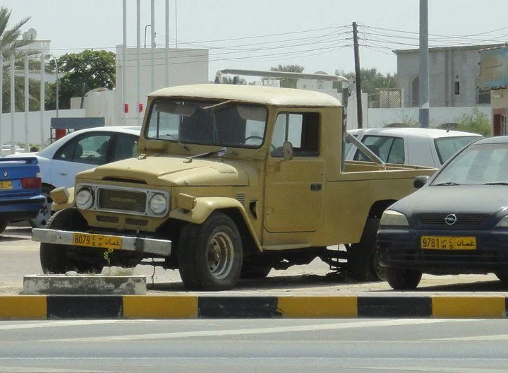

Some pictures of some other ones in Oman... Not mine. Way worse condition :)
These trucks are typically used for fishing, where they get driven in and out of salt water on a regular basis... these particular examples were actually in brilliant condition compared to what you normally find. But still, not as nice as my new lady-driven one :)
This is one sad looking Land Cruiser in need of a rescue.
A friend is gonna go look at it so fingers crossed :)
That was my exact thoughts too. Looks like it has sat there a while, ticket under the wiper and all. Was that possibly a troopie that has been cut down to a ute? Toyota did not make them like that did they?
Good find with your red one though. It looks like it has been looked after. I've visited Dubai twice and really liked it over there. It was frikken HOT though. Air-conditioning is your friend in a climate like that! :lol:

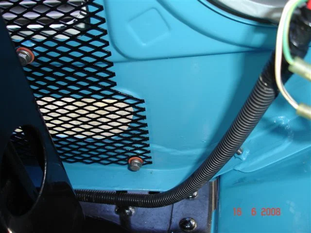

IMO you need to change the grille mesh to a MUCH smaller sizing Oman4x4 unless you have no stones on your roads/tracks over there.
Even the standard mesh size lets through stones that are too large (in my opinion because I suffered stone-holes in my radiator tubes until I reduced my mesh sizing).
Good to see you have mesh above the bib (even though the sizing is too large). I learnt to do that too.
