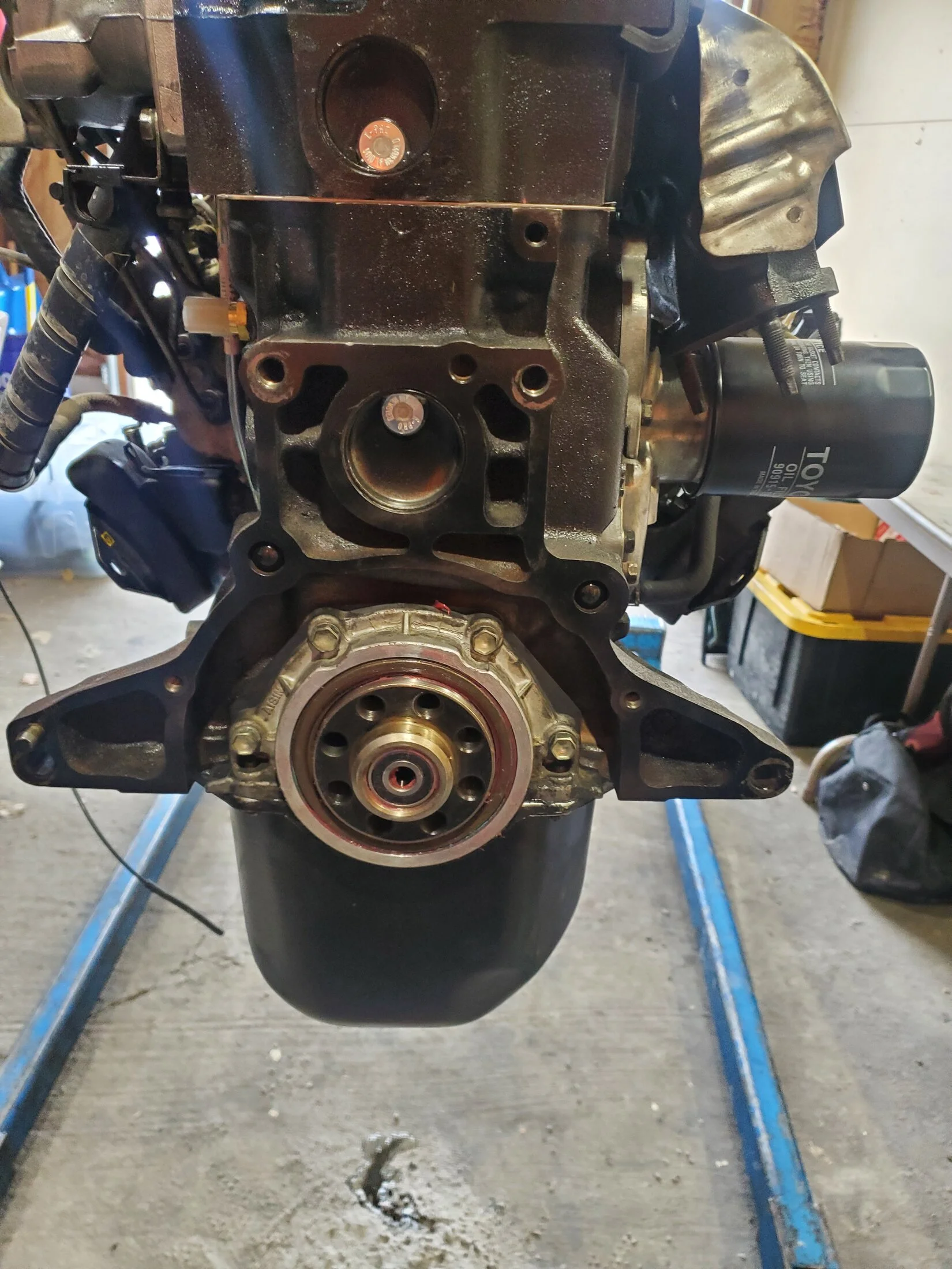

Here are some pictures from my 3L rebuild last year on my LN106. I think you probably could, it looks like there is clearance for two seals. It doesn't look like it would cause any problems. That being said, I wouldn't do this.
