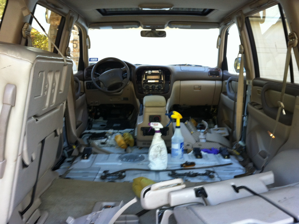

drove it home, ripped the seats out, ripped the carpet out. vacuumed/dried as much as i could and put fans everywhere.
checked oil, no water let the engine run with the windows up and heater on full blast for about 4 hours. car turned into a sauna but it got hot enough to slowly dry everything out.
after 4 hours EVERYTHING worked great with the exception on the under seat amp. It was toast, had to buy a new one.
started it up again in the morning and let it get nice in hot inside again for 2 hrs.
That was 9mo ago. Truck is 100%, runs like a champ.

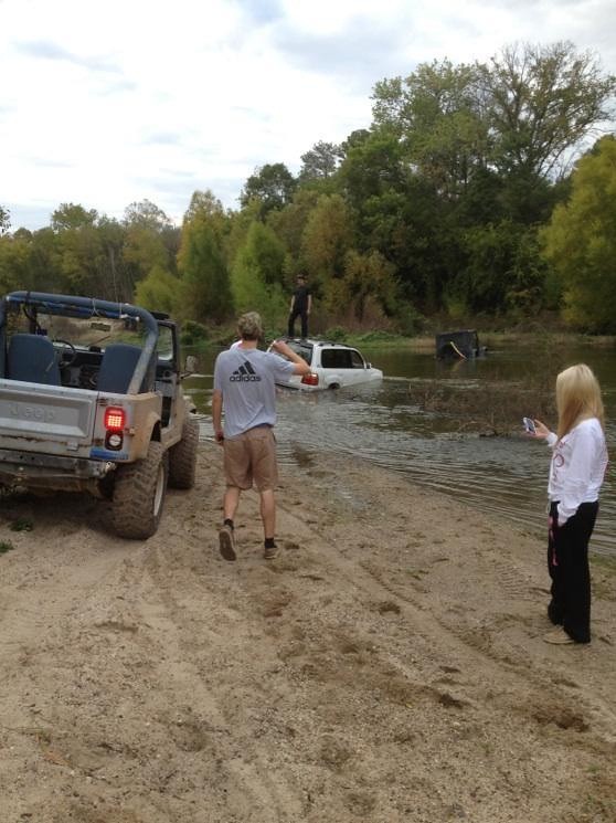

it sank another 8-10 inches after this pic was taken.

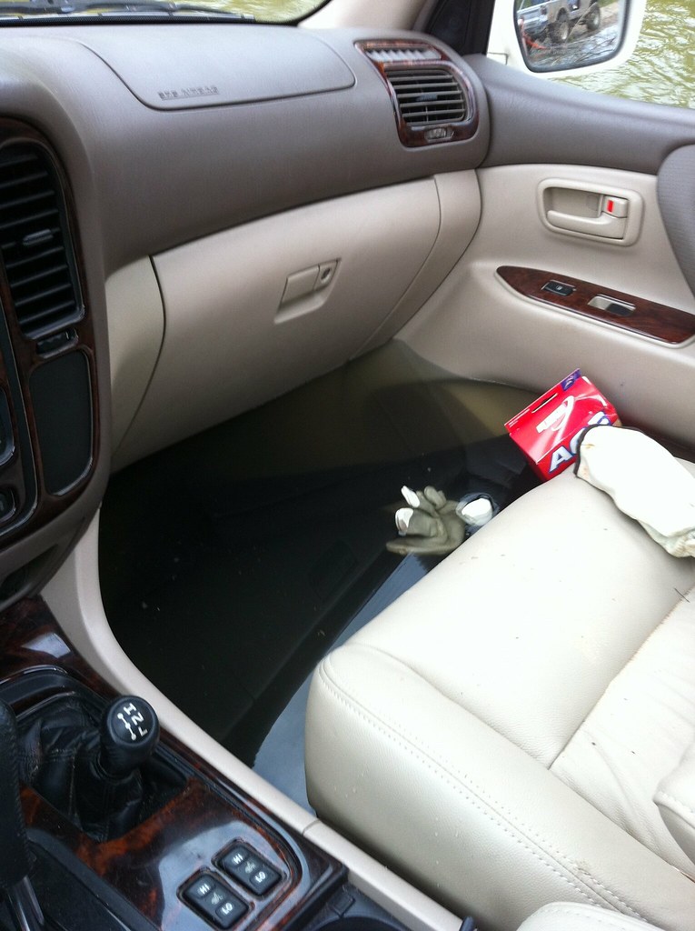

here is picture shows same case as my case! as i said luckily ten minutes but like this situation who wants to walk away from car to get a picture! i dried out(i assume) computer/parking assist/ navigation computer under the seat! and engine control(ECU or s/thing). finally i got the car in garage after 2 days of struggling with mud and rain. i pulled out 6 sparks of 8(closest two sparks to driver's front location were very hard to pull out/ i need to find a better tool for them)---- out of 6 only one had water rest were totally dry! i think it takes longer time and effort to find out about wiring! check picture my situation is like 2 more inches deeper! Drowned lexus 470 and toyota LC - 4x4 Community Forum

in my case i knew the depth, was trying to yank out the jeep pictured and got dug in the sand.

when you cross the river - it looks shallow! and it obviously a cross river! begining of the river is shallaw and suddenly your truck crashes in big trench, sucks water through air filter....when engine stops- it sucks water back through exhaust all the way engine..
and i made mistake not checking the water depth before i start drive into water,,,,, i will never do it again!
