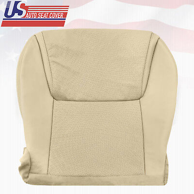

Lx570 has leather replacement seat bottoms on both amazon and eBay (same vendor). I don’t remember if the had TLC, wasn’t specifically looking. That seat looks a lot like the lx seat, but no leg bolster so the front plastic under the seat is different.
Those look great! You may still need the foam to bring the seats back...
My thoughts exactly. I figured if you were to replace both fronts, you could just add some foam to match the better looking seats' (passenger most likely) internal structure.
I like this price but tan may not match the Lexus parchment color. I would buy this.
I’ve been eyeing those and believe they are parchment. Am waiting for my tear to get a bit bigger. Then I’m going to try to glue it. Then when that fails I’ll move on to replacement.
If that's the case then I'm buying it as well the seat cushion. Utube has a couple examples of installs and it almost looks like fun.
That seat cover company is sending me a sample. I'll toss up pics when I get it. I'm hoping they have the top leather piece for the seat as well.
Cool. Hope the color is close. Post pics.
will do. My truck is no show car, so hopefully just a solid notch above duct tape is mainly what im looking for. I did find a replacement seat on eBay, but $375 shipping kills it and the condition doesn't look great. Gonna also check out a couple of local upholstery places and get quotes, new foam would be nice as my seat aint nearly as comfy as the passenger seat. Also my armrest and that area is pretty shot in the padding department. Thanks for the tip, i'll post pics
This is the one that I used when I replaced my drivers seat bottom on my 2008 LX570. The original one they sent didn't match up correctly how it was assembled in the front to account for the extending front portion of the seat cushion. That being said, I made it work and has been fine, mostly perfect match on color and everything.
I sent the original back to them and they sent a correctly assembled bottom back but I ended up leaving the first one they sent on the seat for now. Probably been right at a year plus now I think.
