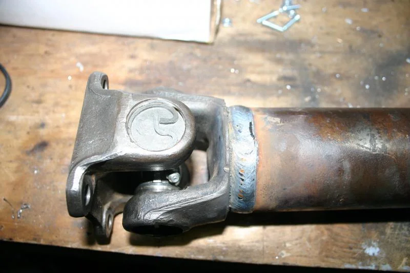

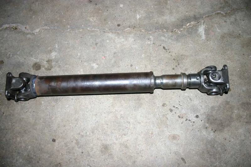

If you have bad FJ drivelines, just upgrade to 84-95 toyota minitruck components.
The minitruck shafts are usually too long for a cruiser and only need a cheap cut and weld to shorten them at a driveline shop. Sure beats paying for new inferior stuff and paying the big money for a RETUBE and balance.
