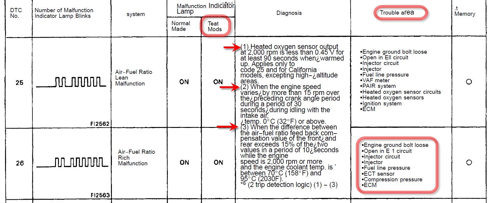

It's not 100 different things. The horror stories you're reading about are written by people who haven't taken the time to properly diagnose the problem and troubleshoot the solution. Quit reading posts about other people's problems, open the manual and a beer. Once you've exhausted the Toyota documented steps to solve the problem, THEN go searching for other ideas.
Note that a proper diagnosis requires you to test in Test Mode, as well as Normal Mode. Test Mode exists for a reason.

Agree 100% with Malleus. Do the tests. You can't assume.
