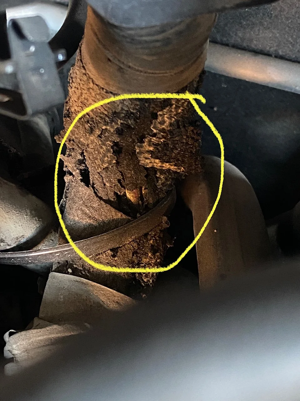

One other thing to check is the wiring harness near the EGR. The EGR is known to melt the harness and cause shorts which would give you drive ability issues like you are talking.
This is what mine looked like, visually looked good. But when the LC idled the harness was moved around and made a difference in the way it idled.
