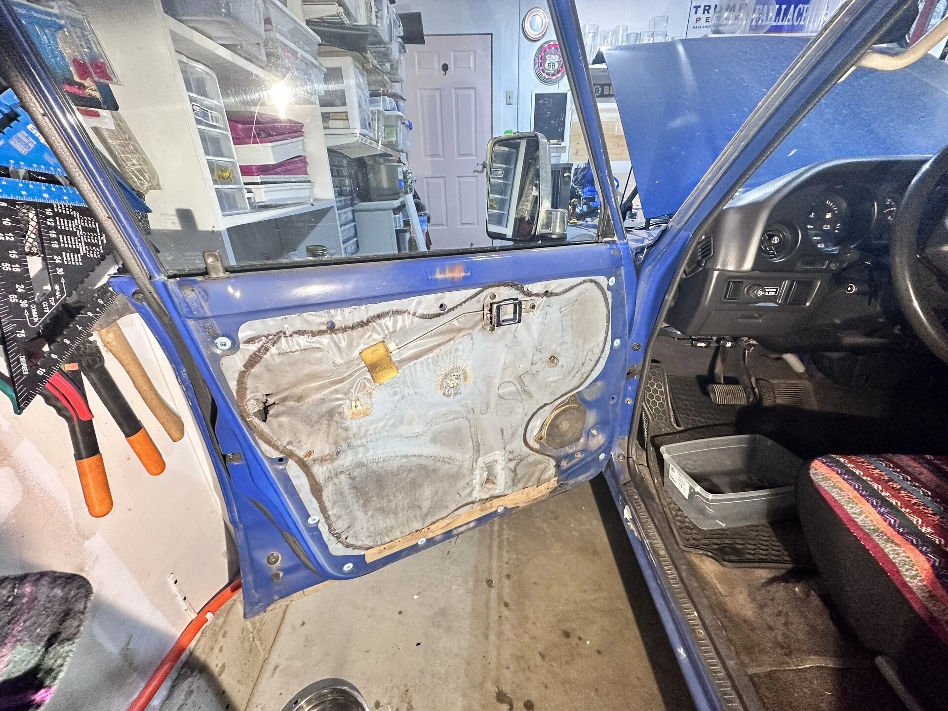

I’d love any tips recommendations thoughts about reinstalling panel and backing.
  • sound deafening mats (brands superior or not)
  • Any type of sound / heat Installation?
  • thoughts on Butyl Adhesive Sealant or tape? Is there an alternative? Seems like environmental moisture & heat could eventually make for a gooey mess…Like the one I found! Leads to next question-
  • should old butyl adhesive should be removed?
  • have moisture barrier methods changed from glorified shower curtain since she was born in 1988? And I’m not too good for plastic if that’s that.
  • I haven’t removed plastic yet as I suppose I should attempt to get it as a whole piece to make template for replacement - what’s best method for getting it off?

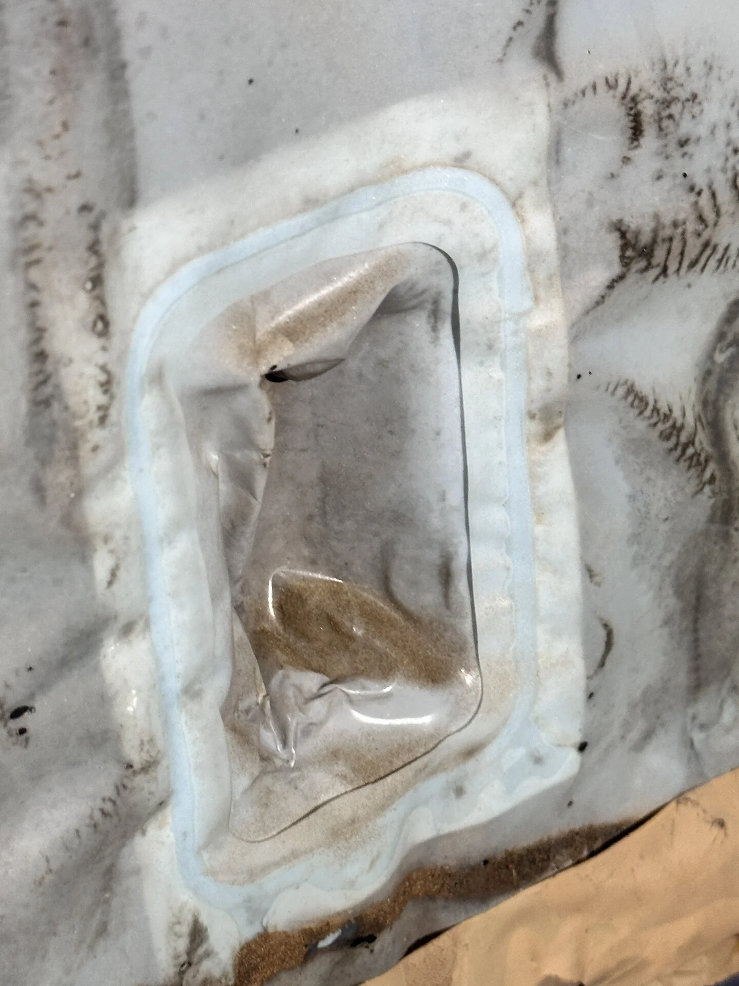

  • And for curiosities sake what is the odd little pocket thing in bottom of door with specific moisture barrier sealed cut in? Photos included
The inside of the door gets moisture from rain. Anything you put inside the door (insulation or whatever) is going to trap the water and accelerate rust.
It’s my belief that nothing extra should be applied to the inside of the doors. Just make sure the drain holes on the bottom are clear.
That plastic sheet on the door just peels off. Or maybe can be cut off with a razor. Adhesive is still gooey and pliable after all these decades. Replacement plastic is easy to find at a hardware store. Look for painters sheet plastic.

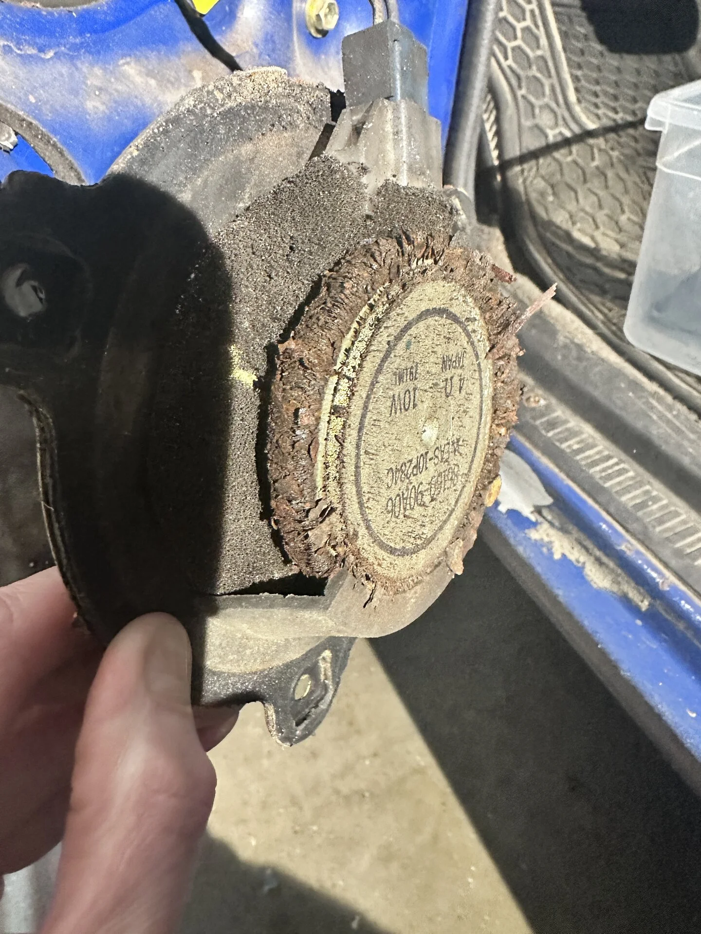

Au natural- I dig it- I’m pretty surprised to see minimal rot inside door- now the speaker which had been working I assumed was after market as wiring for subs and amp is still in car and well it worked - but holy hell I think it is original! Haven’t looked at it closely as I found a prehistoric dead bug on plastic barrier and lost my ****
Is there a market for original speakers ??
