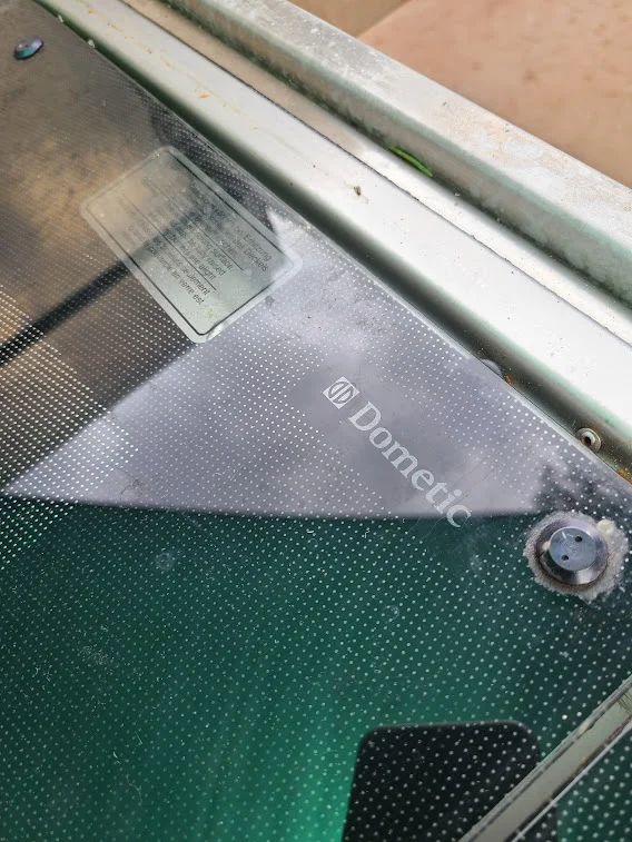

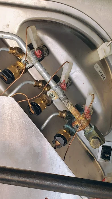

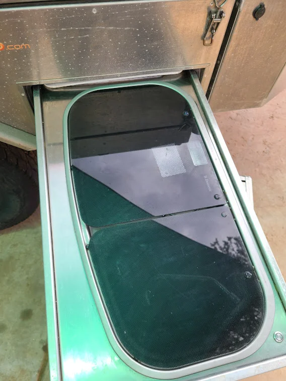

Hey folks,
Couple of issues I'm having with my sink/stove combo an wanted your inputs.
- the alum piping is experiencing galvanic corrosion under the stove.
- one of the burner lost 50% of its output
- third burner knob refuses to turn after being depressed. It does in/out just fine but doesn't want to rotate. I've tried squiring wd-40 in the stem but no luck.
I can take the whole shebang out and start taking things apart but wanted to see if y'all had any thoughts. I've reached out Dometic for a repair manual and/or ideas. I bet they're gonna tell me to take it to an authorized dealer :rolleyes:

I have the same Dometic 3COMBI-8901 in my Adrenalin Blast trailer. From the pics it looks like the OP has the same or very similar trailer. I have similar stove corrosion problems. The stove-sink slide-out drawer on my trailer is a magnet for moisture even with various whole-trailer cover combinations -- the stove parts get wet while in storage and the various aluminum and steel parts corrode. I worked on my trailer yesterday after the propane parts clogged again and the stove is again non-functional. I will redo the weather stripping for the whole trailer (including that drawer), repair the stove clogs, and then coat the stove (e.g., WD-40) each time I store it. I have the stove burner parts apart and soaking in vinegar currently.
Yes, the 3-burner stove is not practical because the burners are too close together and the need for three small burners while camping is very rare. I have been looking at 2-burner stove replacements that would almost drop-in. And I have also been contemplating a dehumidifier, etc., for the inside of the trailer while stored.

That corrision is caused by steel and aluminum touching. I would bet that clamp where it is coming from is steel. It normally gets much worse the closer you are to salt water, but it I don't think that is an issue for you in NM. If you use steel and aluminum together then put a piece of duct tape or 2 or 3 between them and that should take care of it. I have also seen that squishy foam tape used. Good luck.
Thanks for the reply, I'm going to take this unit out and replace it with a two burner stove and maybe a bigger sink, if possible. I despise the triangle configuration of the burners as we can't place a cast iron griddle across both burners for more efficient way of cooking.
