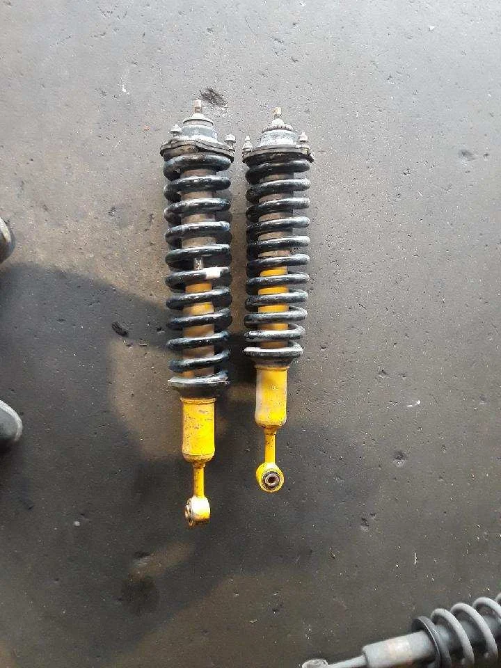

Does this look right to you?
Dec 30, 2017
97
Socal
Flash back got these ome shocks and springs off my buddy,
25k on them, they been sitting for over 2years,
My shop said it doesn't look to good and can't get the strut to move up and down on the short one.
They said it will look bad if I install them
Is this common on ome stuff?
They recommend me to upgrade the front t shocks to Bilstein 5100 and call it a day.
I'm running ome rear shocks and springs also and the rear shocks are fine.
Any input would be great
They look like OME since they're yellow. Other than that, can't say what they are from just a photo.
If using original springs, make sure the mechanic knows the two front springs are DIFFERENT side to side. Make sure they get the driver side on the driver side.
I replaced my stock Bilsteins with 5100's so I could do a small lift. Can't really tell any difference in ride, except on washboards, the truck tends to drift more. So the combo of stock springs and 5100's is not quite as good as the stock config.
Using ome heavy in tge front/ome med in the rear.
But again was confused as the springs in the picture look to be different lengths, so was not sure if that is normal
