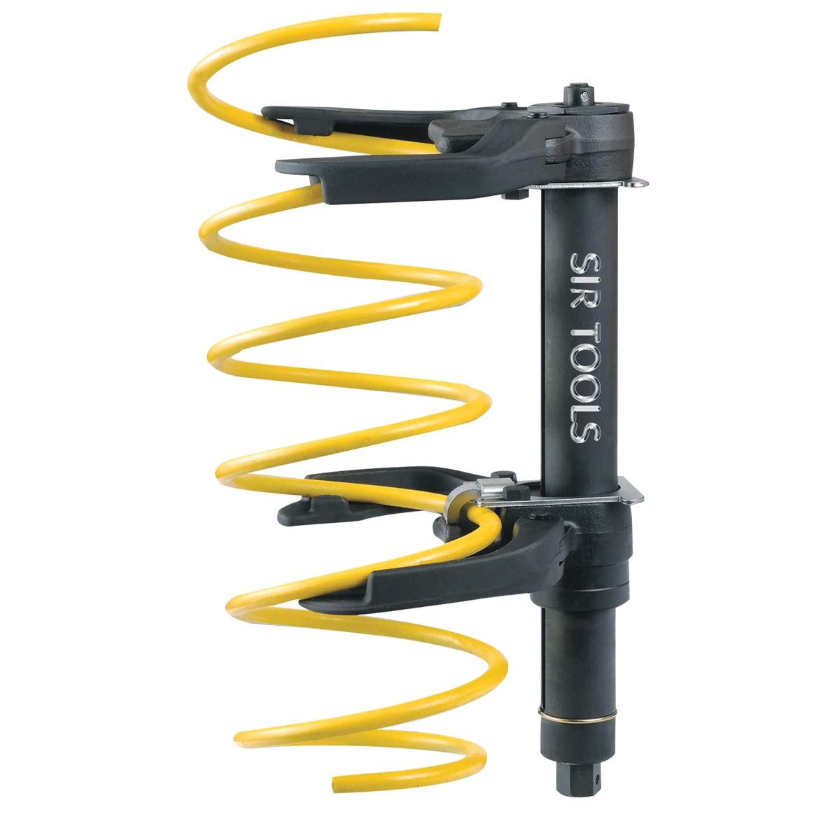

- used spring compressors but there springs won’t physically fit in the perch with the compressors on.

Thanks for the reply. I should have mention it’s a 2nd gen Sequoia that has IRS, not solid axle in the back. Your method has worked for me in the past for my 4Runner but not so well for the IRS
Thanks so much fellas. I’ll see if I can find one of those compressors.
