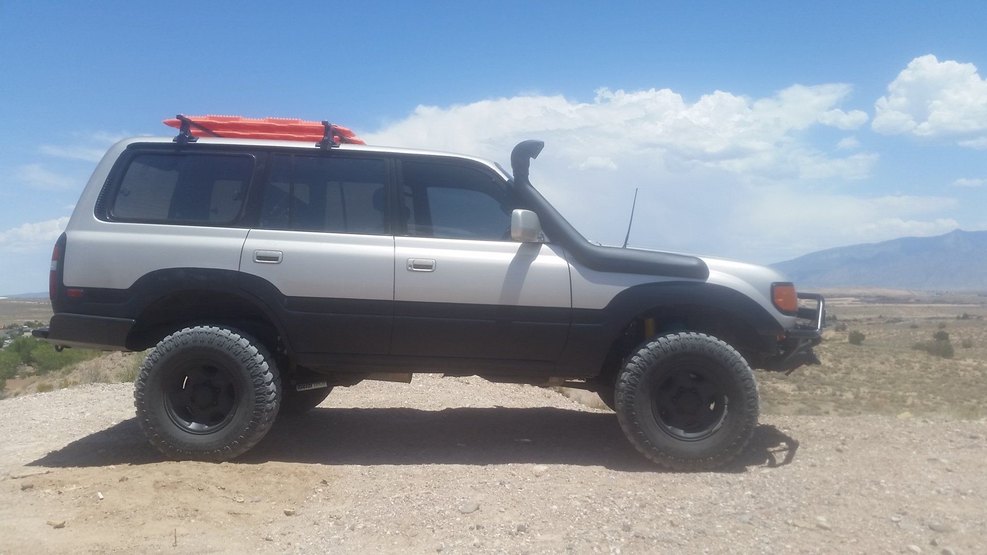

Does the 2.5" tapered count?

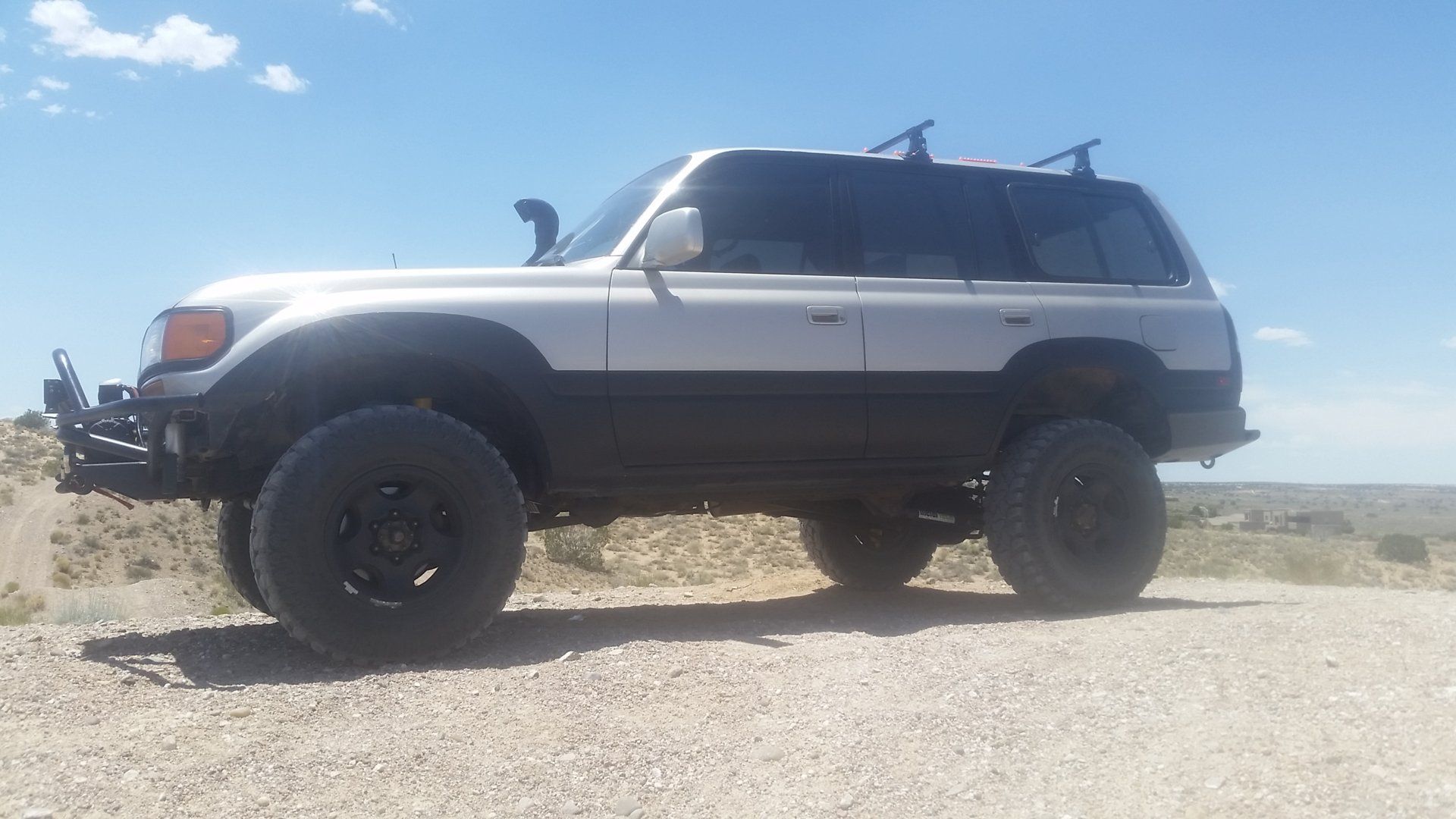

2.5 tapered with 4-5 shocks, tires are 285s and bumpers and winch. Love it. This pic is empty rear end and light
Thanks for posting pics! I'm about to pull the trigger this week on this same lift. Did you use the tapered coils all around, or their flexis in the rear?Any spacers used? It looks like some stinkbug there, unless its the terrain/angle.
Love the ride, travel is more than I would need but it's set up for great articulation. Did quite a bit of desert testing but not rock crawling as I'm still not fitted with aprropriate bumpstops. No spacers.
Tapered all around, gained about 3 inches from old stock springs. Stink bug is a problem but when I put spare tire and swingout on will be gone to unnoticeable I bet. Like I said empty in back.

I have bumpers, skid plate, a winch, York oba, a 35" spare on a swing out and have about 100 lbs of gear in the back, and I got the same stinkbug results with my 2.5" tapered; that last side shot Jeremy posted looks exactly like mine does, except that my fender gap is slightly less due to the 315s. I'm in the process of accumulating the extra parts needed to space the front up another 1.5" using Metal Tech spacers for a full 4" in the front to match what I ended up with in the rear. Additionally, while I'm there, I'm going to swap the four springs left to right. I installed them correctly according to the tags on the springs, but because the right springs are an inch shorter and because I have the spare on the right, there's and out a 1.125" difference left to right measured from the center of the hub to the bottom of the fender. David said that if theres an inch dofference, the springs not mounted on the wrong sides. My response to that is that the springs were incorrectly marked if that's the case. The lift was the last thing I did to the truck, and it didn't lean nearly this bad on the stock springs, all things being equal down to the tires. I'm really hoping that after the left-right swap that it doesn't then lean an inch to the left...

thanks for the feedback @Dindu Nuffin. That is quite a height difference from ps to ds!
You're welcome, and it absolutely is. I had even thought of installing them on opposite sides because of the difference in length and that my truck did already lean a small bit, but figured Dobinsons knows better than me.
