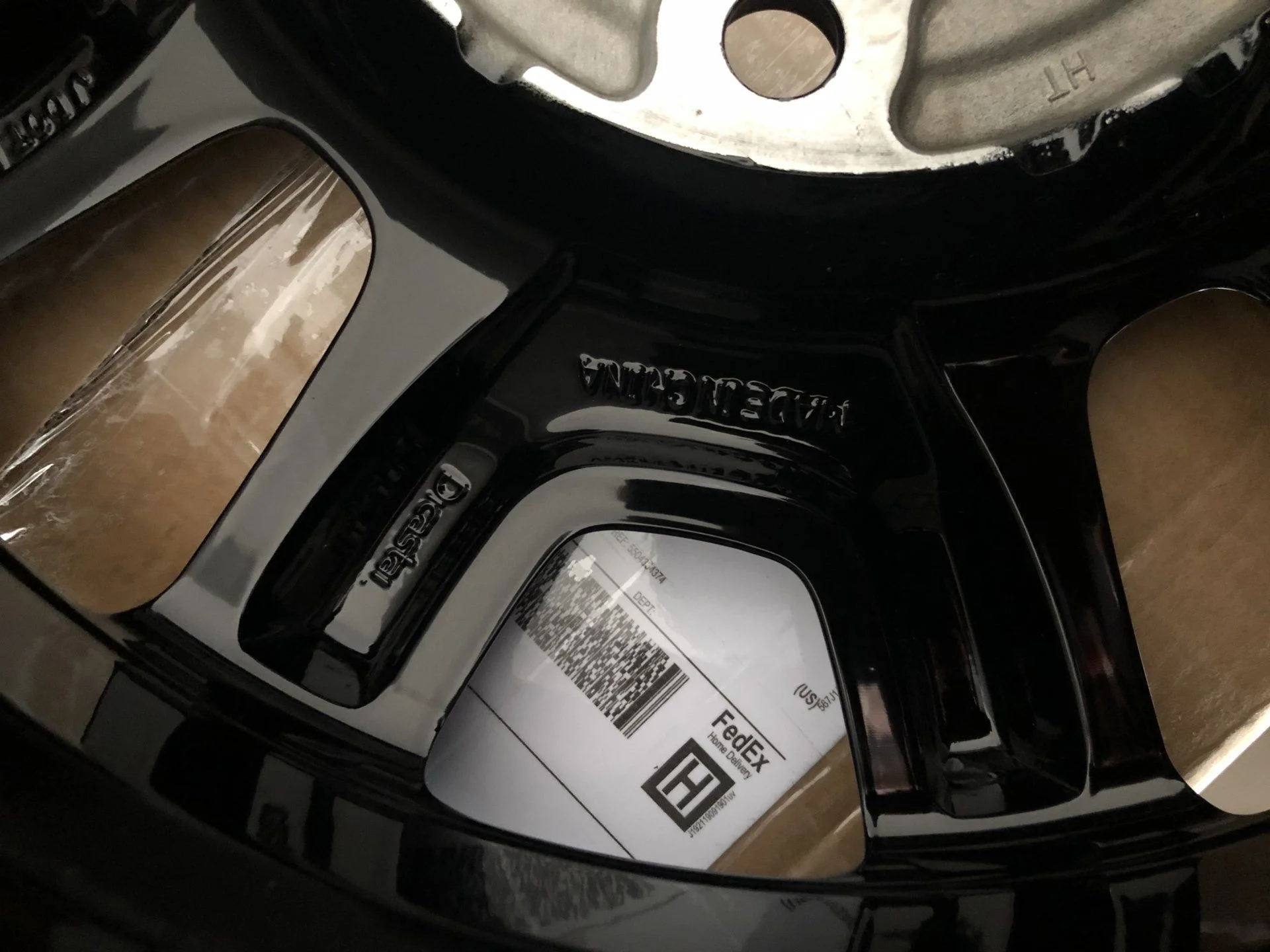

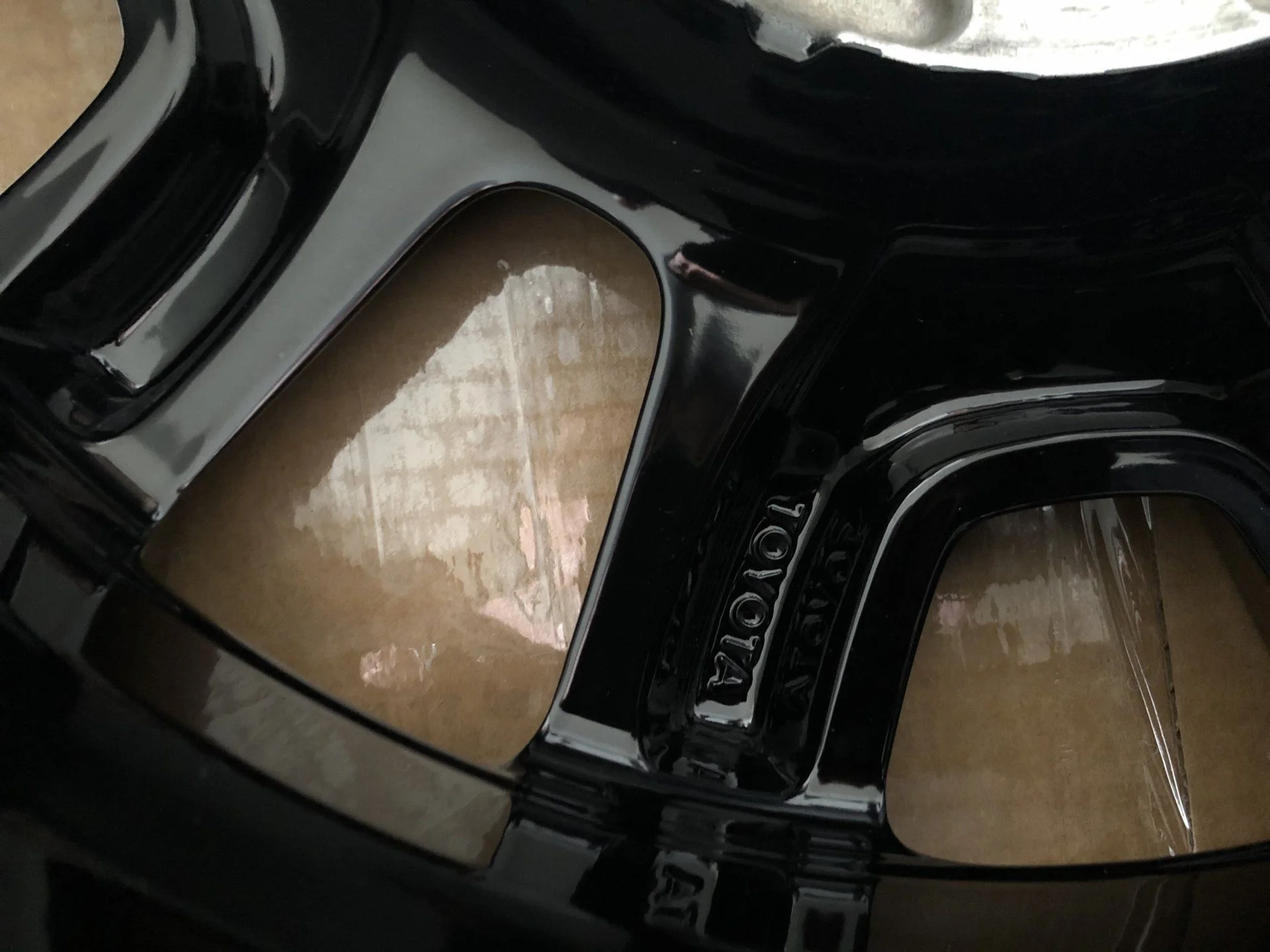

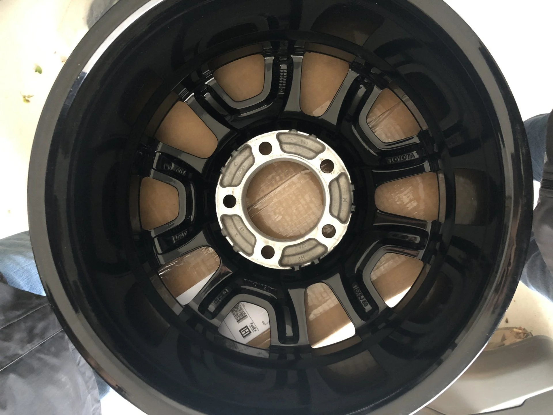

Hi guys,
I picked up a set of winter 18s for my 19’ LX off eBay and given the seller had no feedback I’m doing due diligence. I realize it should be done pre purchase not after but I have recourse.
The plan is to install my LC factory size blizzak from my 18 LC I traded and have some cloned tpms installed by the local tire shop.
They look pretty good on initial inspection but one can never be too careful.

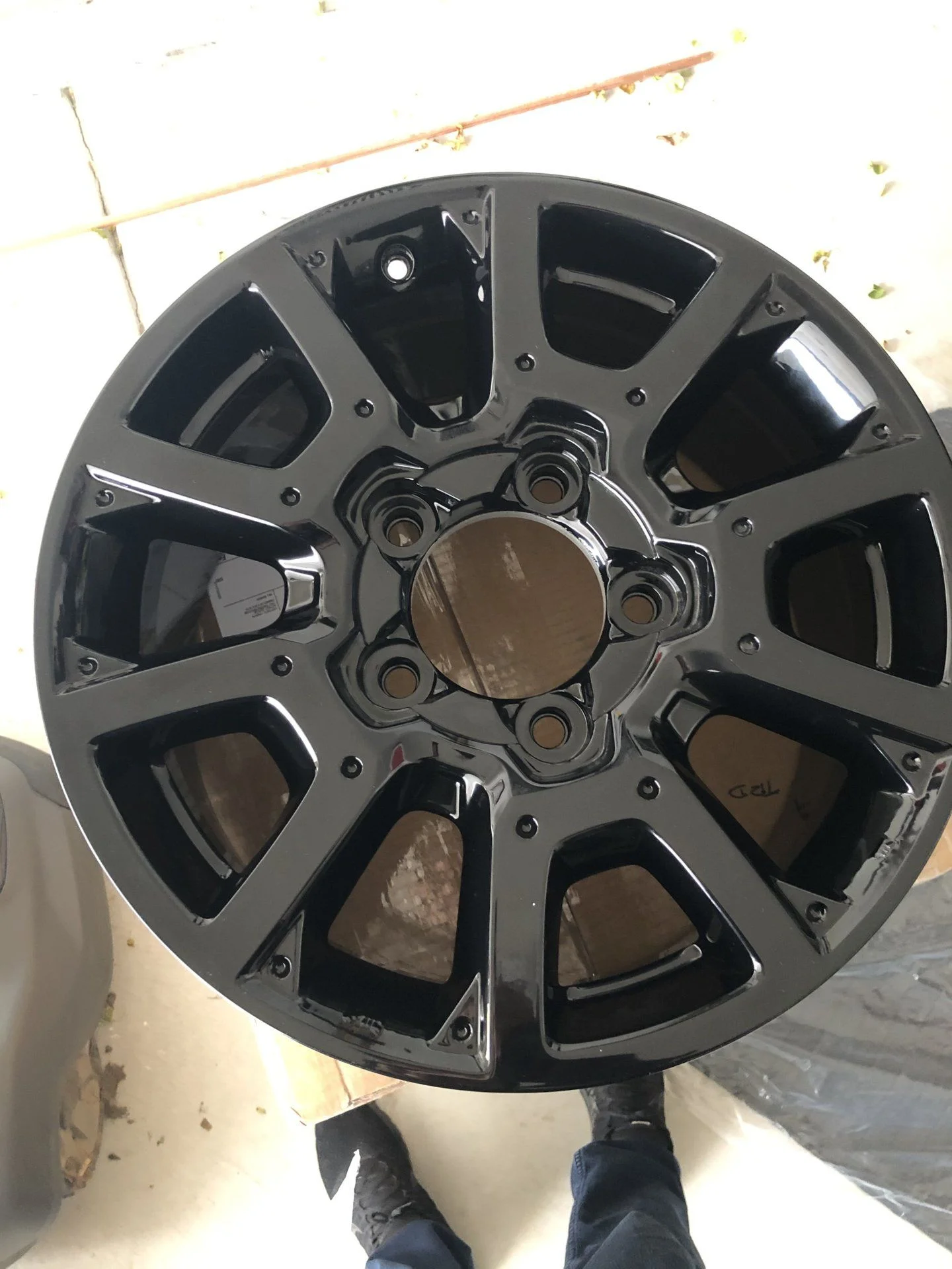

Find other pics of the same wheel and try to determine if the lug nut washer seats are masked on those. I seem to remember the ones on my 13 LC wheels being bare metal but I didn't get them new.
Yes they are off a 2018 trndra pro and/or off road trd..... the 2019-20 tundra trd pro came with the BBS

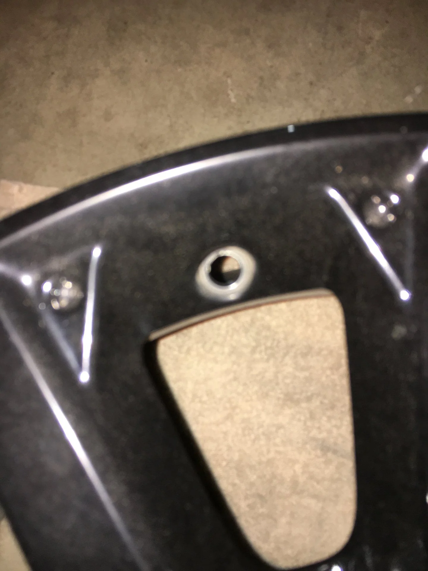

They look like the 42611-0C170 repainted black instead of the 42611-0C200 which are from the factory all black for the 2018 TRD pro and 2019+ Tundra youth package.
Factory tundra wheels will never have paint in the lug nut seating area or where the TPMS washer is seated.
Both wheel part numbers listed above are made by Citic Dicastal out of China and shipped to the Tundra plant.

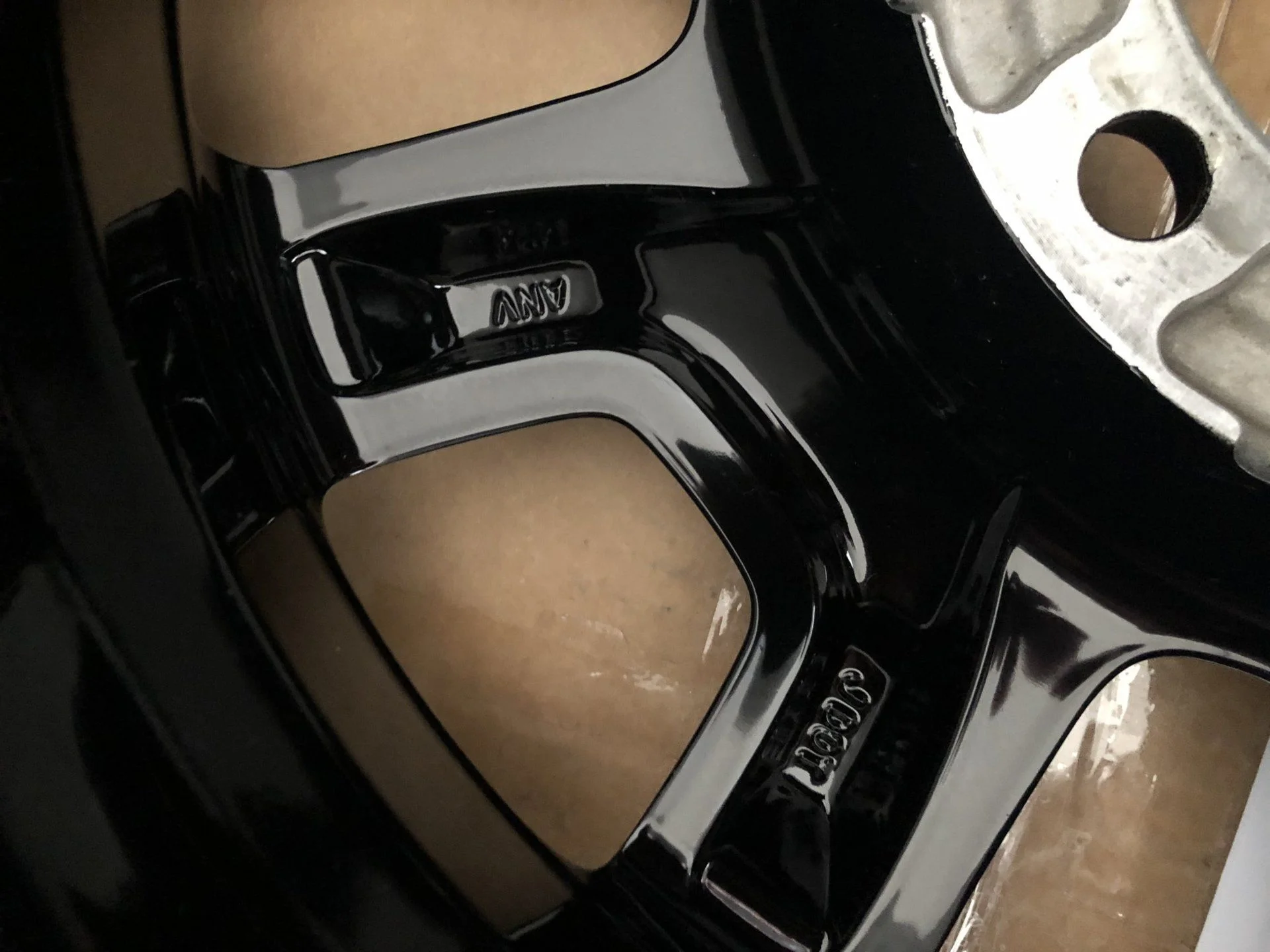

It is hard for me to elaborate but in my job, I deal with Tundra and Tacoma OEM wheels at the factory every day.
The casting mold appears correct and all the proper ID markings are there from what I can see in the photos. The only thing that I see that does not meet Toyota spec is the paint where the lug nuts and tpms nut/washer seats, we would reject them like that.

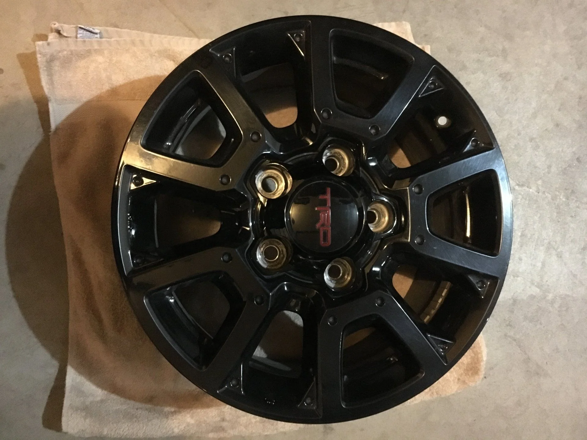

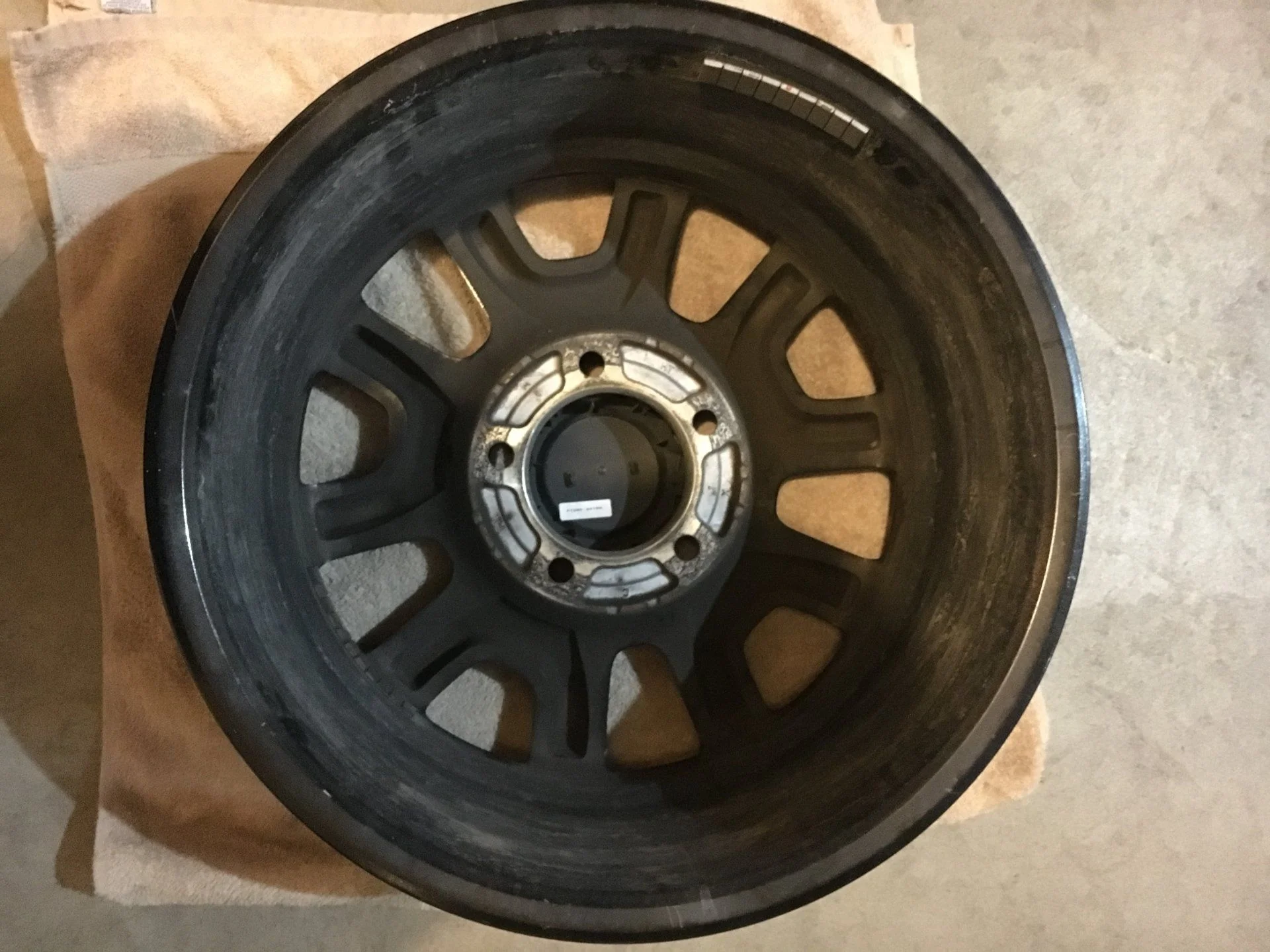

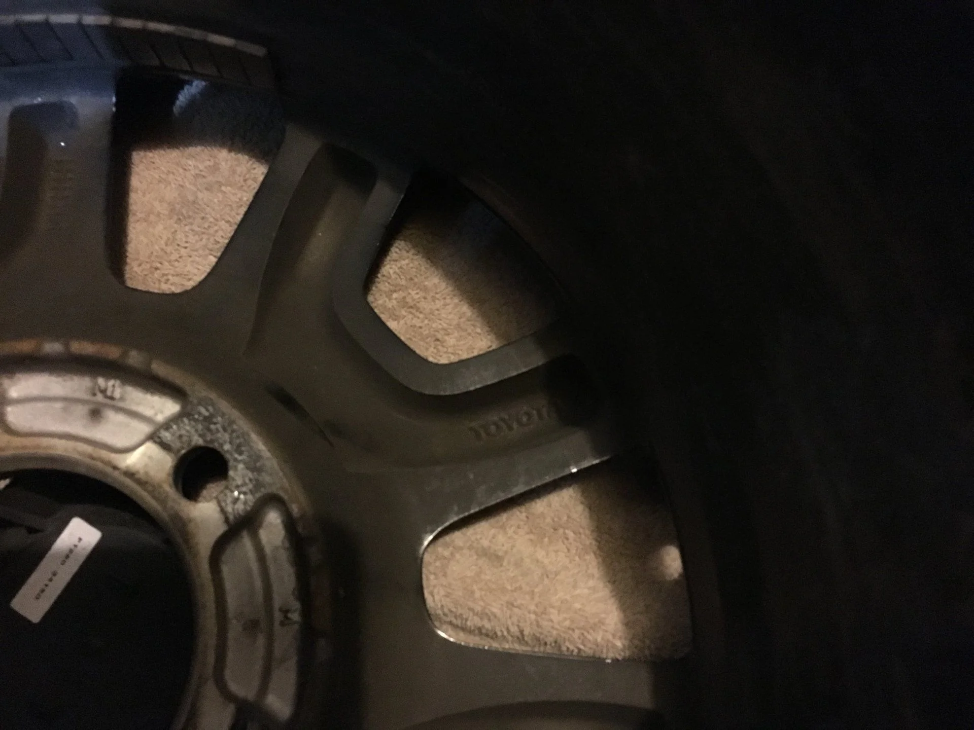

They look exactly like mine, Tundra TRD take-offs from the dealer and did not have painted lug nut surface.

Before I bought the TRD rims from a local-ish seller, I looked into a bunch on eBay. Most of them were the regular bare aluminum version redone (paint or powder coat) in black. The sellers I asked freely admitted this, when asked directly. The ones I got eventually were takeoffs from a Tundra TRD pro (I saw the vehicle they came off), and all have bare metal at the lug mating nut surface.
