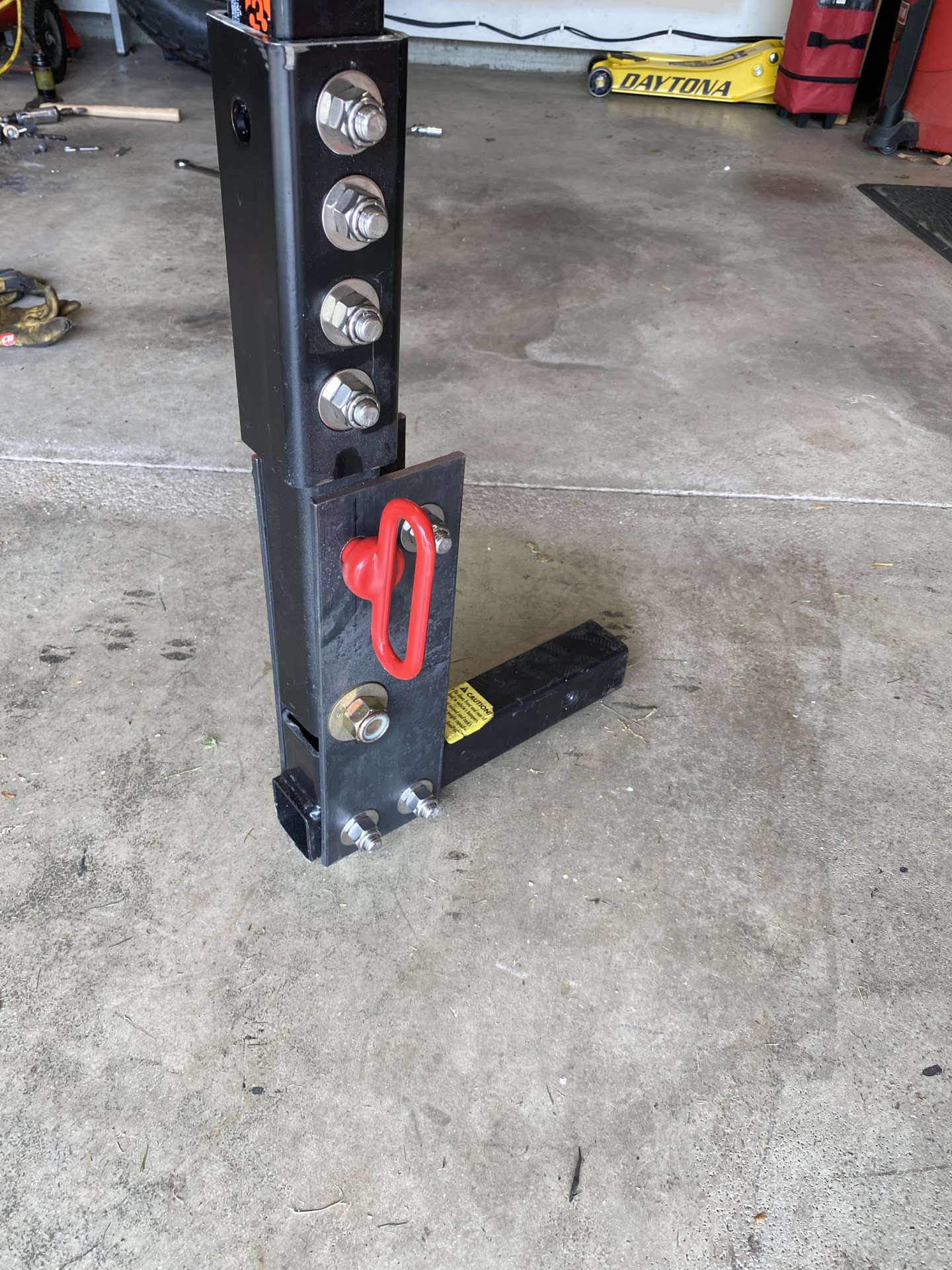

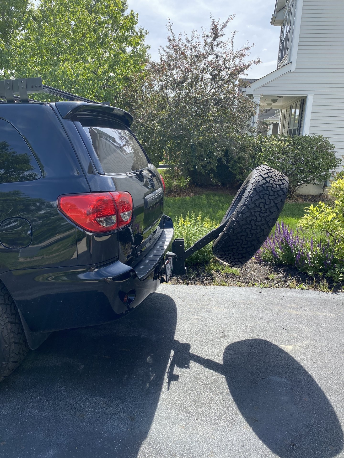

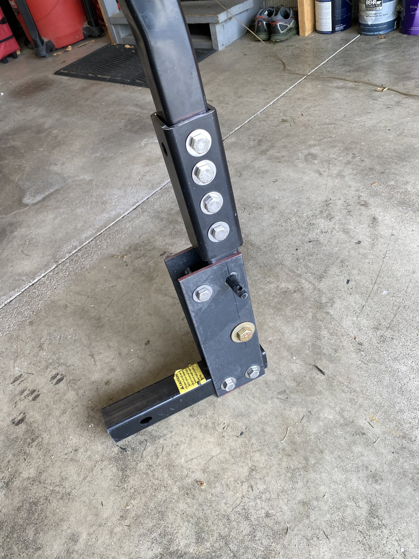

Saw some YouTube videos and decided to do this myself. Cut up a Curt spare tire carrier and used a hitch sleeve and bolts. Ended up having a buddy weld it so it wasn’t so loose. Came out pretty good!

If you can weld, you coukd weld up your own Curt type mount with 2x2 tubing and a metal plate to mount the wheel spacer to.
I used this from Harbor Freight
I used the actual hitch piece from an old bike carrier but you could use the piece you cut off from the Curt one. And I had some extra 2”x2” tubing I used fit the bottom half of my carrier.

My bolts holding it together are 1/2” stainless and the pivot bolt is a 5/8” Grade 8. I put some thin nylon washers between the plates and bar where the 5/8” bolt is to help it rotate smoothly.
