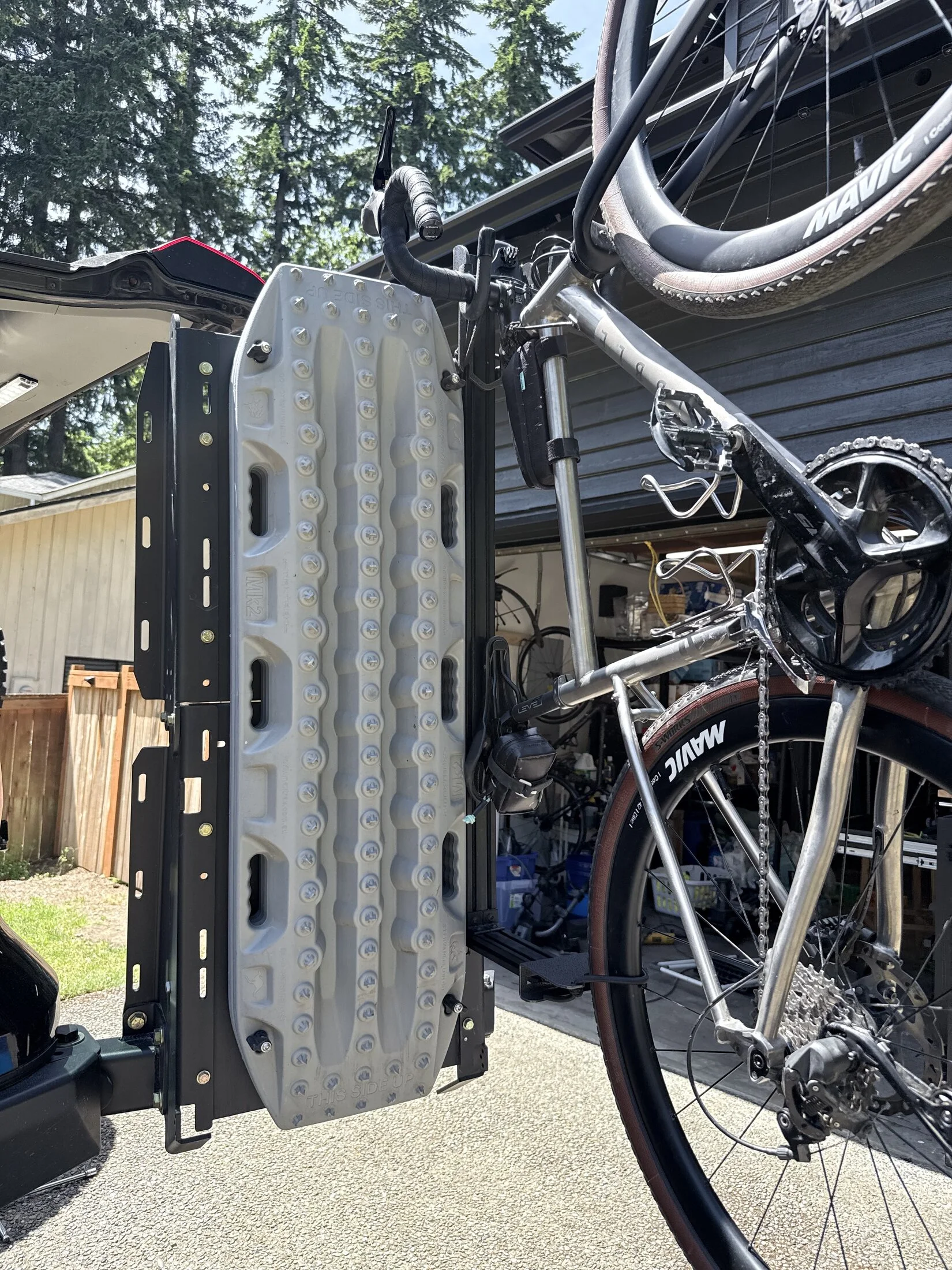

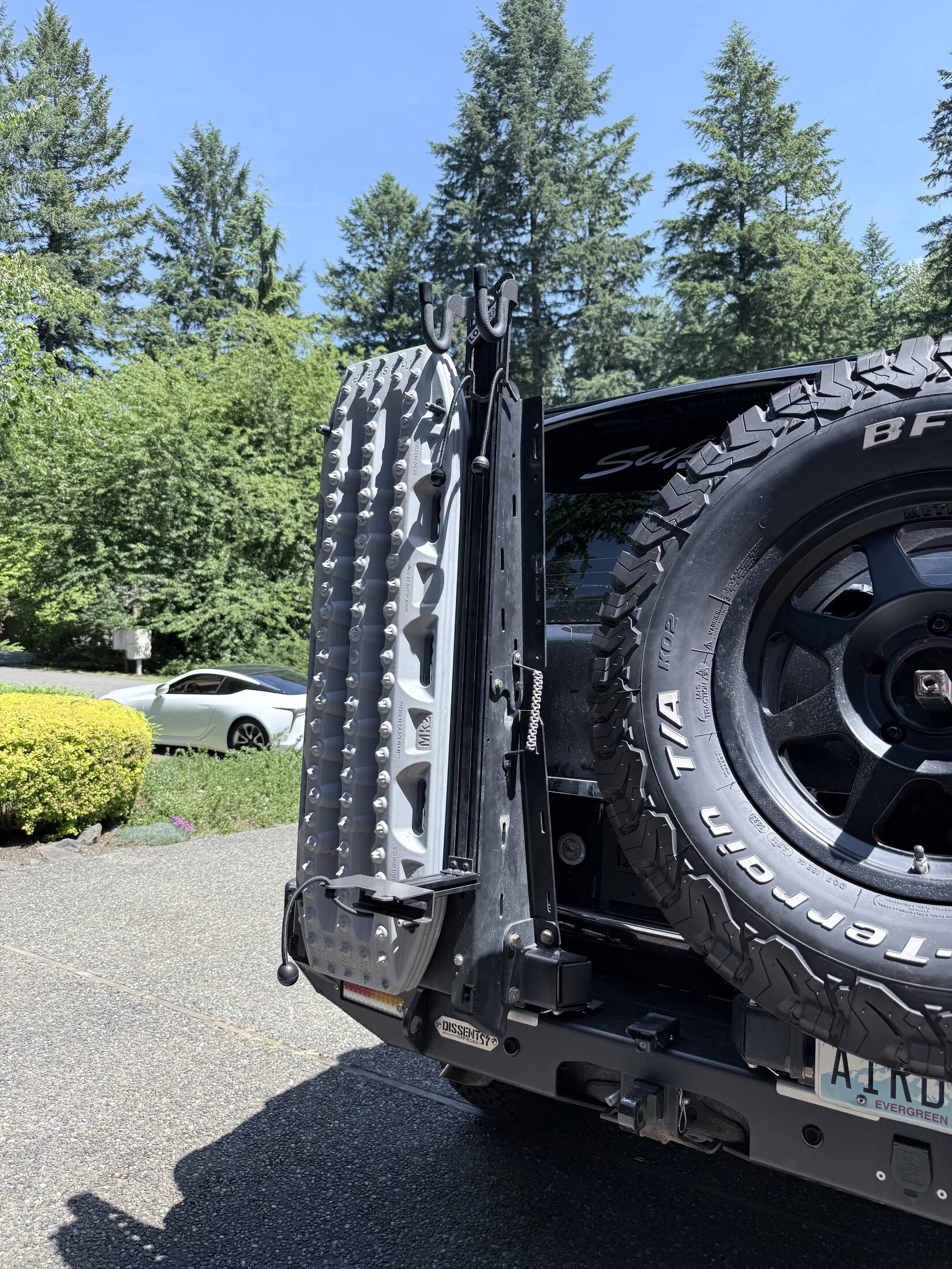

Use an extruded aluminum bar to flat mount to the panel, and then mount the lolo parts to that.
I’ll skip to the end but after a bunch of fiddling, I have something really solid that is great for a single bike and will work with any frame:
To keep it solid and free of excess twist, I bolted the rail directly through the accessory panel and frame using 1/4 20 carriage bolts. I simple removed the existing panel bolts and went right through.
It’s really solid. Went for a long bumpy drive and didn’t see any excess sway.

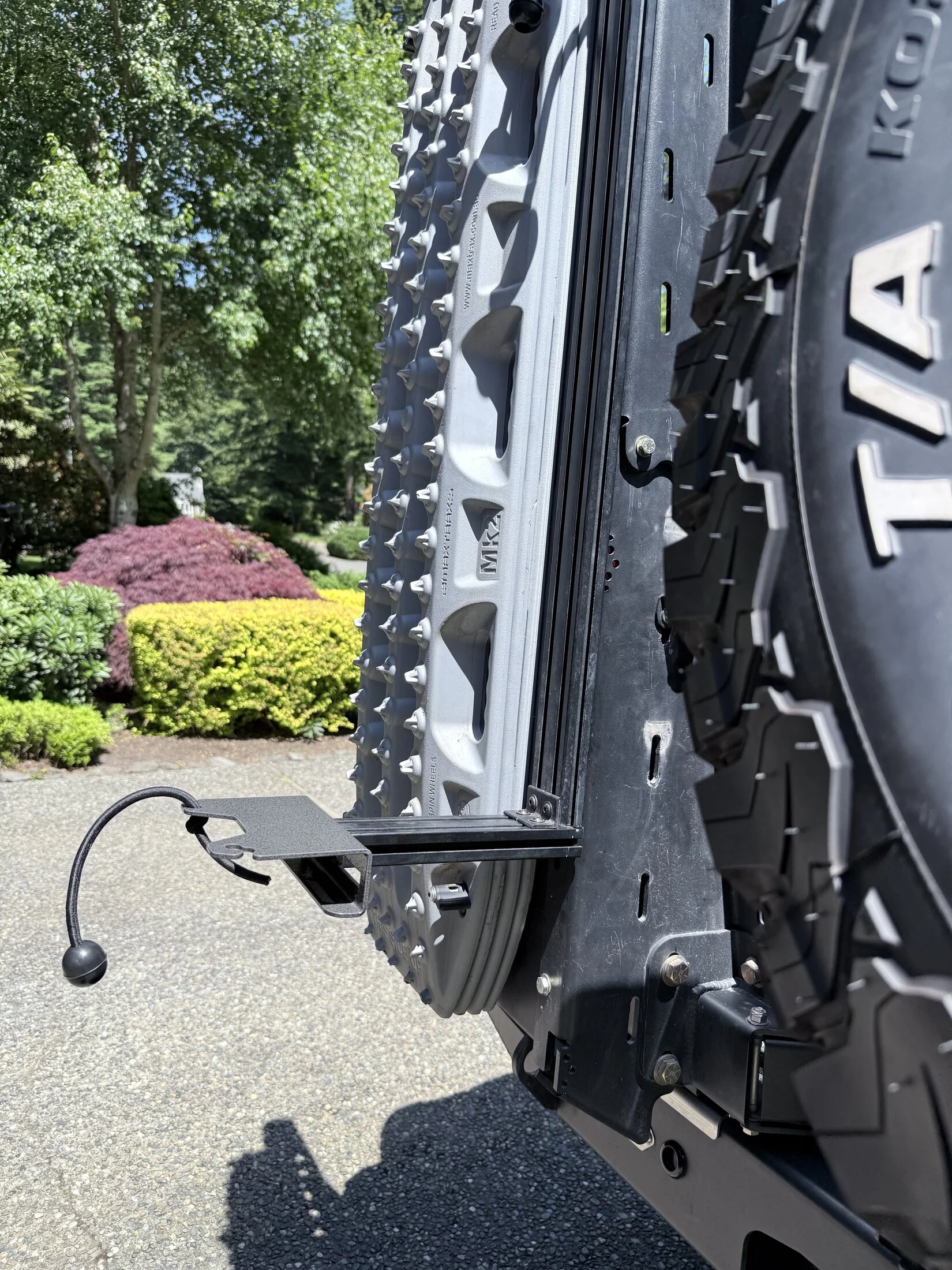

  • attach the foot that holds the rear wheel rest with a locking hinge that slots into the 8020 rail. This will allow me to fold it up out of the way when I’m not hauling a bike.

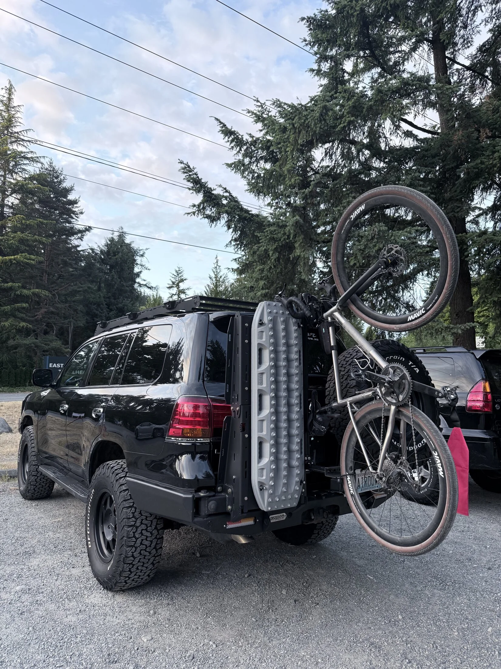

Looks great! My only concern would be the extremely small width of the bike, I can see someone running into that at a red light or stop sign.
Otherwise, very impressive and add a new trick to the skill set of the versatile dissent bumper.
Yeah I’m thinking about maybe a flag I can strap to the wheel or something.

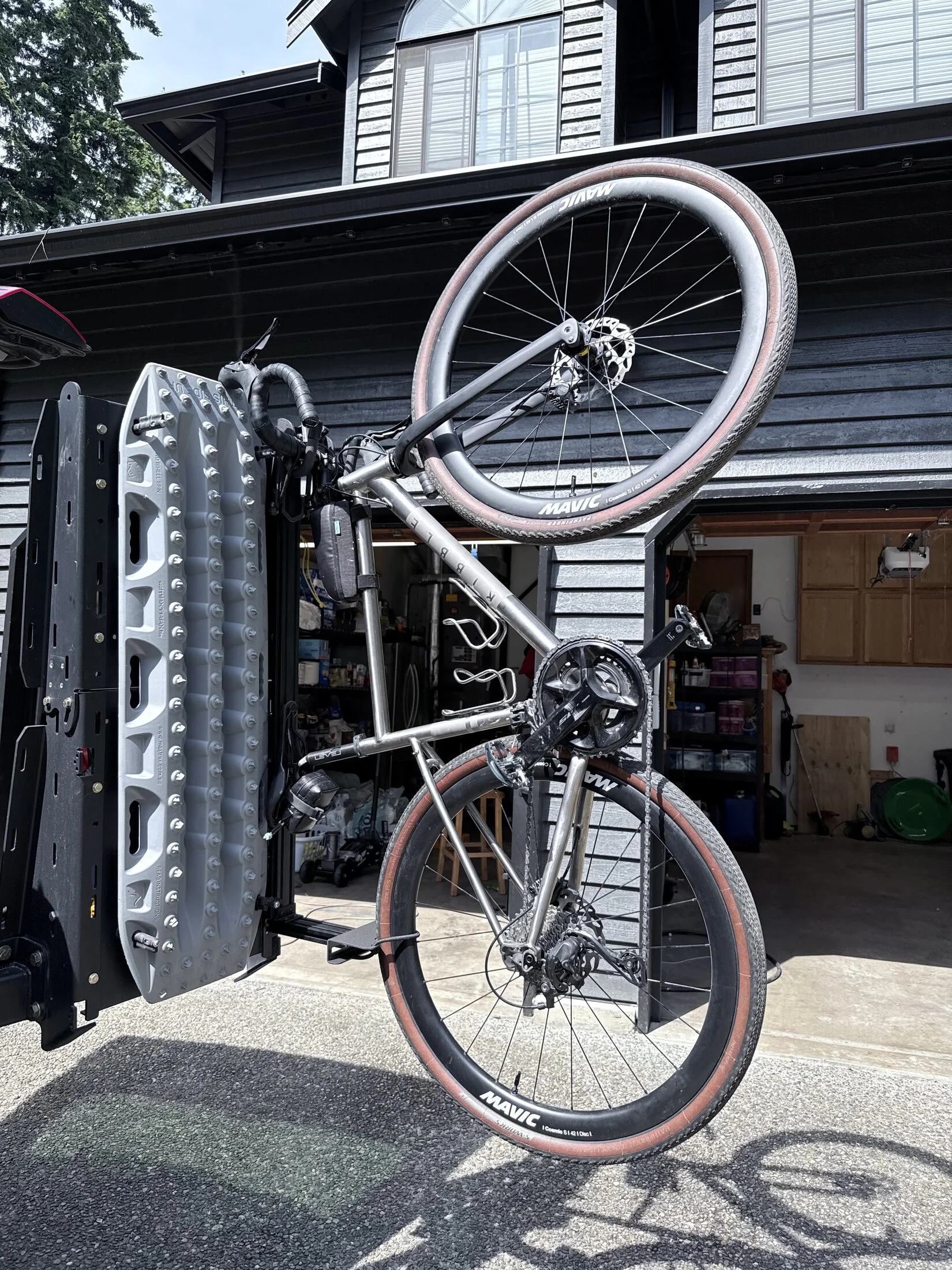

I've been using this thing for a couple of weeks and it's pretty friggen perfect for my needs. I've made a couple of adjustments:
  • Simplified / standardized all the hardware. I can take the rack off in 5 minutes if I need to.
  • I added a slick locking hinge that allows me to stow the foot in an upright position when not in use.
  • I added a kayak flag 🚩 for safety
  • Clocked the handlebar mount to 9 o'clock position which allows me to drape the drop bars over the maxtrax. It makes fit super tidy and eliminates almost all of the sway.
Here it is in it's lowest position. If I need to, I can slide the whole mount up about 10" so the rear wheel is up high.
