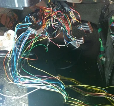

Aem f/ic 8 install
Ayyyyy Carramba....
It's never enough with tuners. LOL. Exactly how I am, start with a small idea, the next thing you know you have built the Pyramids. Great work. But, is this still a low budget turbo build???
Well, it's done right, in many ways, with the cheapest parts that I could find.
If you look at the price list there is a lot of stuff on there that is high quality and relatively cheap - as long as you hunt down the deals.
Nice choice on the AEM FIC 8. It is the same unit we will be using for our plug'n'play kit.

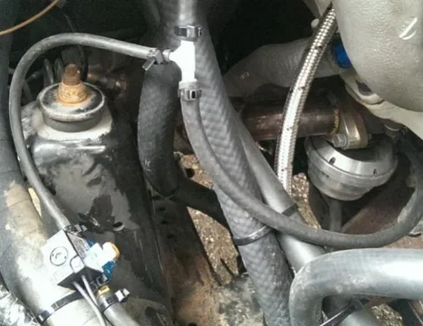

That was the port for the valve cover vent hose. If you go turbo you move that port to the pre turbo pipe or with a catch can setup.
So you either have to cap it off or put a plug in it post turbo.
Almost perfect 3/8 size too. Just run a tap through and it's good to go.
