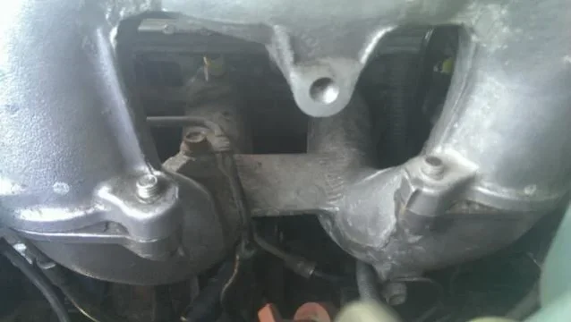

Here are some emission delete pictures.
Wow. What a change.
