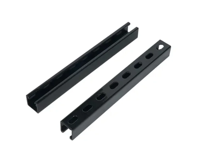

I want to be able to use channel strut (aka Super Strut or Unistrut) with the stock roof rack rails.
This stuff:

So one problem to consider is interface to the factory roof rails: somewhere along the way you have to adapt a curved rail to a flat plane. How do you securely and aesthetically join the two?
Has anyone seen this done successfully, with great fit and finish? My goal is a mostly DIY 3 or 4 crossbar, factory rail-installed system, perfectly flat, for under $300.
