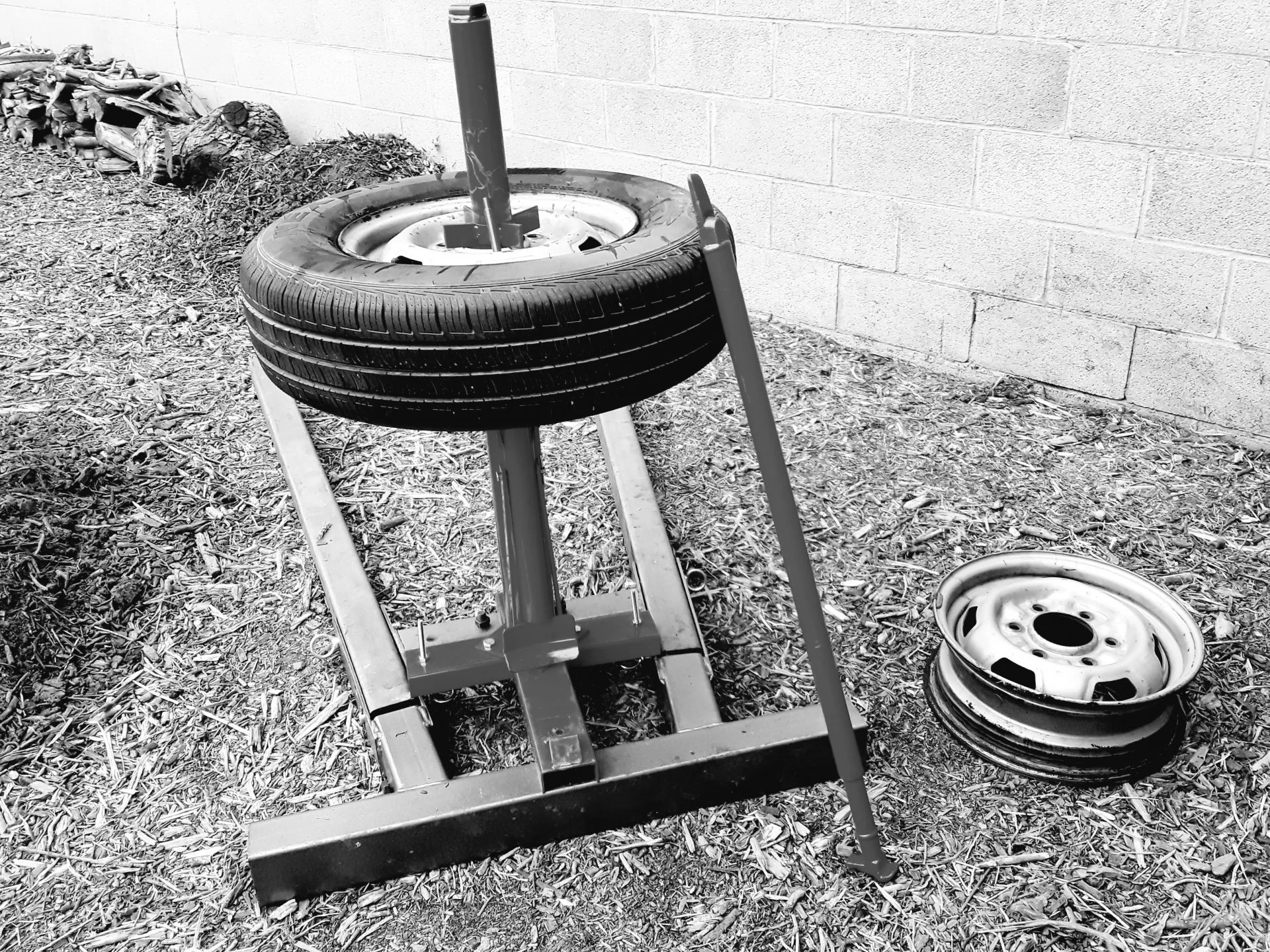

I must have spent an hour or more to just determine how to mount the tire changer without concrete anchors. I finally figured that I would use my HF engine crane base. I ran to the hardware store to get some 3/8" eye-bolts, they are held by the eye of the outside leg hitch pin. I thought that I was going to weld pipes in for U-bolts, but it wasn't necessary.
So, I was able to remove my 720 spare from a good wheel (gonna paint it), to a (practice) junkyard wheel that has minor blow-out damage (wish I would have known that before I bought it, oh, well, I made an extra 150 miles for another wheel and harvested a spare/trail starter too). The whole tire mounting process was super easy. The directions didn't mention removing the spring weights before starting, oops, lost some paint on that one. Now, on to tire shopping, finding plugs for the inside and figuring out balancing. I'm thinking Hankook Kinergy ST 195/75R14, harvesting a bunch of steel-rim weights from the local scrap yard, and fabbing a tool for weight removal.
