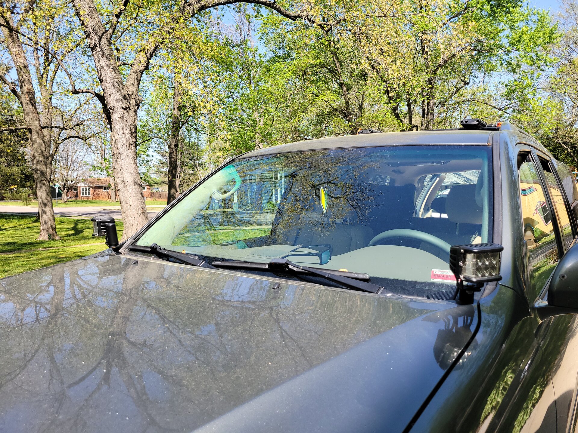

You don't really need the hooded light, you can just turn the lights themselves on the brackets. Mine are shown below.
For the wiring, you can't run them directly off the high-beam circuit as they'd draw too much current. You need to have relay(s) that provides power to the lights based on either you pushing a switch (a non high-beam triggered setup, using a single relay) or pushing a switch that is only activated when the high beams are on (a triggered setup using two relays). The latter is my setup; my switch does nothing when the high beams are not activated. When the high beams are activated I can turn the lights on of off, if the ditch lights are on, turning the high beams off will automatically turn the lights off.

When using mine angled, they help a lot on rural roads at 60-70 mph, by illuminating the ditch/roadside area that is otherwise pretty dark and usually harbors critters.
If you were mount the lights forward-facing on the ditch light bracket (instead of angling them) you will probably get some hood glare and they probably won't do as good of a job of illuminating the ditch/roadside area. You can also tweak the angle to fill in light gaps as needed.
