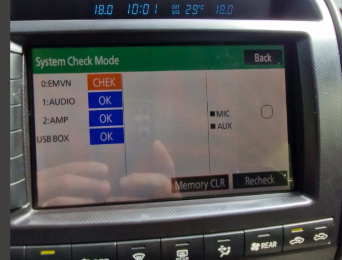

I barely managed to get to the system check mode screen and got the following:
As you can see on the vid below the touchscreen check is all over the place: Touchscreen Check VDJ200
Any ideas as to how to calibrate?
